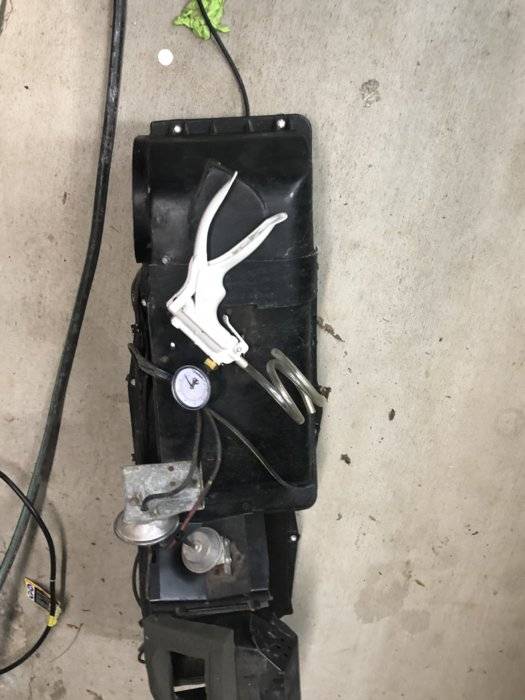

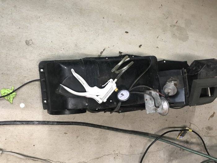

I have an entire box. I rebuilt before I swapped it all out. I checked the vacuum solenoids they worked then I can check them again this weekend with my pump I’d be willing to sell the complete suitcase has new heater core and pressure checked Evap. The thing takes up valuable room lmk if you’re interested.

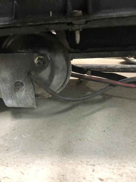

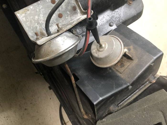

If you’re interested, I just checked all mine on the suitcase I rebuilt. All work and hold a vacuum. Can remove them and ship if you need to go used and don’t want the assembly?
