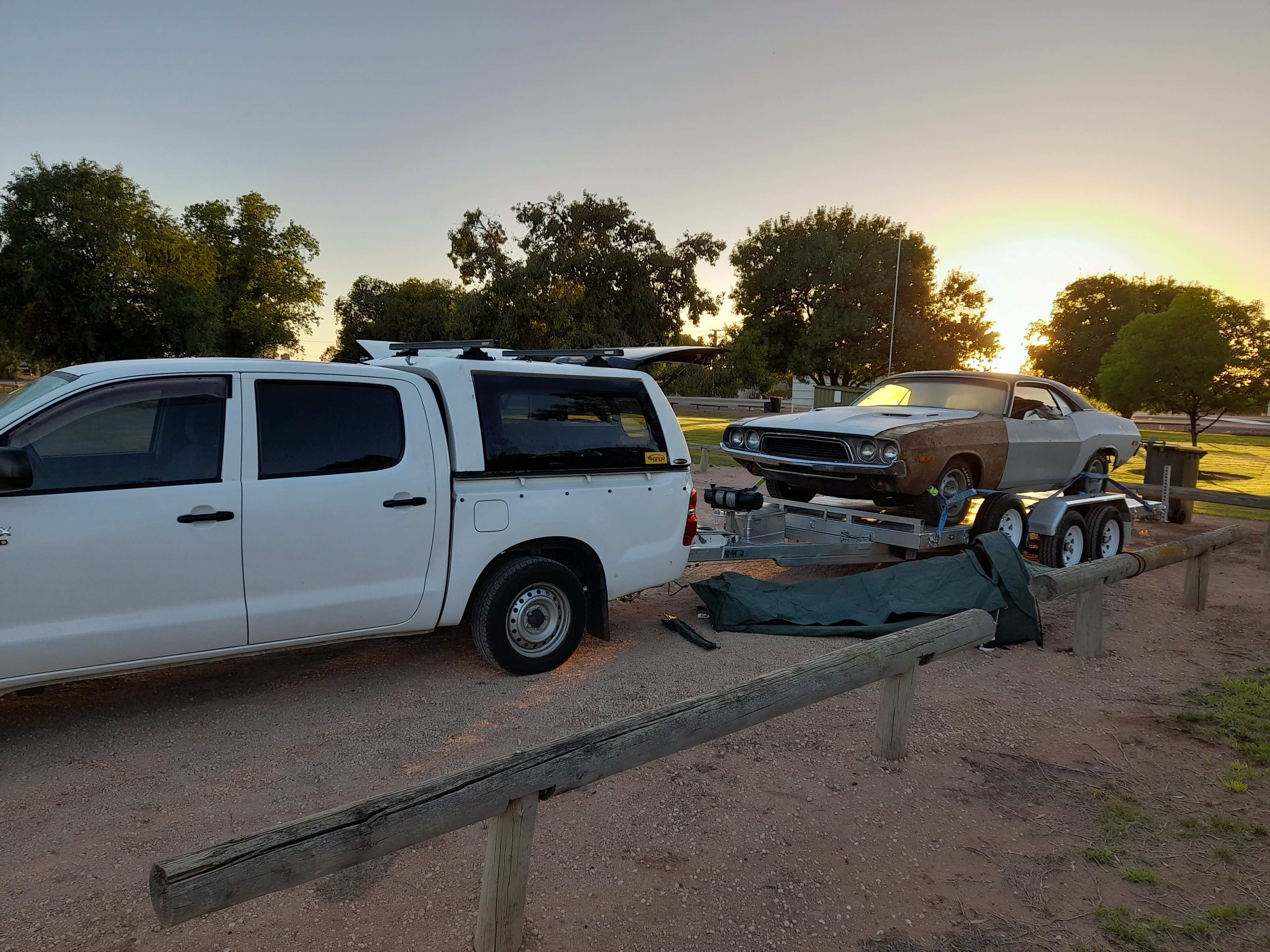

I actually bought the car sight unseen, then drove it with my dad across Australia (3600kms) to perth over a week! My old man is pretty old so the car is already making memories! It was a great trip!

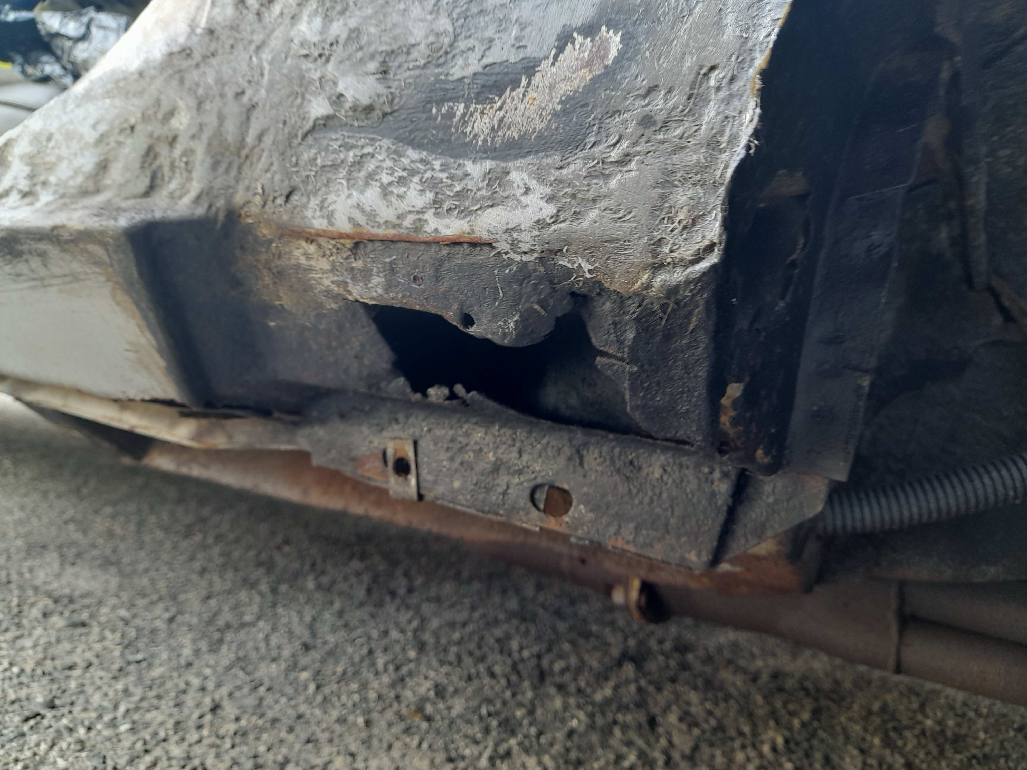

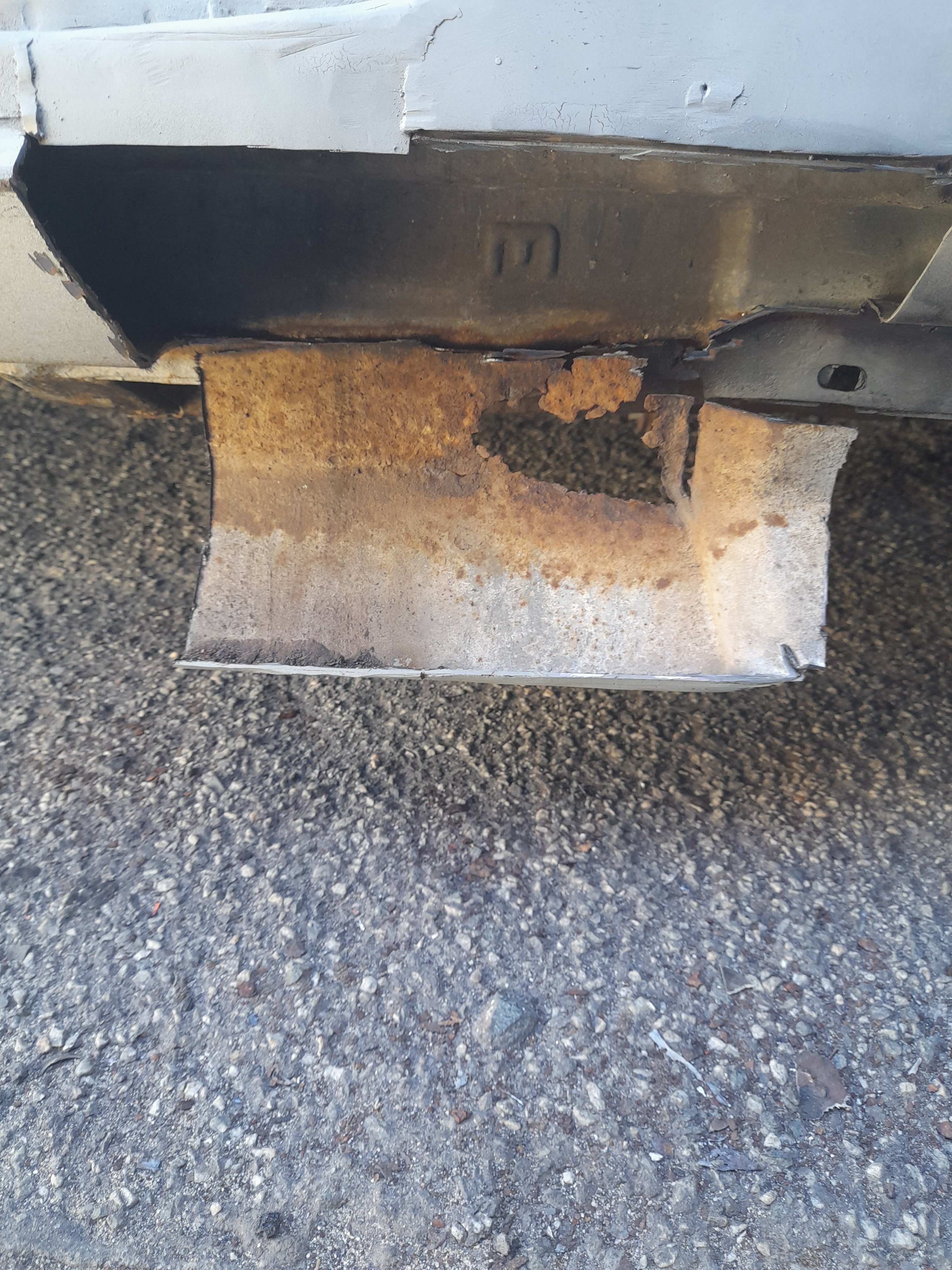

After that it's into the job I have been avoiding. Rear frame rails. I have AMD replacements for both but I'm trying to avoid removing the rear trunk sheet metal.. I'm thinking if I drill the spot welds out from the top, then cut the frame rails where then need replacing... I might get away with it!

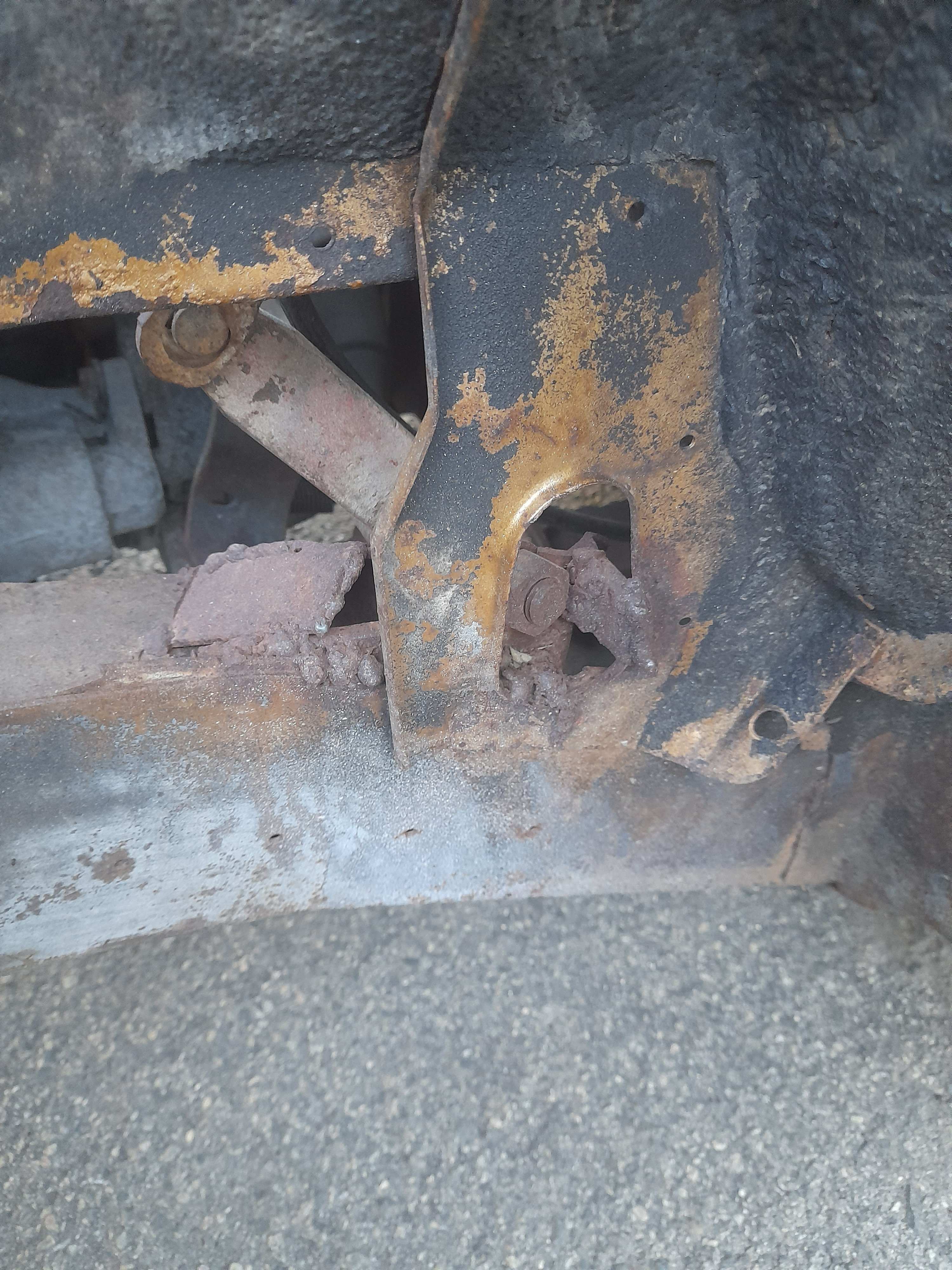

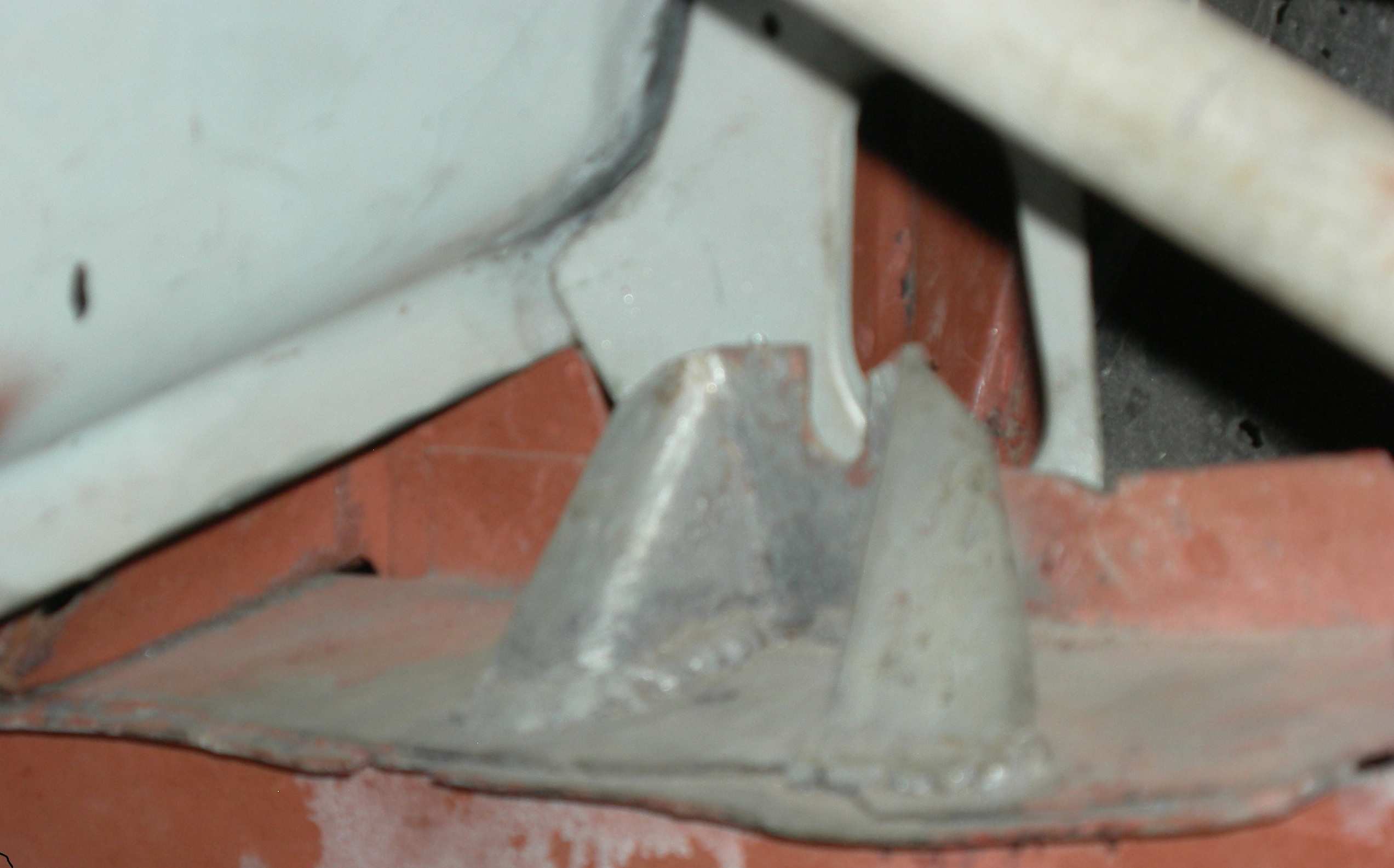

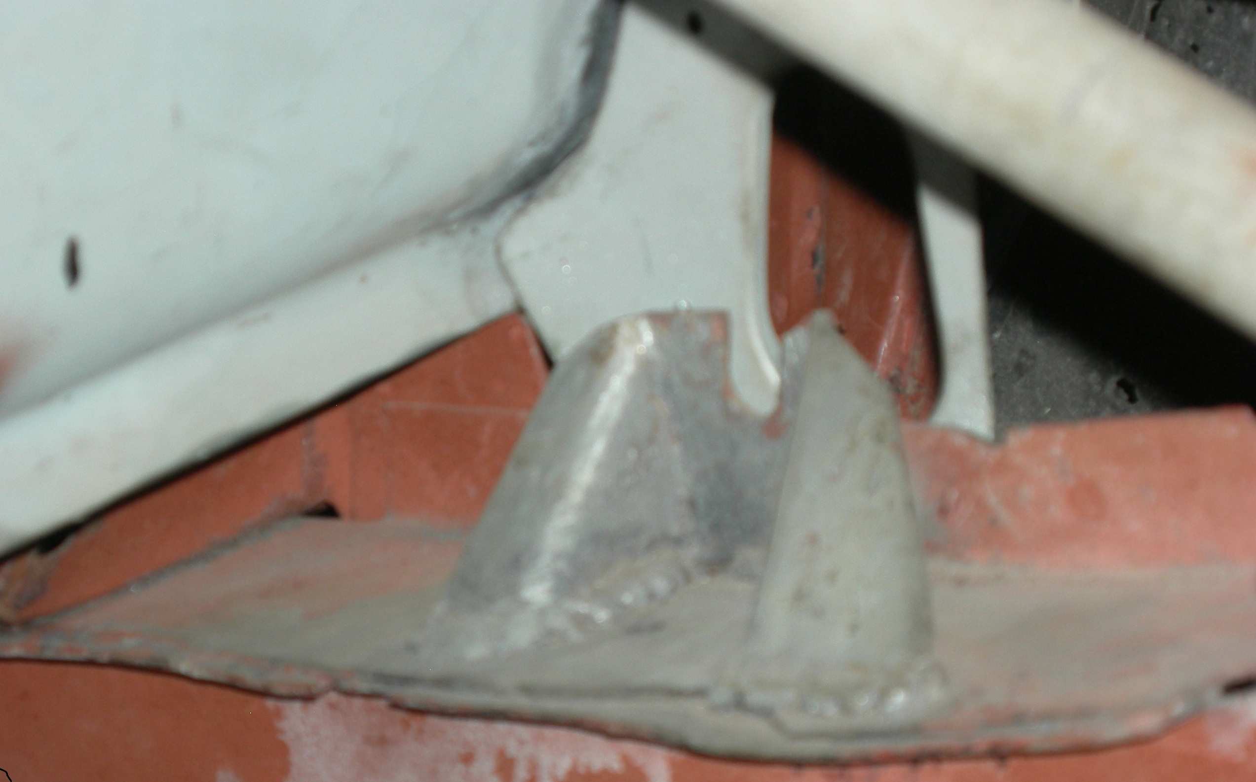

Does anyone have any photos of what this shift mount area is supposed to look like? Someone had a really fun time welding here....

Much appreciated!!! Thank you! Got a rebuild kit ordered its a mess in there! I don't want to pull the engine so much cut an access hole in the panel holding it so that I can get at refurbishing the z bar then weld it all back in!
This is how I would approach the situation. I would remove the steering column if need be and brake lines. From the interior drill the 2 or 3 spot welds on the brace. Then on the frame do the same on the bottom and top. Fold the brace up and out of the way to give you more room. I would them trim away with a brazing tip and grinder with a wafer wheel. Or what ever tools you might have or get. That would all be cosmetic and coved when done.

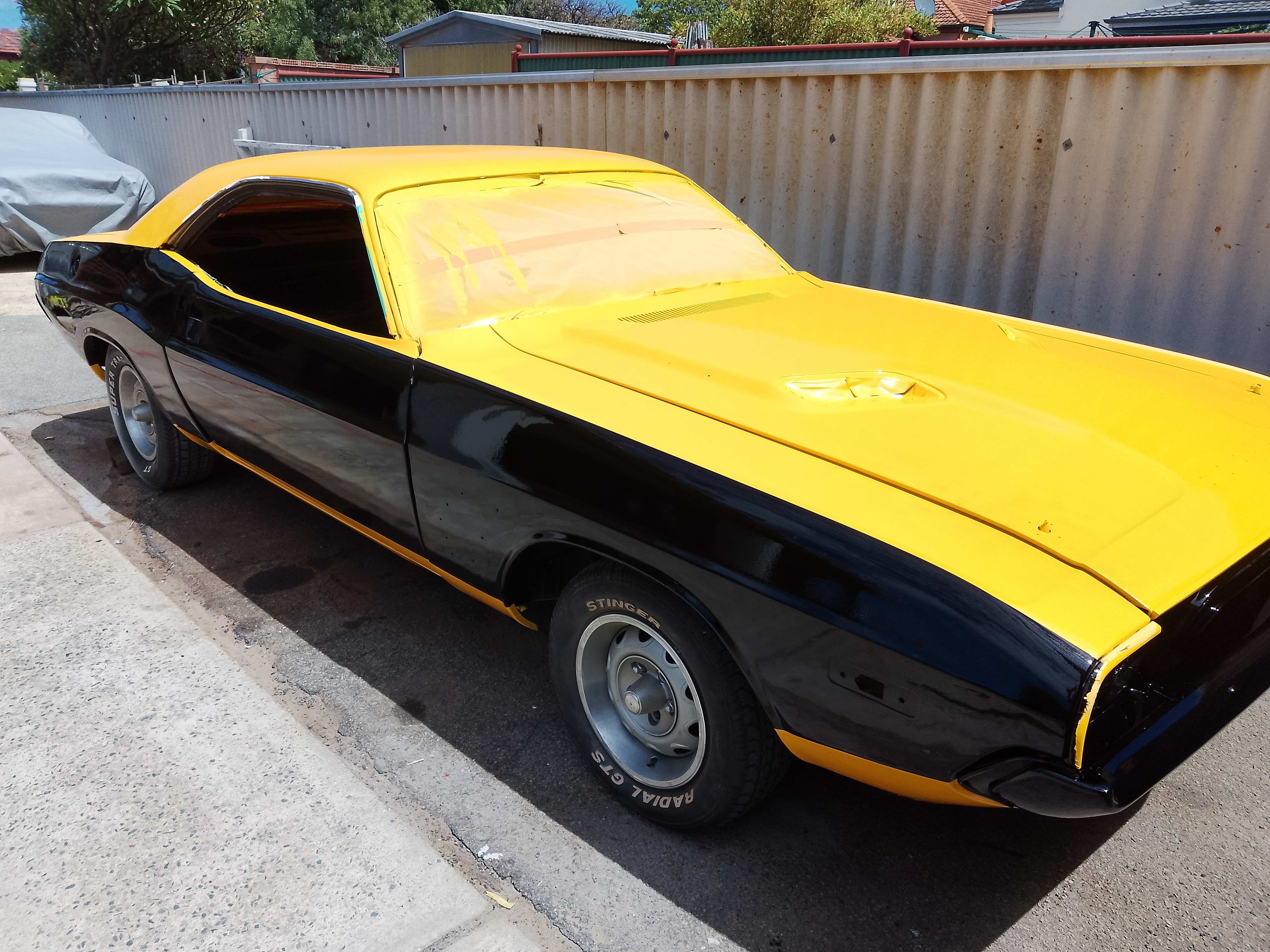

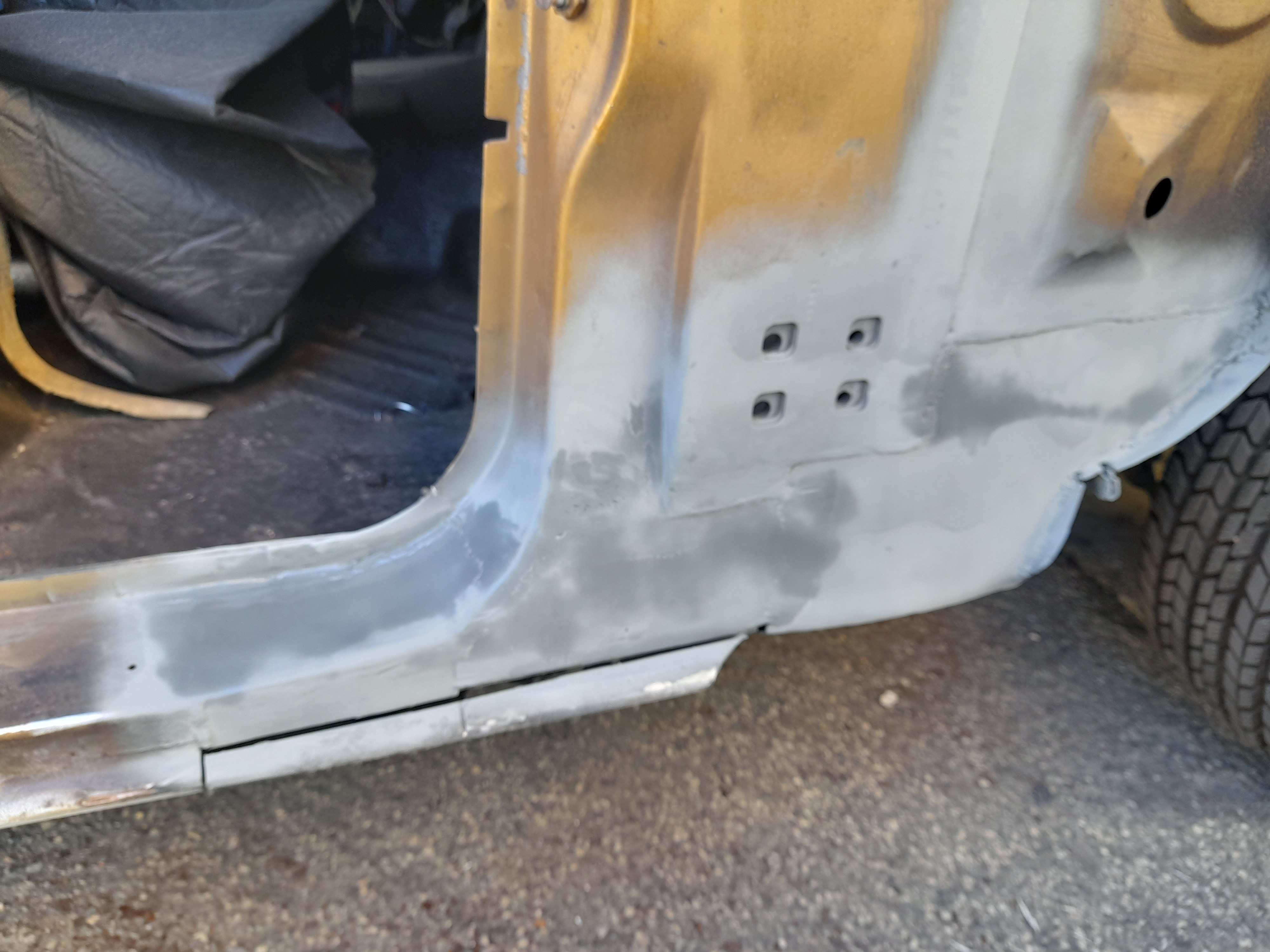

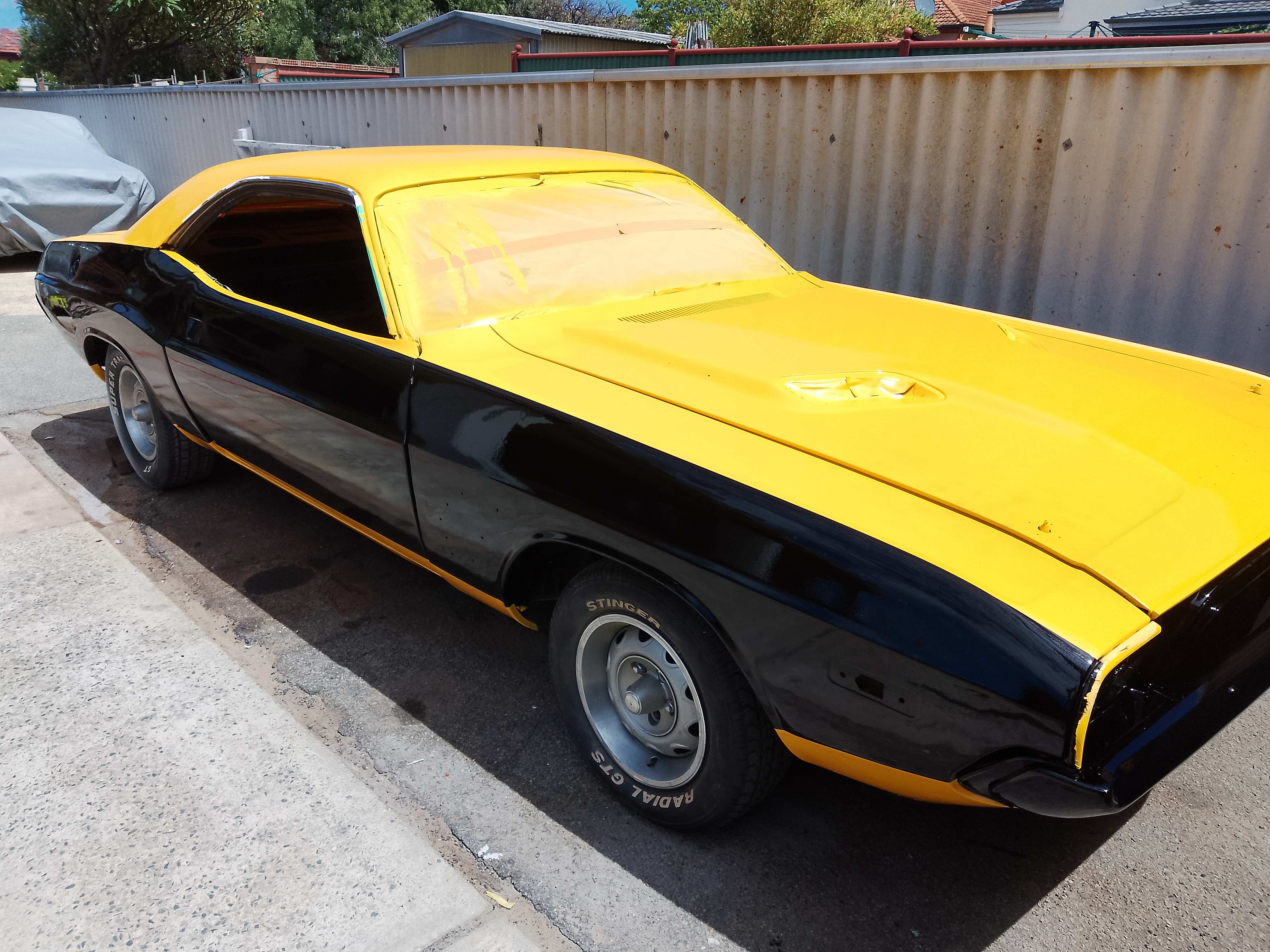

Bit of an update. Really got into it over the Christmas break and did a few patch panels in the trunk. Fitted two new rear quarters, and welded up some rust in the rockers also. Now onto paint. I decided to deviated away from tradition and go a yellow/black combination.

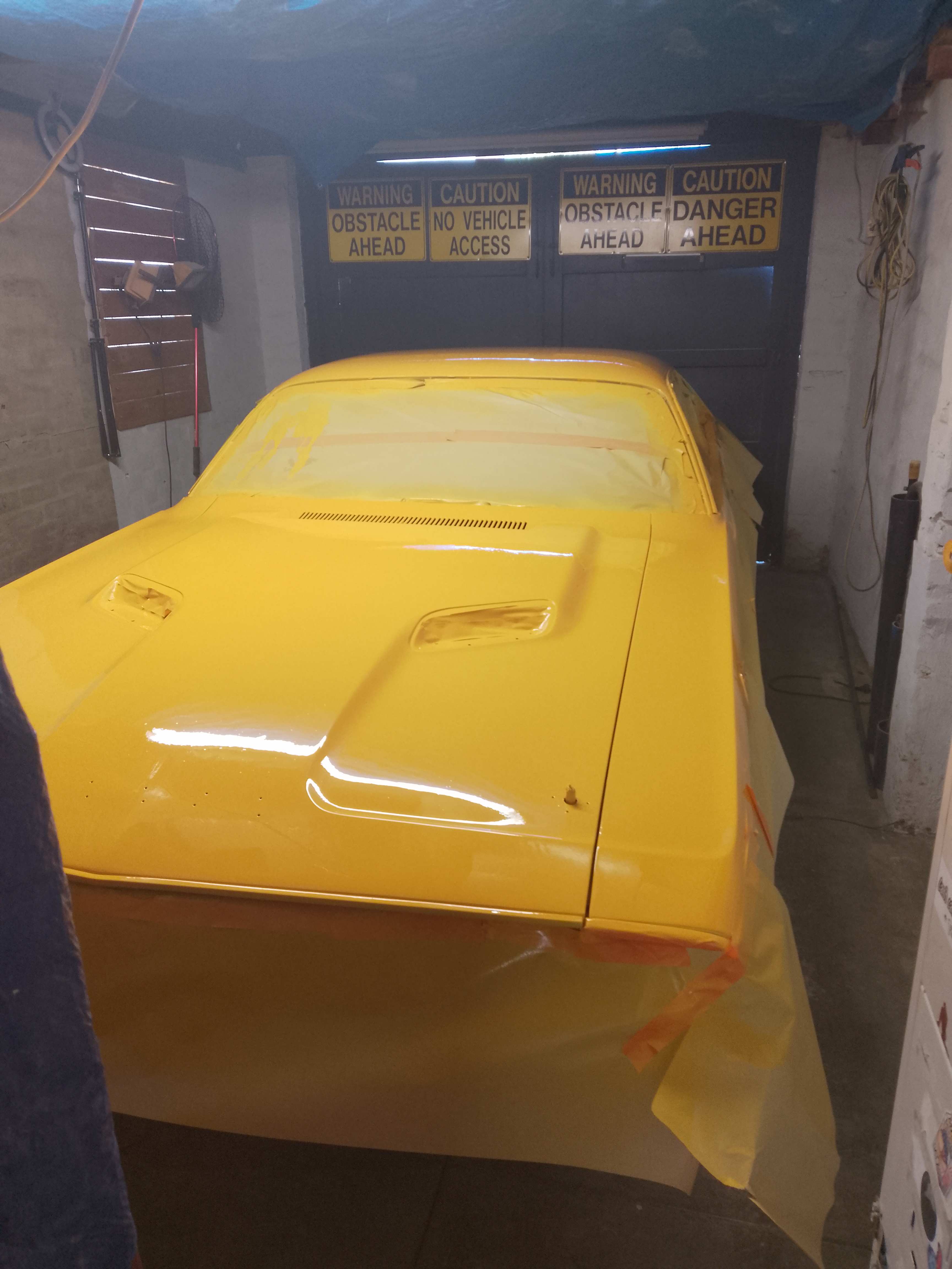

Paint came out pretty good for my first go. I'm really quite happy with it regardless to be honest because I have taken this car from what it was all the way to something with my own hands. Other than advice from here, its all been me slaving away in a tiny shed or outside getting it done. So I'm proud of it ..even it's imperfections

A major milestone done and looking good!
