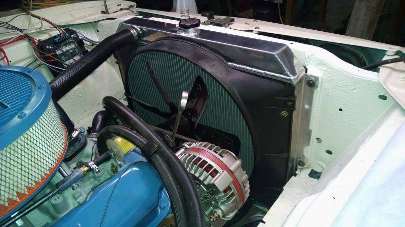

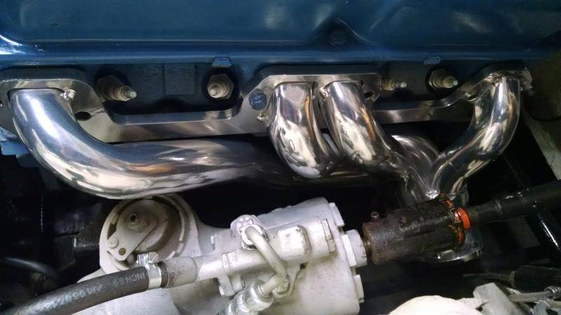

Thanks for the advise guys. If you note earlier in my post for this thread you will see that I wound up going with the Lizard skin system (about two years ago). Received my TTi shorty's today. They fit awesome without needing to jack the car up or remove the starter. I wound up going with the ceramic coated polished. 001.jpg004.jpg

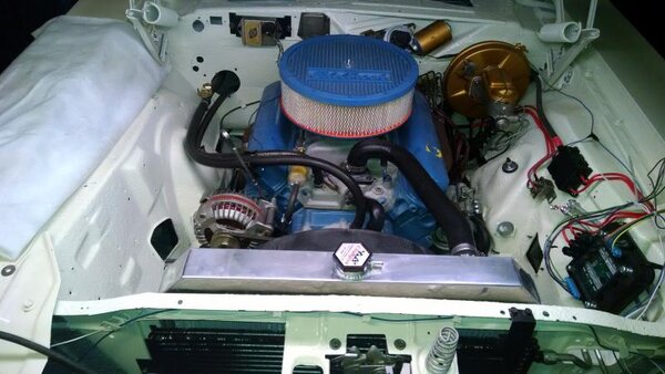

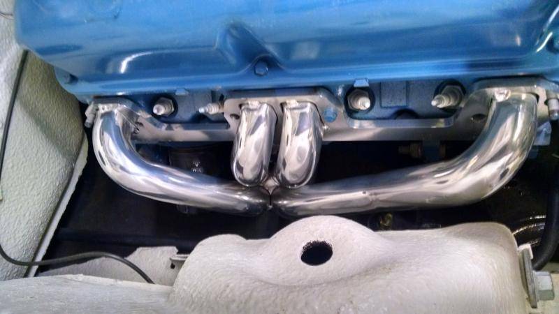

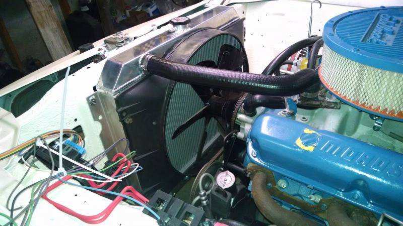

003.jpg005.jpg007.jpgInstalled new radiator and new KYB gas adjust shocks.
