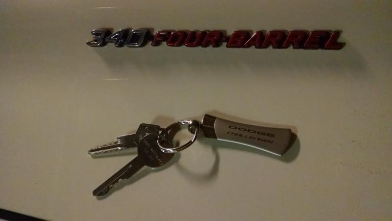

Local hardware store actually had the old Chrysler pentistar ignition and round trunk keys in stock. They had a lot of dust on them but they were able to make an extra set of keys for me for $5.00. Latest picture of my Challenger. I was at a car show today and there was this shortened and chopped Cuda with an aluminum HEMI. 022.jpg003.jpg

Cool find on the keys. Did you throw caution to the wind and just toss them onto the hood by the emblems for the pic?
LOL...

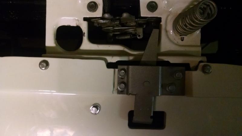

332.jpgWas wondering if someone can tell me what I may be missing with this hood release lever. This lever gets mounted to the fiberglass header grille but does nothing as far as unlatching the hood. I'm pretty sure I must be missing something. My mechanic said I need to be able to open the hood with a lever of some sort (along with a few other things) in order to get an inspection sticker put on.

Looks like you have the inside hood release latch. It doesn't connect to the lever. If you have the cable and parts hooked up and working you can do away with the lever.

Thanks for the info. It's hard sometime because I am not the one that took the car apart. I do have the cable that goes inside but I will need to purchase a new one as the casing of the cable is broken in two. Was not sure if I could use the outside latch release lever instead.

You can use the lever if you change the latch. I personally like the inside release. Although without the guard at the latch it is pretty much worthless.

Thanks for the info! I found a nice hood release cable assembly today in my barn off of the 74 parts car I purchased. I used the hole in the firewall for my battery cable from the trunk. I will need to drill another hole for the hood release cable and grommet. I just think it is kind of weird that I have two cable assembly's and a manual external lever. Both cars had the inside release?? Both latches are set up for inside release.

The manual release latch has a piece that extends upwards. This is what the lever pushes against to open. On the cable latch it is omitted and a post is added for the cable eye to loop onto. I currently have the cable on mine that I converted many years ago. But will be converting it back to manual again due to some add-ons getting in the way of cable.
