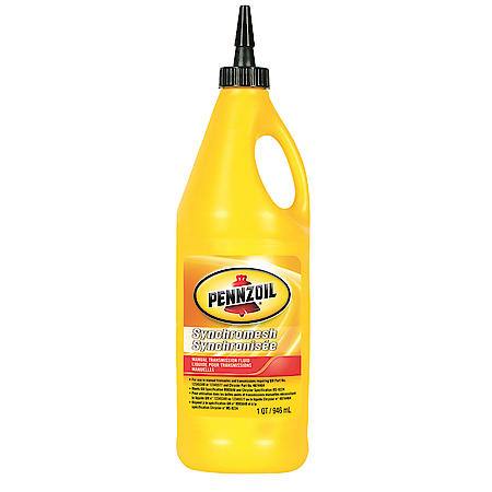

    I use Pennzoil Syncromesh.

    Thanks everyone for your suggestions. I am still at odds over gear oil vs. ATF. Unfortunately, I live in a region where temps can drop below 0 and go as high as 95. Not that I would go cruisin' when it's below freezing, but this selection process of what to use can be both confusing and intimidating with the extreme temps that go on here. So, it becomes concerning when you need to do the right thing for your machine.
    I am thinking of going the "Trial and Error" route (sometimes not the best idea). Meaning, to see if a good 75w-90 syn will work (I hate the rattle - Even with my sad hearing I can still hear it). If not, then look into the Penns or Mobile. If not that, then ATF and let er rattle.
    Sidenote: If it sounds like I am still confused, it's only because I am.
    To add to the confusion with a...
    BTW - The previous owner/builder told me he used syn. What brand, I don't know? I can say it's not as thin as ATF and yet not as thick as syn gear oil and it's "purple" in color (not red) (I don't believe it's "Royal Purple" - I don't know for sure?). This, what ever it was, worked great. Unfortunately, he didn't list it in work sheets and I can't contact him since I lost the number.
