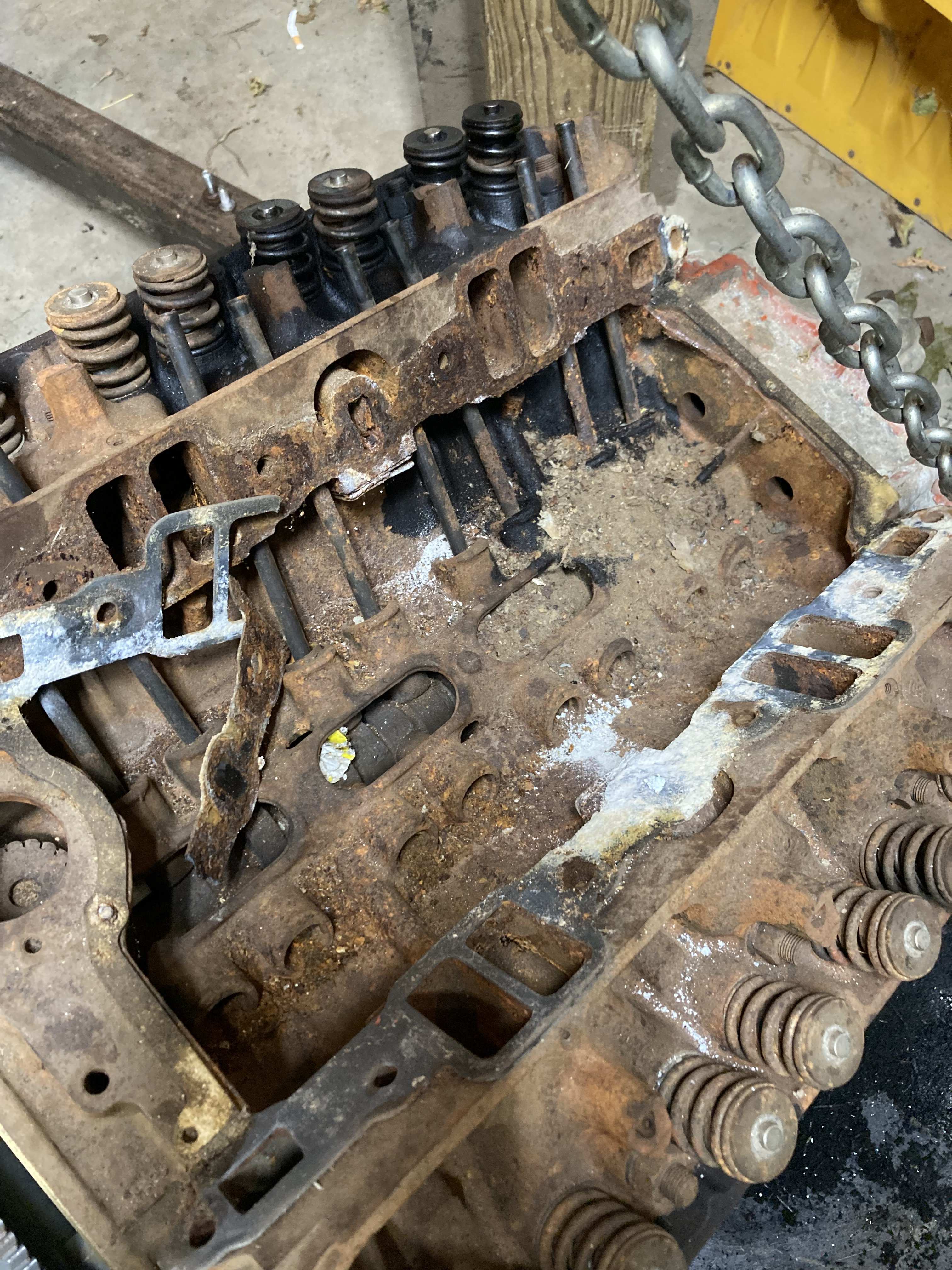

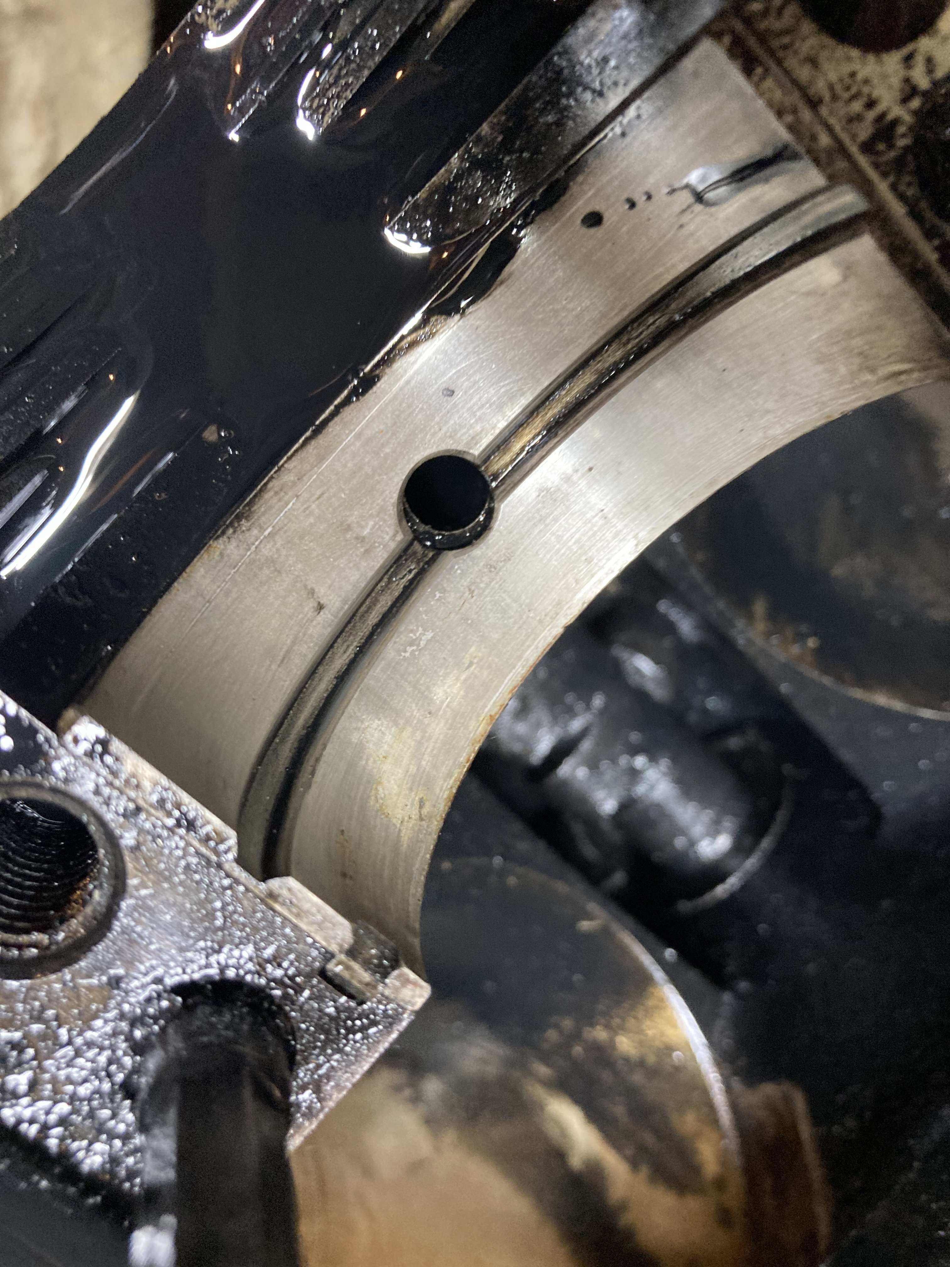

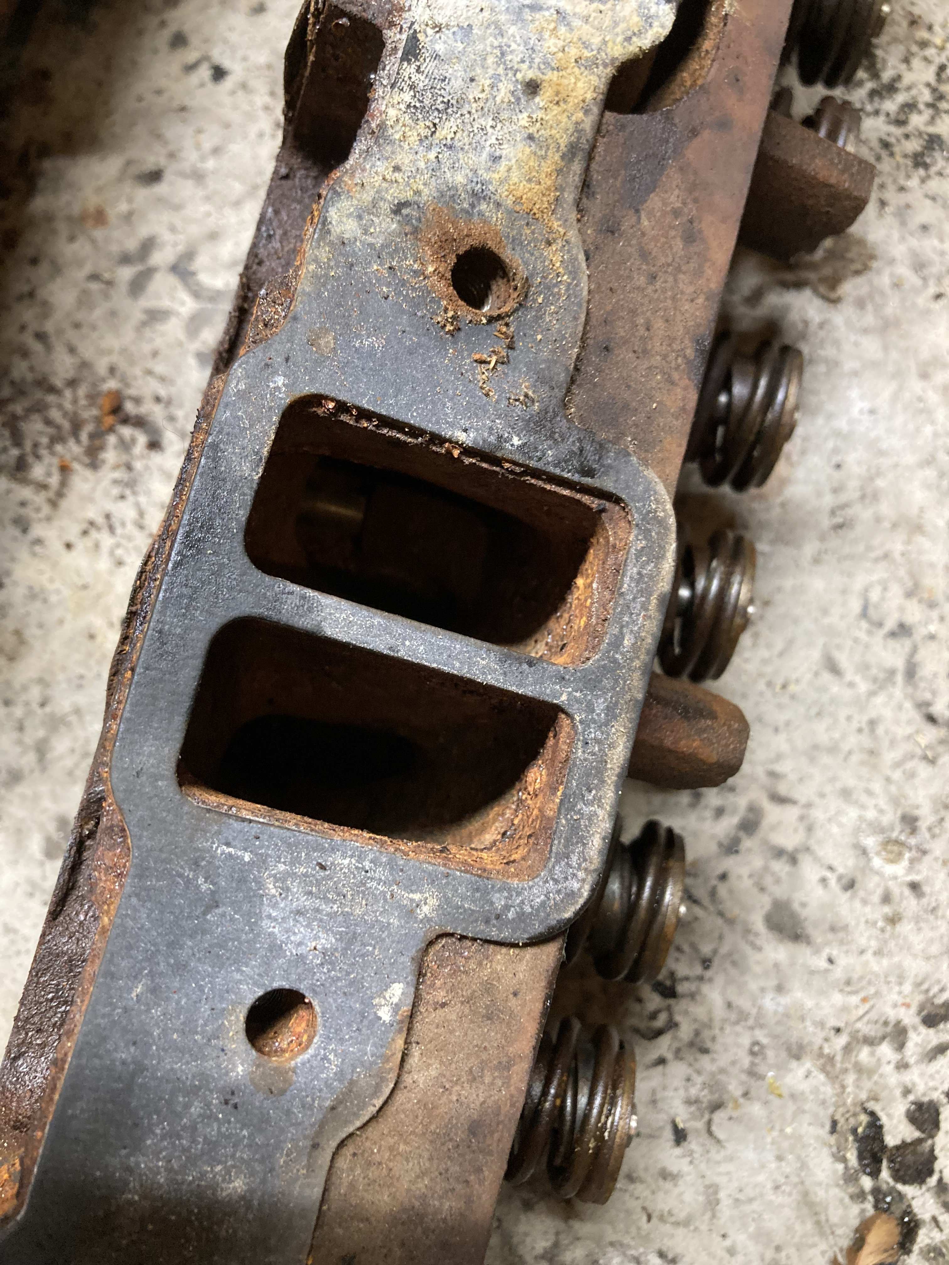

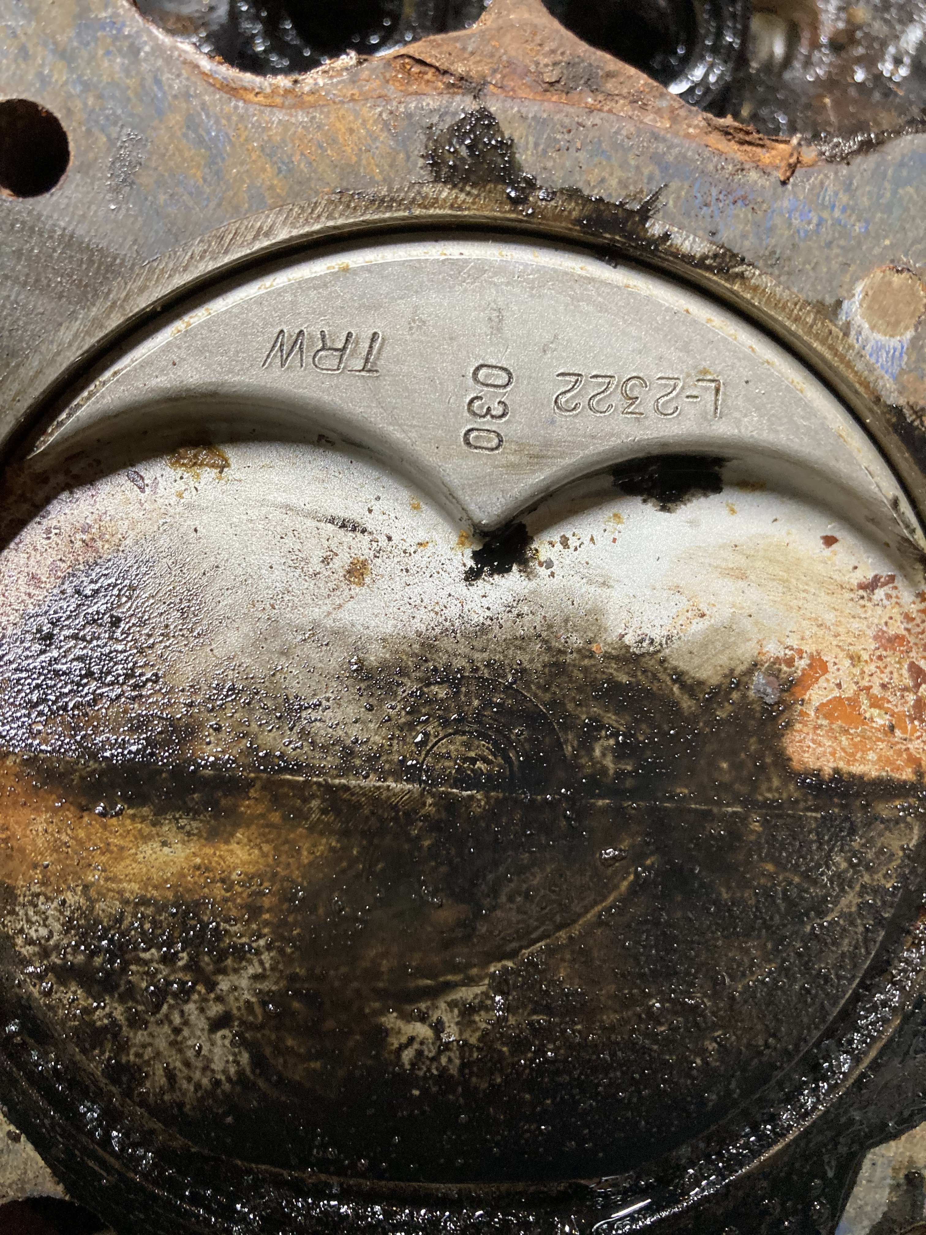

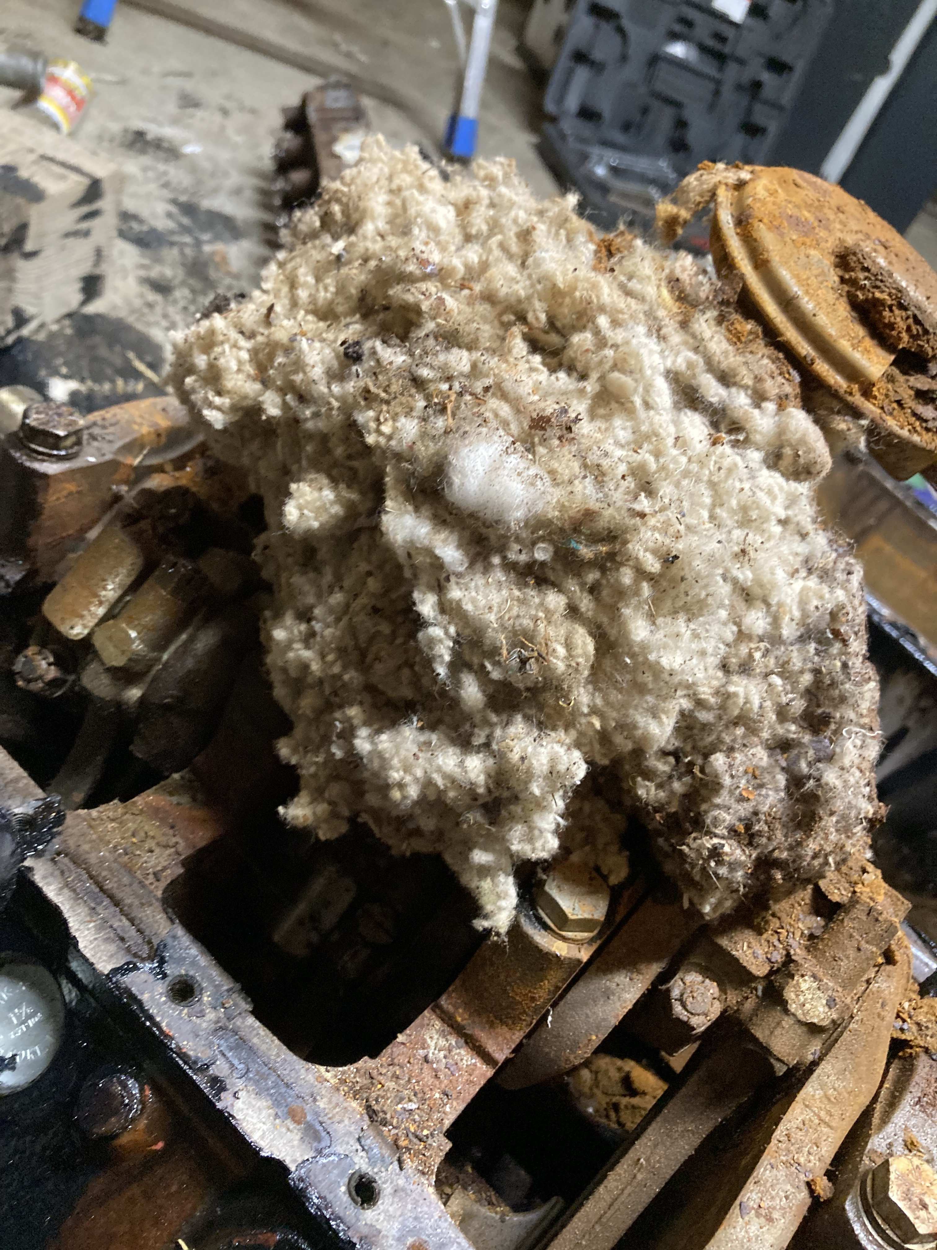

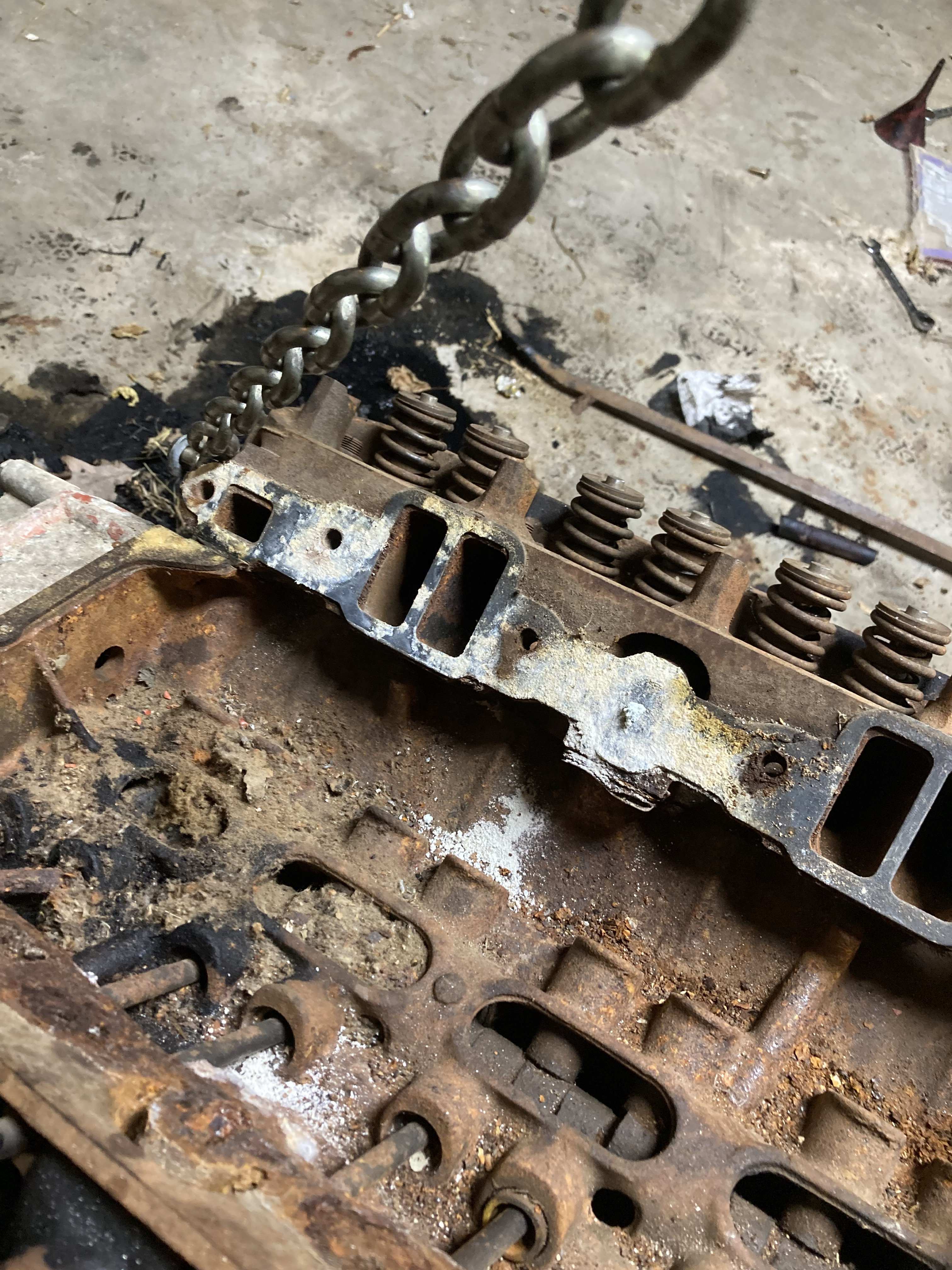

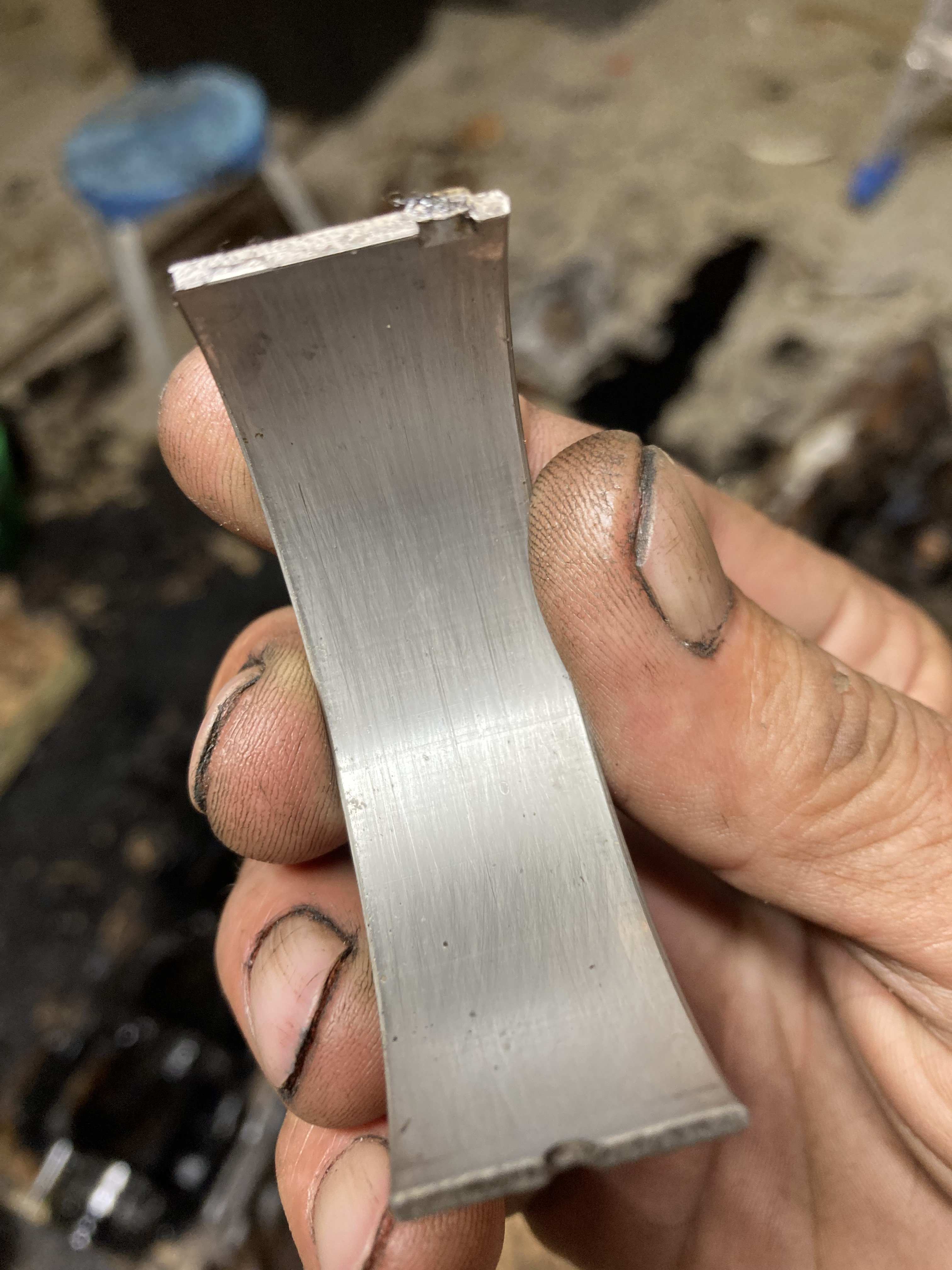

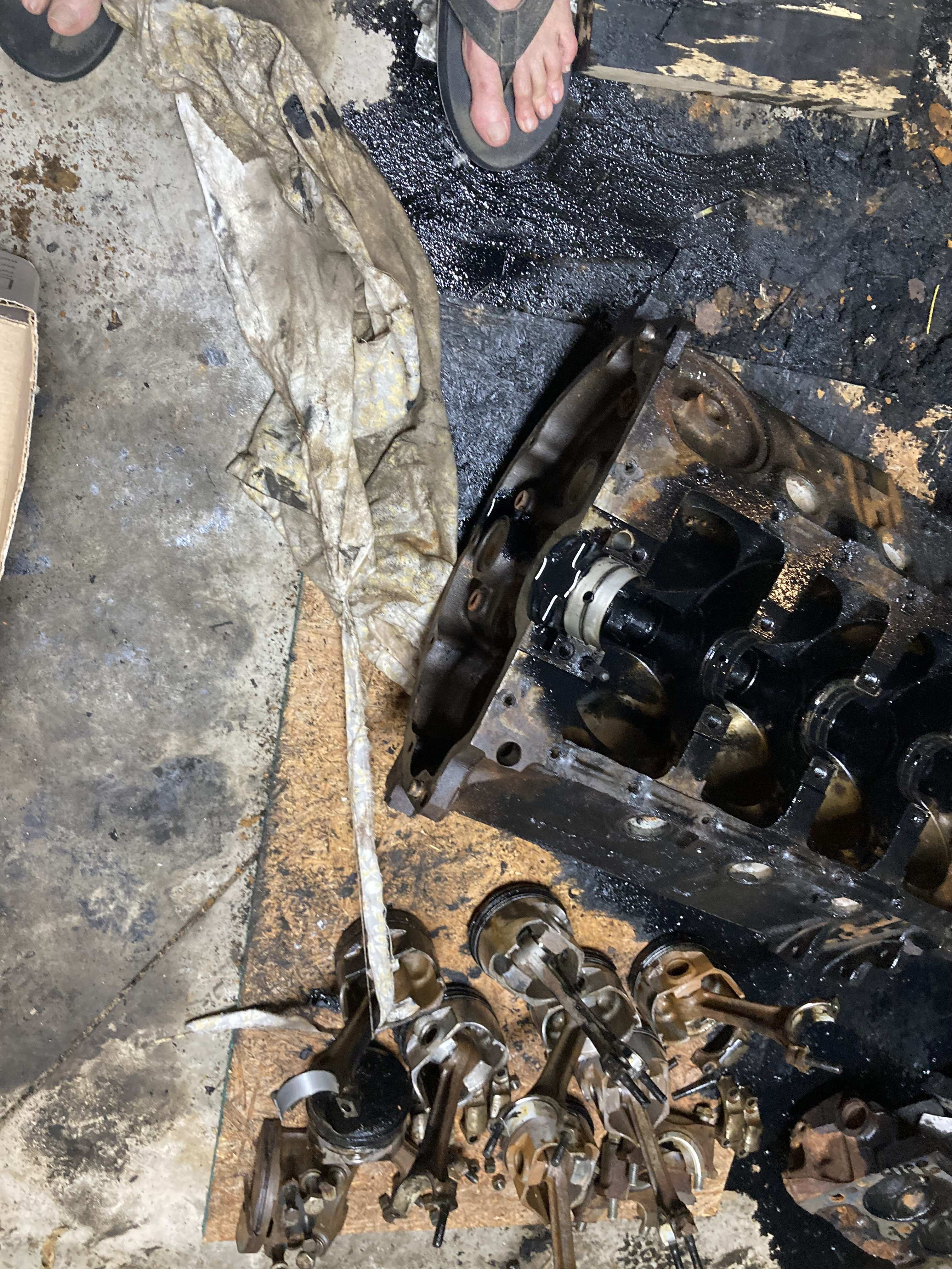

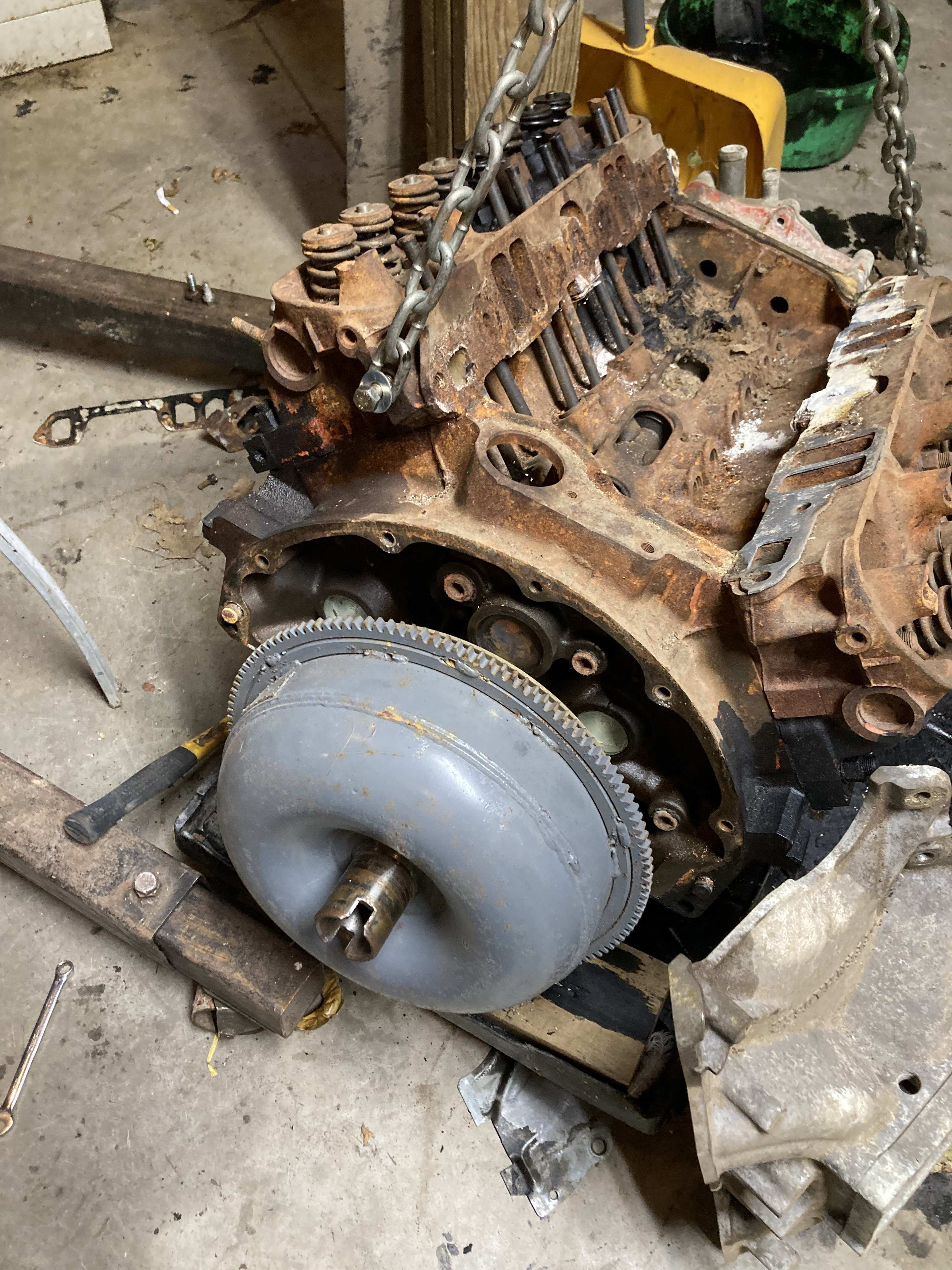

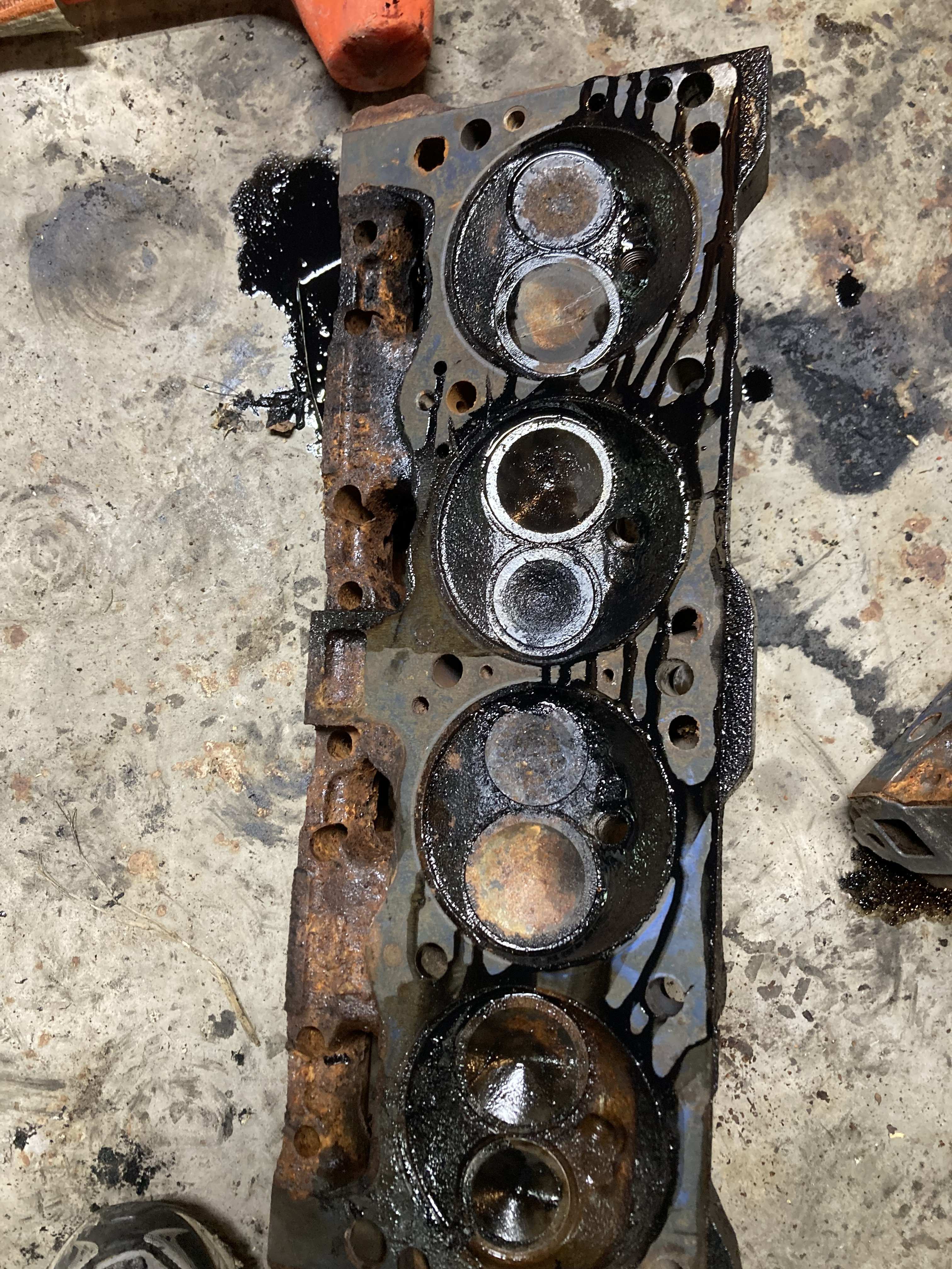

I opened up the original
Motor for the AAR today and have some
Pics. Big mouse nest in the oil pan and still haven’t removed the cam and lifters. Soaked them good and will let sit for a week before I try to remove them. Pistons came out without too much trouble but been sitting with lube soaking for two weeks. Still need to clean up all them parts and inspect but it looks like the engine was rebuilt and never ran. Here’s some pics.

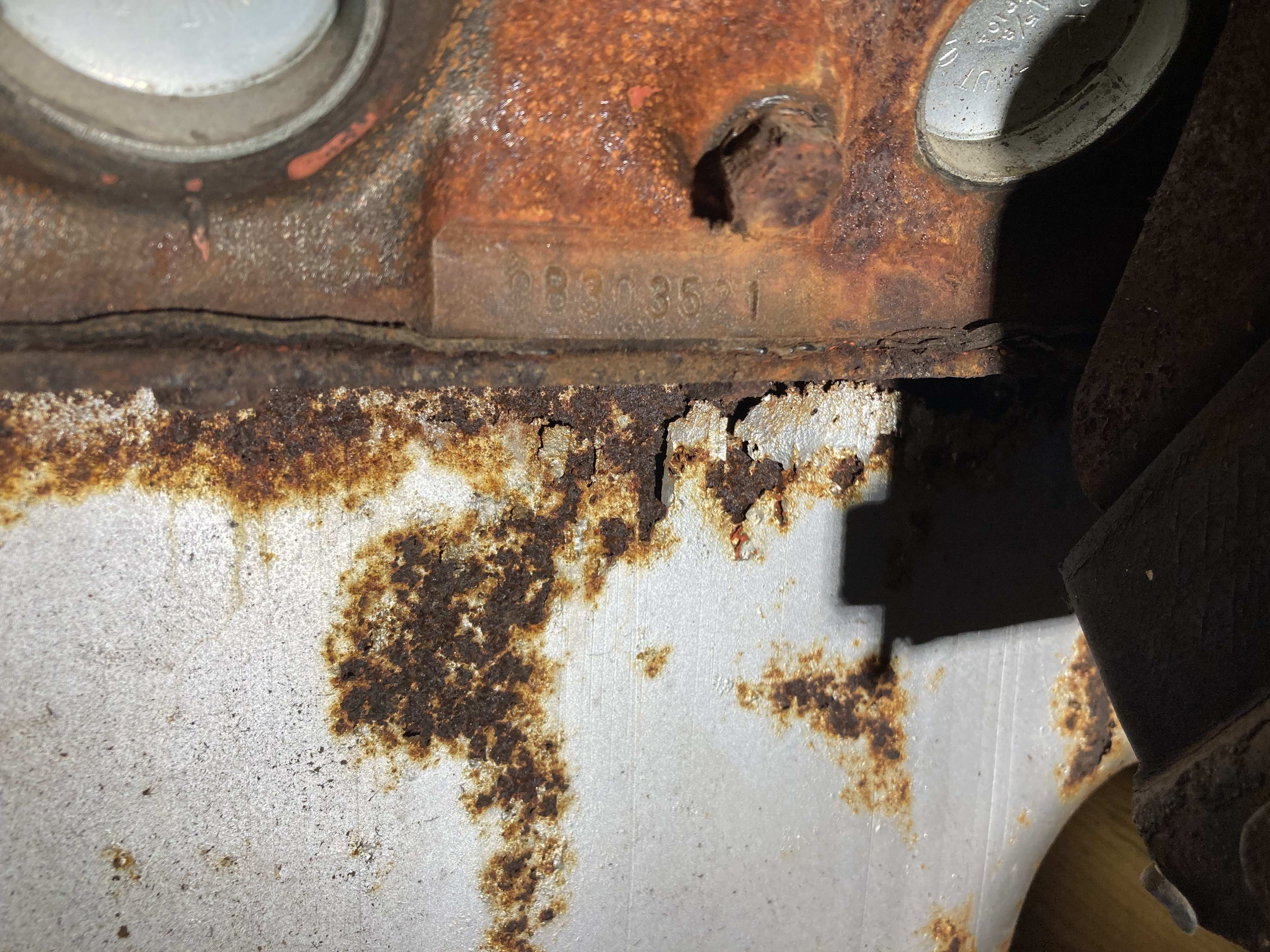

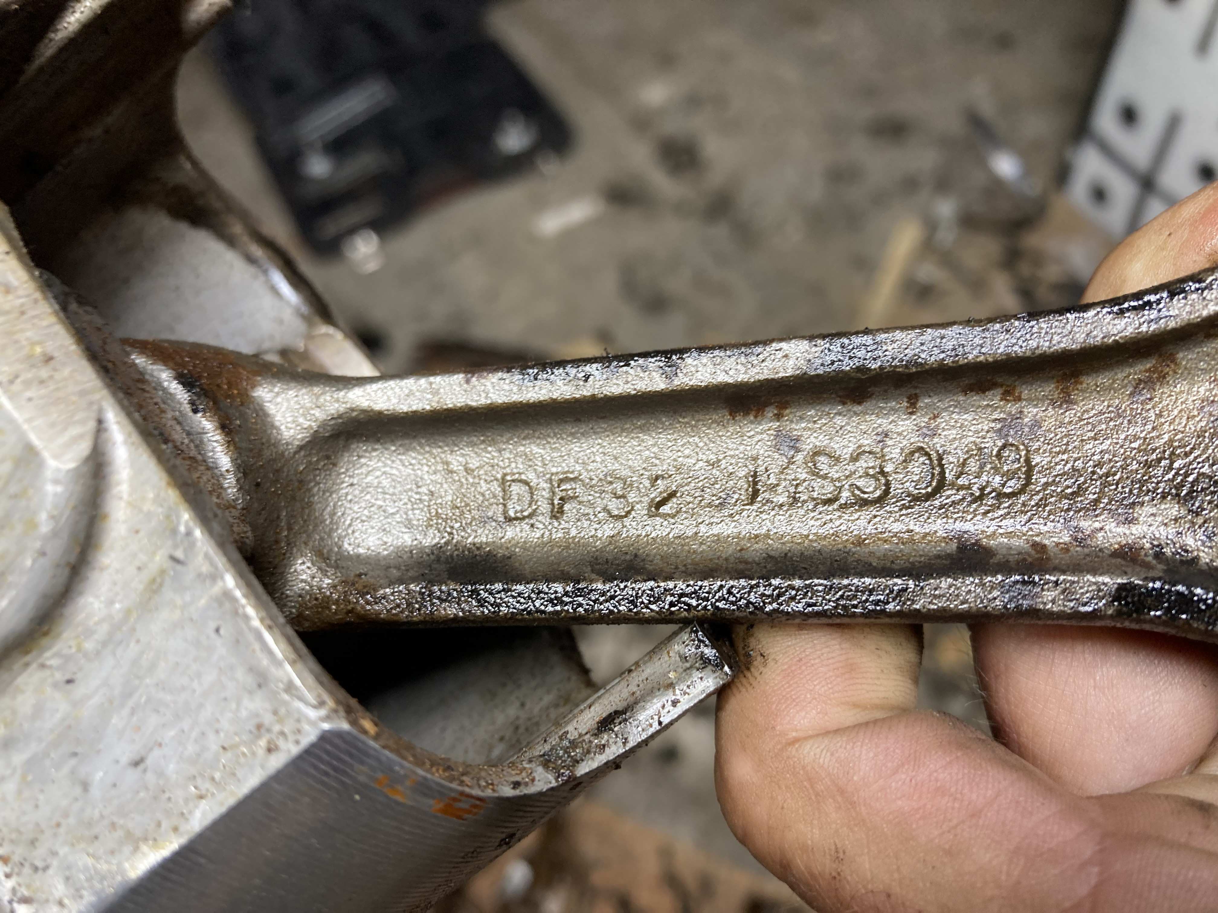

Bottom of a t/a block, note the thickness of the main ribs. Also note some work has been done on the heads which I’ll be looking at closer after a clean up. Maybe one of you can tell me if this a stock Rod also. 😊

Wow. Good score. Hopefully the cly walls are not rusty and pitted. Remember that the walls are thin on all 340 so a .040 over bore is max. It’s already at .030. I’ve got two AARs and wish you luck with the car. Save as much of the original parts as you can. Since your car is so original and complete, I would find original TA iron rockers. You can find the. The Harland Sharps are well over $1000 and you can find the stock TAs for about $1500. I see then regularly. Check eBay. . I’m jealous of your two build sheets. I’m not sure if I ever had one but I changed out my original seats in 77 for some better ones and never knew to look for such things. Congrats.

Thanks, the cylinders and entire motor were rebuilt and it was never run. There is some rust on a few of the cylinders but on others you can see it was fresh bored and never run. I washed assembly lube off the cam after prying it out of the engine with a crow bar, lol. I’ll be taking this to my engine guy today and see what he thinks, overall I am hopeful after disassembly and inspection!
