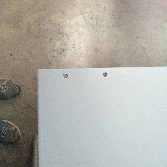

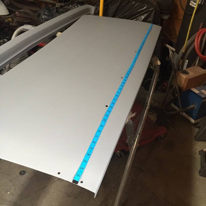

I'm installing a FPAP rear AAR spoiler on my 73 and could use some pictures and/or measurements for a proper install. The left/right alignment is obvious, but front/rear is another story. I plan to make a paper or cardboard template, so I don't F it up completely.

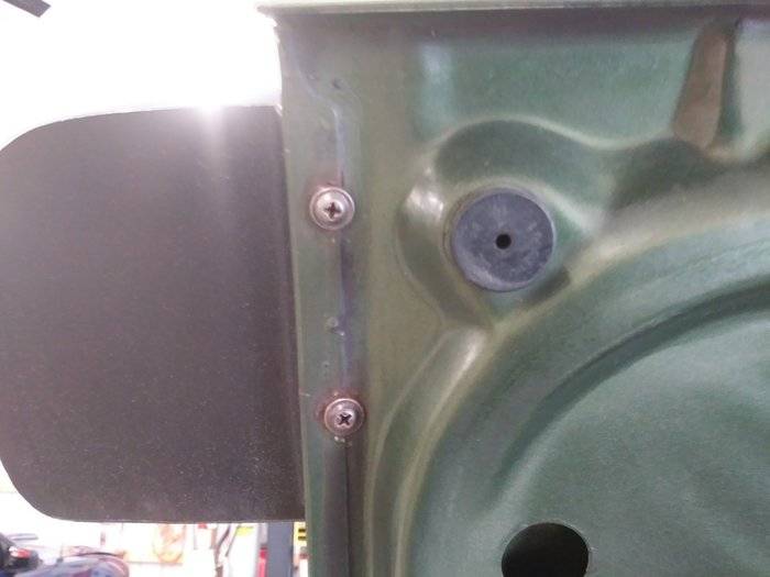

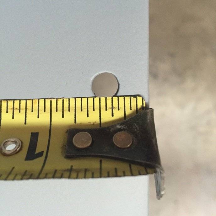

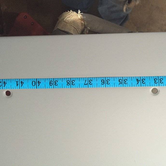

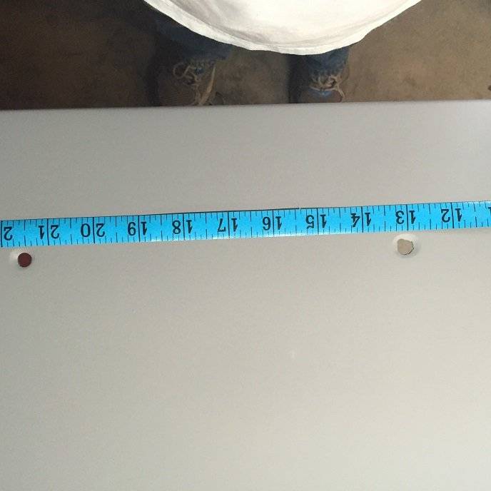

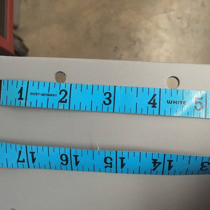

here are a few pictures I found on the net. They are real close, but measure a couple of times before you drill. I put the brackets in the spoiler and laid it on top of the deck lid with the holes laid out. I had to adjust the measurement a little.

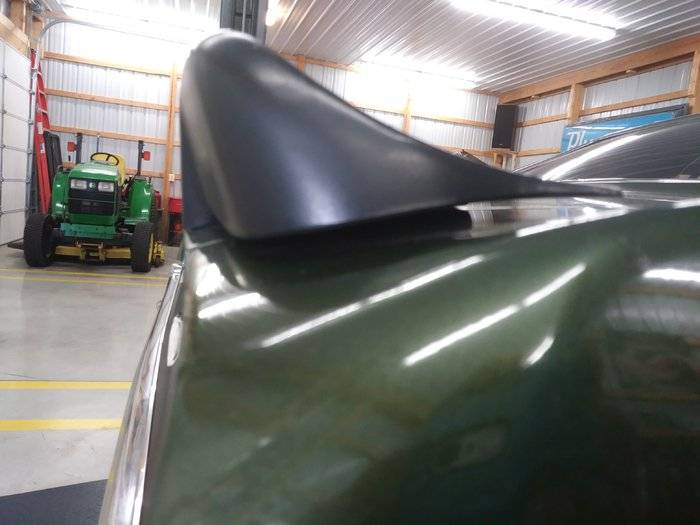

I looked at some pics this morning, too. These AAR spoilers are just about all the way to back edge of the lid from what I can glean.

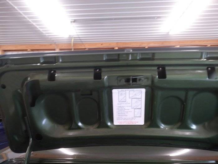

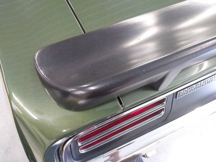

Here are a few closeup photos of my survivor AAR spoiler. Yes, the 3 back stands are flush with the trunk lid edge. This should give a little eyeball perspective.
