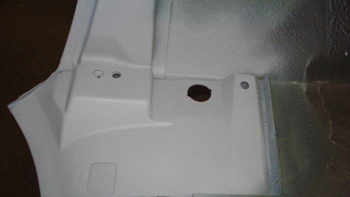

Sebastion, here is a picture of my '71 Challenger factory fender with the antenna hole. It looks like yours is factory. Make sure that the two metal layers are not gapped apart too much and grind those non-factory screw holes down flush. Your antenna kit looks just like mine.

Sebastion you have an original fender with the factory radio antenna hole. The fender may have been damaged at one time. I agree with moparlee. Make sure the two metal pieces are together. They may be spread apart which is why a screw on attenna was used.
