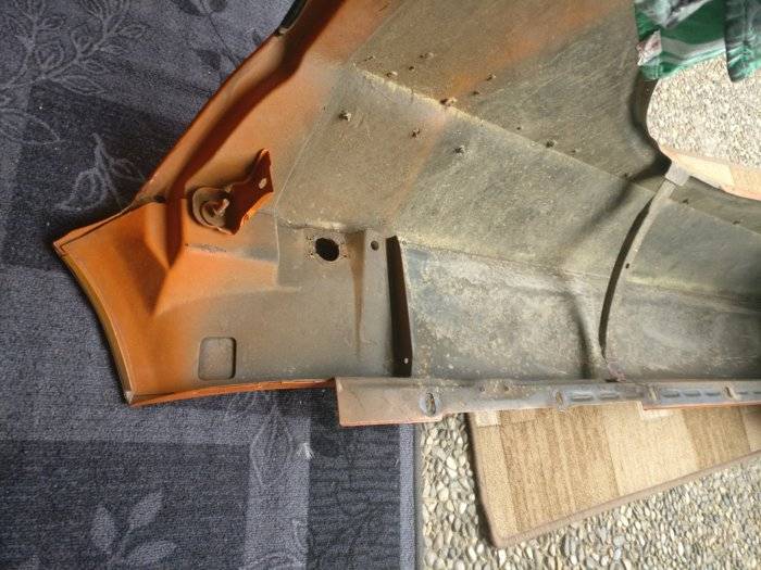

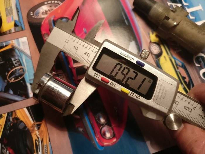

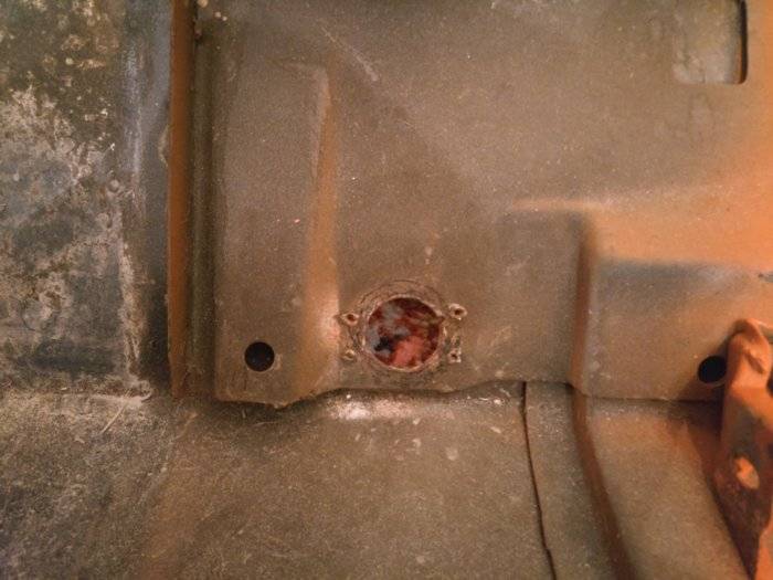

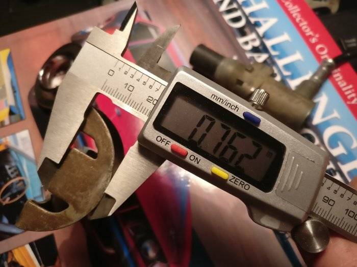

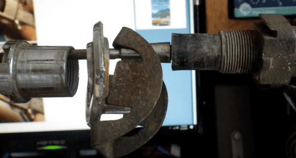

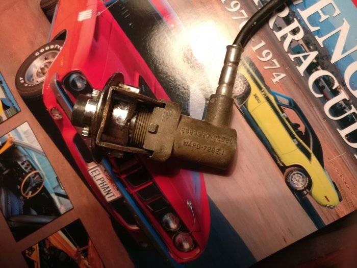

Hi,
i recently bought an original antenna kit from a member here.
Everything was fine - kind contact, great packaging and items like expected.

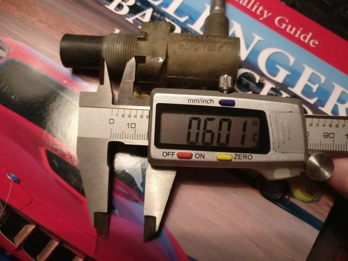

Unfortunately i have the problem that the antenna wont fit in my 70s Chall front fender.
It seems that either the threaded stud on the antennas body is too short or the mounting collar is too high/big?
In other words i cant fasten the capnut onto the antenna body because the thread wont bite in.
When not in on the fender everything fits nice together.
