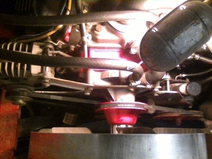

You don't have to change pulleys, it's close, but I'm running AC pulleys on mine without AC. The sweet spot is a 45 inch belt (15450), shorter or longer and it will run into the underside of the water pump.
