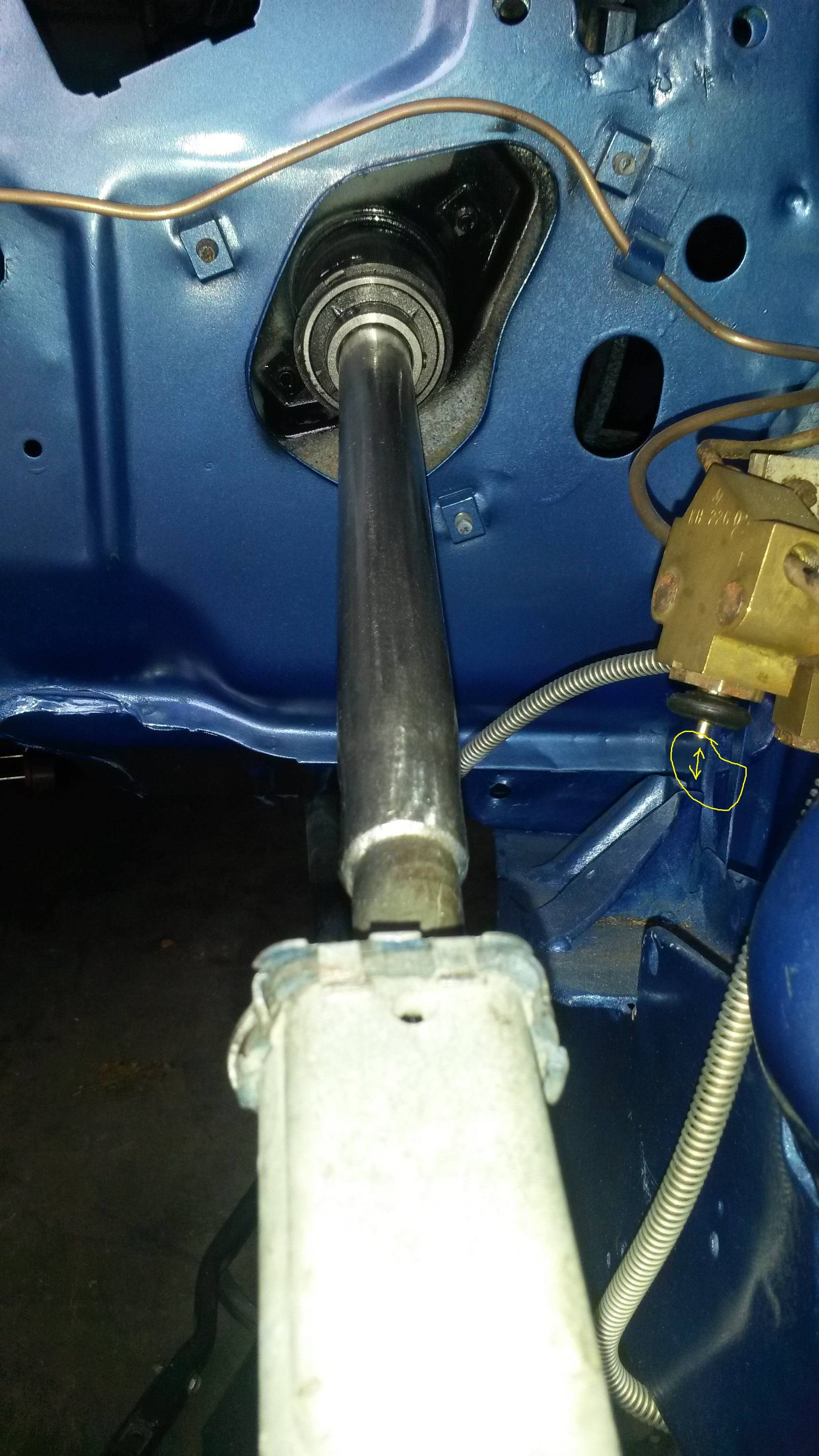

Had the same problem. Mine had new lines hoses rotors calipers pads shoes parking cable and good drums and rebuilt wheel cylinders master cylinder. Have everything within spec, drums rotors pads and shoes. adjust parking brake. parts can have wear as long as they are in spec. When you bleed the brakes Did you reset the front metering proportioning vale? sometimes you do nothing some times you simply pull it out and bleed brakes.other time use the clip to hold it or have someone hold it. Try moving both ways . https://www.forebodiesonly.com/forum/attachments/brake-valve-jpg.82222/
