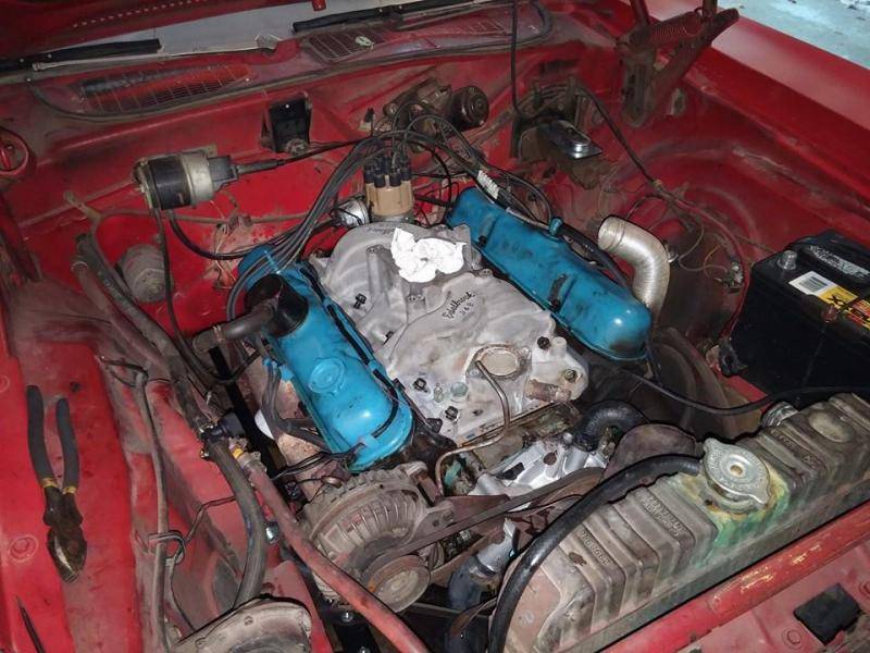

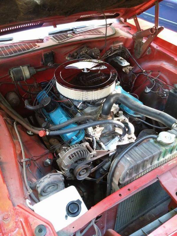

New intake
Well i finally got around to putting the intake on here is the old and new just waiting for the carb to come in the mail

Looks like time to clean and detail the engine and compartment. By the way, have you also ordered new carb and kick down linkages as the 318 parts will no longer work. Just FYI. Does the cruise control work ?

Yes I do have the new linkage for the carb. and the cruise does work just have to replace the vacuum lines cuz they leaked a little bit.
