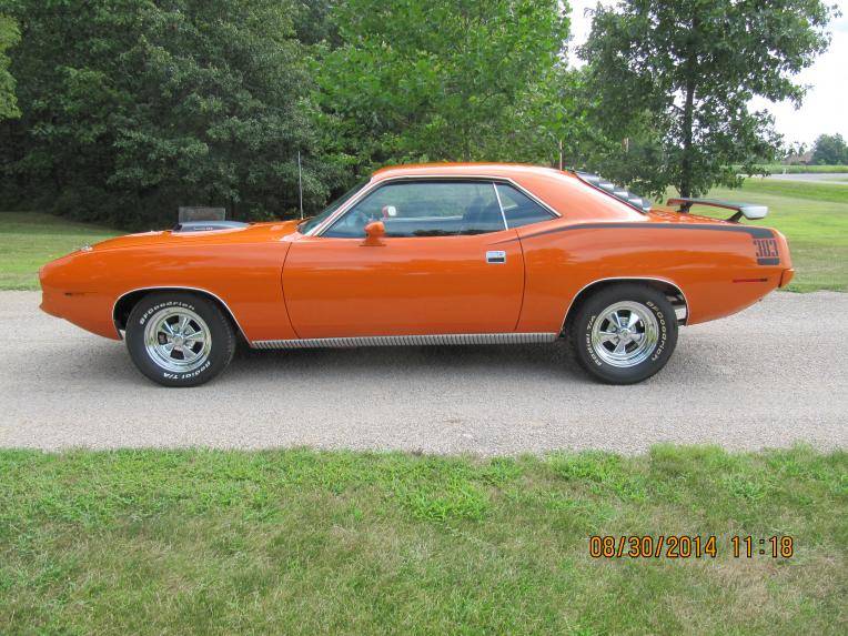

IMG_5363.jpgSorry I misunderstood what you wanted. My car sits 25 1/2" with 235 60R/15in tires/wheels. Measured at the lip directly above the wheels center cap.
