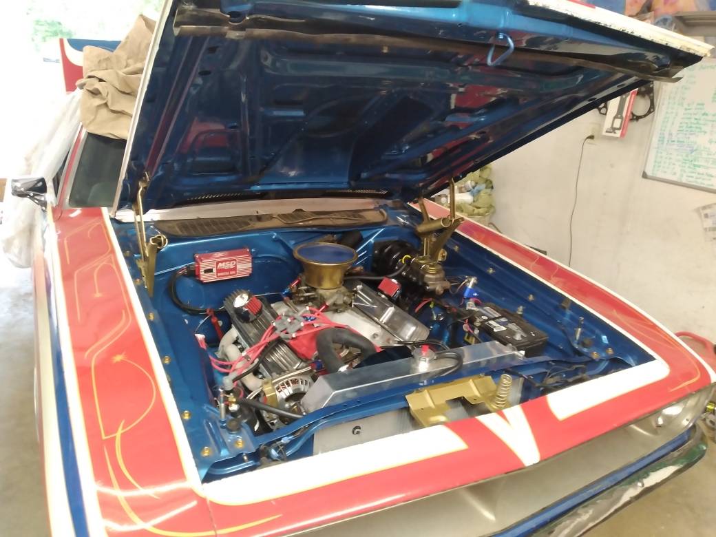

383 with Holley 4150 750 MSD ignition, running her on the street in break in stage getting plugs foul,, best plugs? and best way to lean the Holley out a bit Thanks

Don’t rule out the ignition system as the cause of fouled plugs as a weak spark can do it too. MSD should be okay, but you never know. Do you have a good ground as that can mess up an ignition system.

I will check ground good tip, This is a fresh Rebuilt too so I am thinking the jets may need adjustment. Pulled plug totally black not that wet but black

Main jets really have no impact on fuel delivery until wide open throttle. Make sure your float levels are set correctly, to high a float level can cause the issues you are describing.

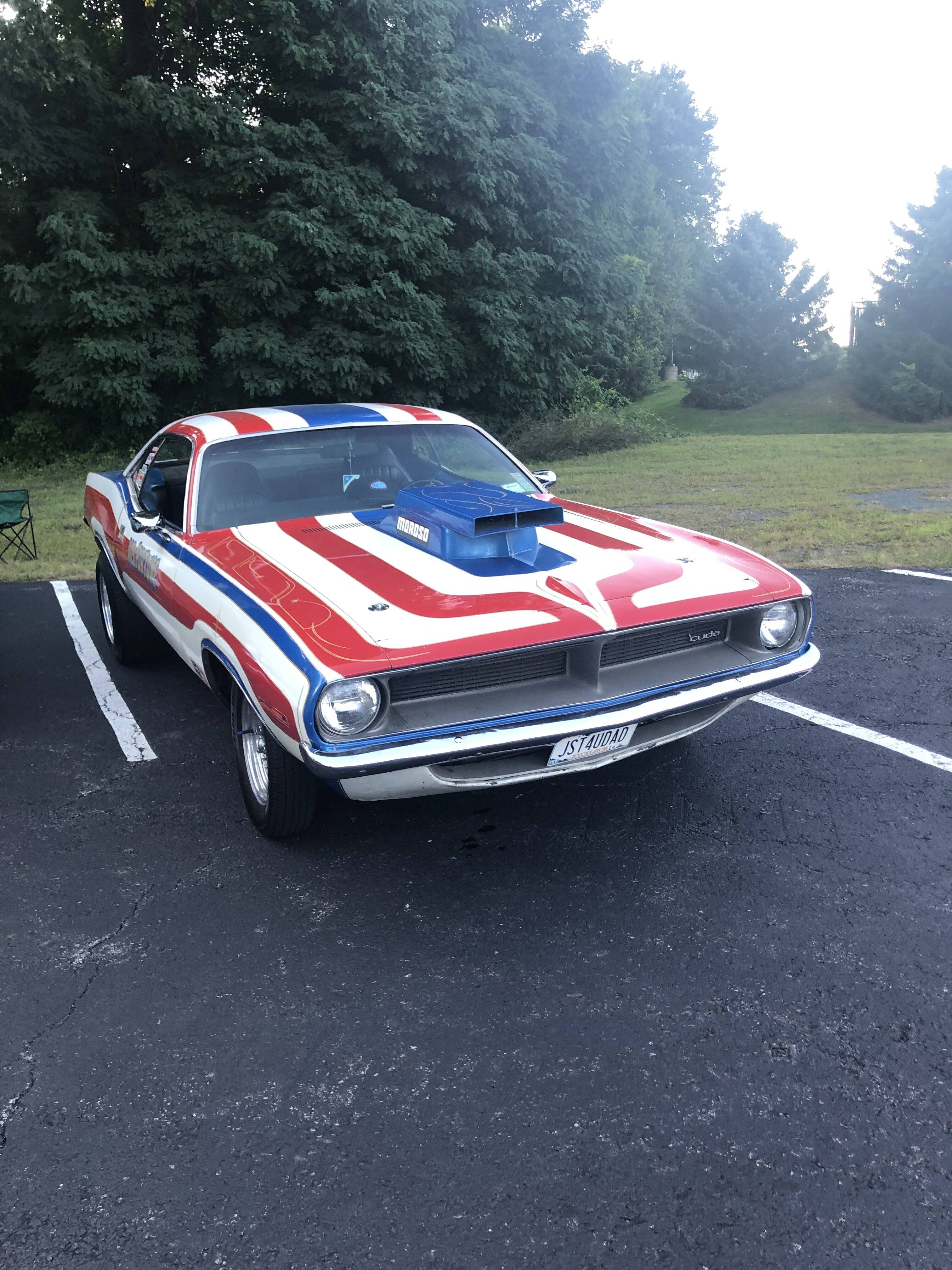

Thank you novice here well it’s been awhile My 1970 Barracuda just came out of a 33 yr storage, we refreshed included rebuilding the original Holley750 , I have driven her about 200 miles not really opening her up but more crushing at 2-3000 rpm.

Great looking car. If you live near the Hudson Valley, bring her to Bear Mountain on Wednesday night's next year. That car will draw a big crowd.

I grew up in Westchester where I drove her in the 80’s now I live near Saratoga Springs,, not far from Lebanon Valley🏁

383 .030 aluminum heads 425 Hydraulic cam 10-1 flat top pistons, and 3:91ratio .
