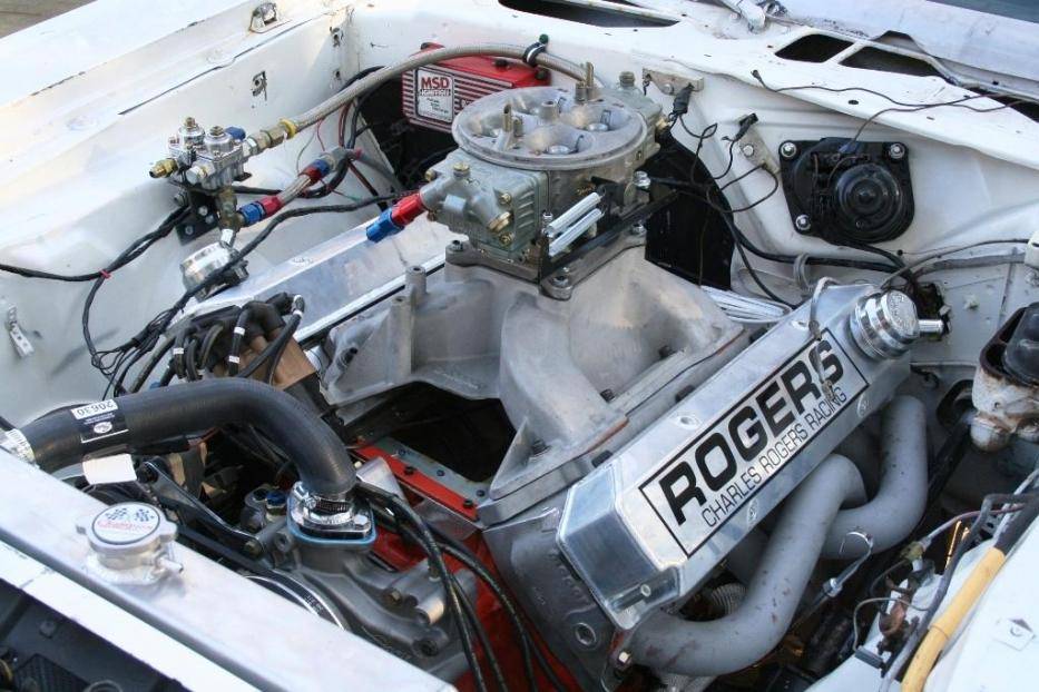

I guess I am going to be the bad guy here and say i would use the Big Block. I have an aluminum headed 512 in my street car and would not have it any other way. Do not get me wrong those small blocks are bad but when you are not racing and useing the car to cruise around in mostley it sure does look good to see a big block under the hood.
I used stock big block mounts and they hooked right up.. no need for any special mounts. Radiator is easy as you can get an aluminum one for $230 for a big block. Drive shaft is simple as a local shop can take care of that..
I for one love my Big Block Challenger...
