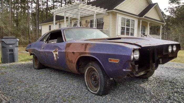

Been working since January on 1970 Challenger A66 that I imported from PA last year..
I bought it as a non-engine nor tranny roller. Back in the day it was A66 340 plum crazy with a black butt strip.
I have got waiting to hop in 1978 440 +727 (yeah, I know) and that's best I can do right now...
There are loads of missing parts that I am gradually trying to source.
Bodywork is not in very good nick, but it ain't something I can't get right eventually.
All of the car work I do by myself and love it. Will be having a lot of tech questions and will try to be active and cooperative member of this group.

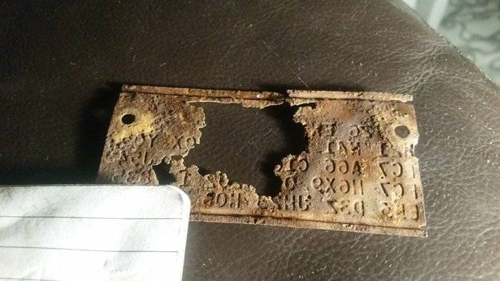

(I track the A66 Challengers; be curious to see the tag numbers if it is there? Is she an automatic car, and what is the scheduled production date on the tag?)
Anyway; Best of Luck with the new toy!
Fender tag is present but rotten. There is inch and a half hole through it :)
Anyway I was able to read few codes that I will post later.
No buildsheet.
Dash, door, rad support and cowl vin numbers match.
It is slapstick, central console AT car.

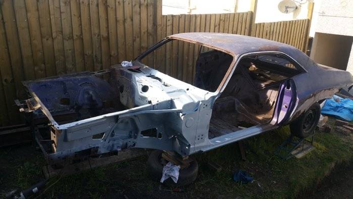

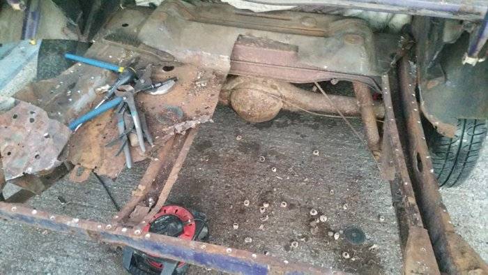

I am adding few pics of what I have been through so far... if here is not the place I will erase them, no worries, do not want to mess up forum's rules.
I have no conditions present for a proper resto, nor can afford one. So everything is die-hard work, some compromises maybe, but I am not troubled. Car is rust bucket, never going to be perfect and I just want it back on the road, among the living. It is so simple. For me.
However, all the rust and rot is going to get addressed.
PS: It is a no-budget, against the wind project so please understand why I fabricate parts instead of buying them.

About the fender tag- FC7, H6X9, D32, A66, H41, JH23, J54, 26, Y05....
Can't read out any other codes.. there are five lines of them..
They only could be tell by looking from the back side..the face is heavily pitted.

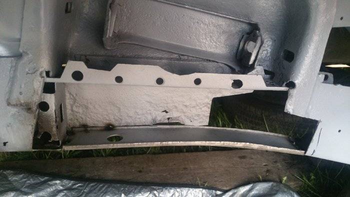

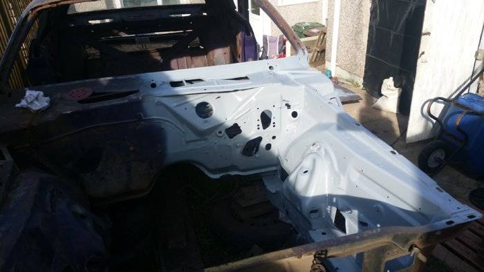

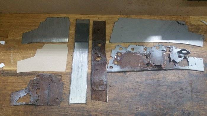

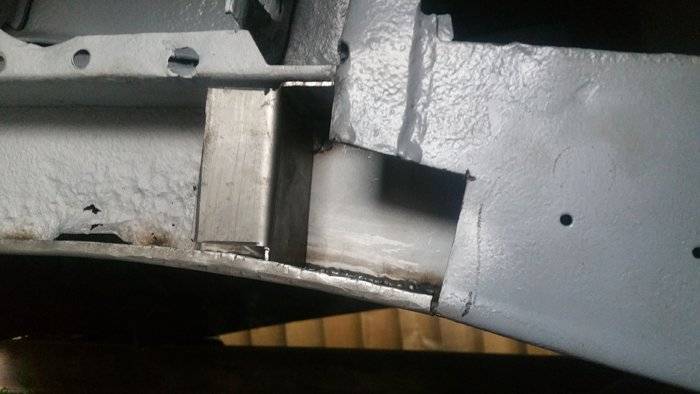

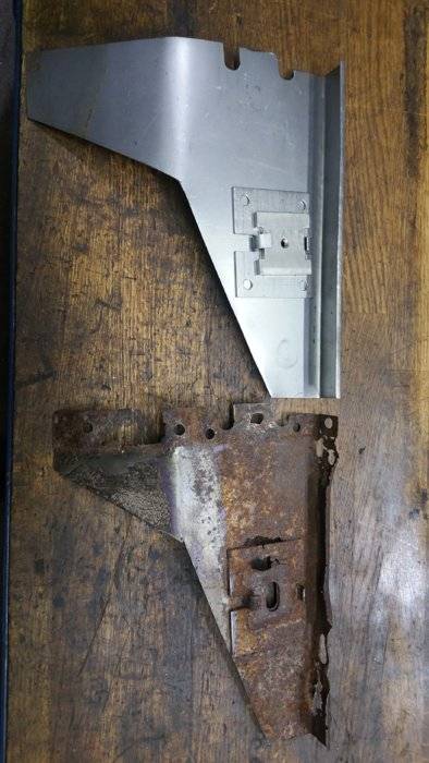

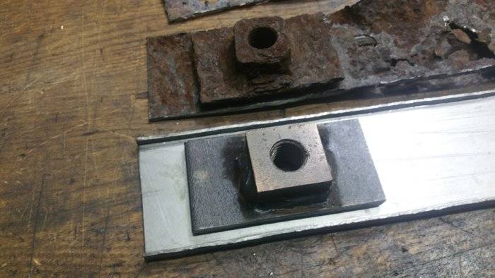

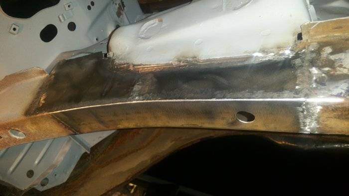

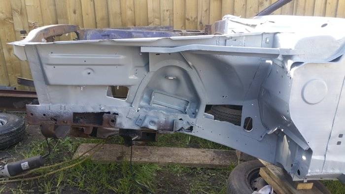

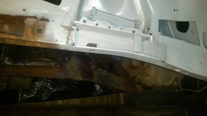

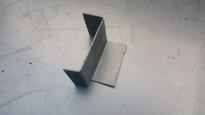

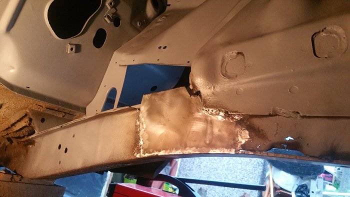

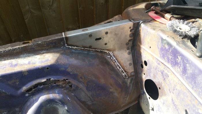

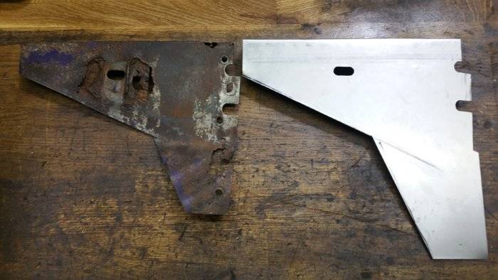

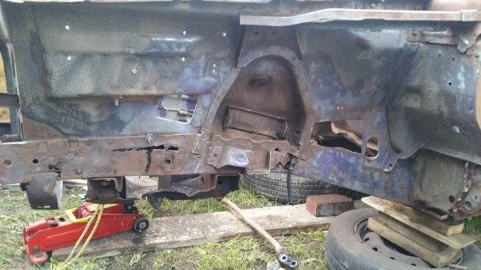

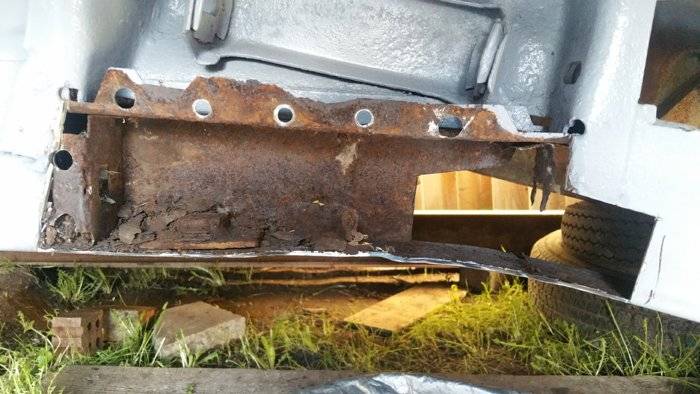

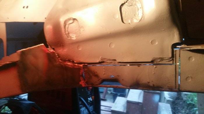

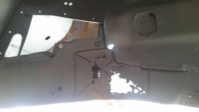

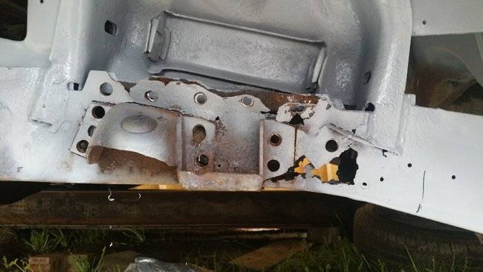

Please see few more pics attached. I am nearly done with the inner fenders' hinge area. Few days ago I moved to the front left frame rail. It is bad there, but anyway I think it is going to get repaired nicely.
Sheet metal looks like close to 2mm thick so this is what I chose to use.
K member fixing point is milld steel block tapped 5/8 -11 thru. The plate underneath is 6mm mild.
Weatherman hinted on dry weekend here (!) and I will try to get this patches sorted then. I got a can of 3m weldthru today and should be ready for action..
PS: We moved to that house recently and did not have the time to erect even a some sort of a shelter for the beast. It is only doube-wrapped in plastic sheet for now , but in few months time this issue should be rectified by a makeshift garage from some variety..

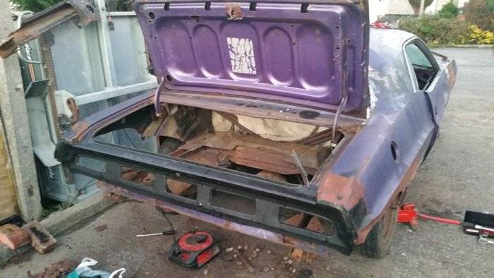

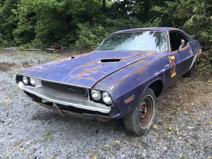

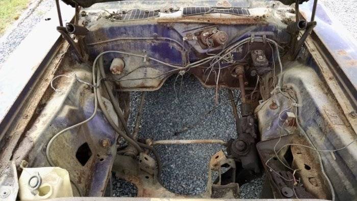

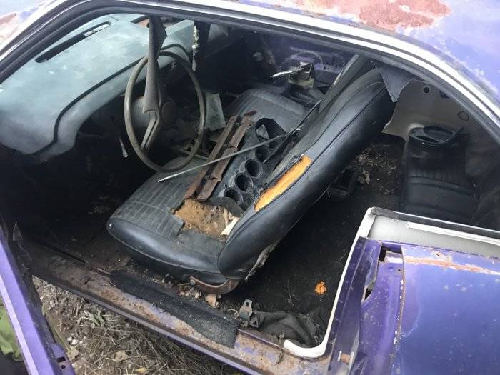

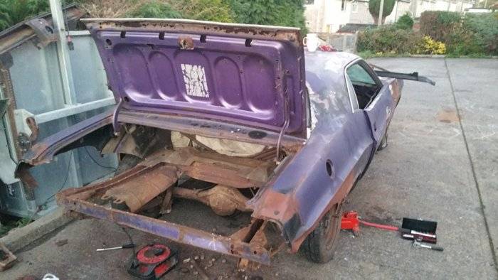

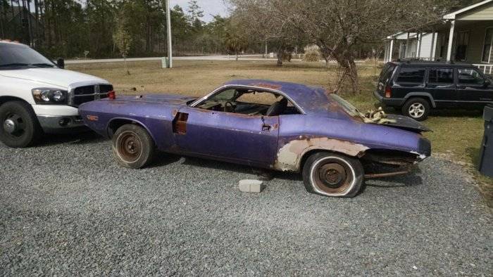

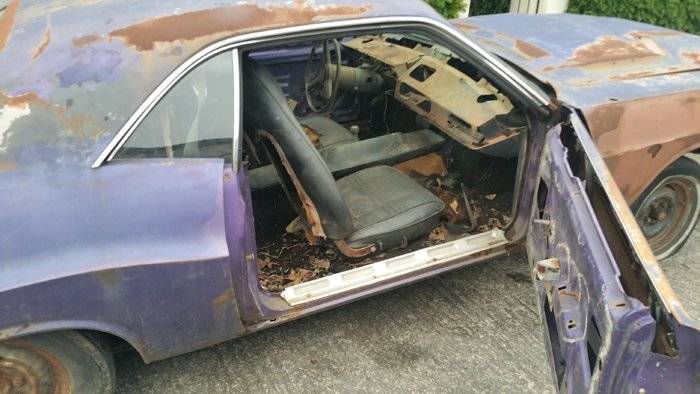

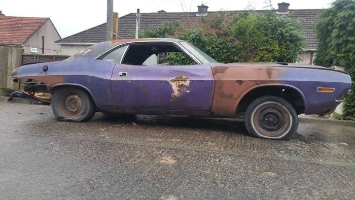

Please see few more pics from the Craigslist ad of the Challenger and from the first days of getting acustomed what I got involved with.
