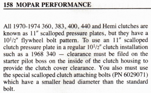

Just in case the entire clutch assembly ends up needing replacement... any advice on how to positively identify the correct parts? Are there any part numbers or casting numbers that can be seen through the bellhousing inspection cover? Shipping takes a while to get here, and I can’t leave the car sitting at the shop for weeks or have them pull the drivetrain apart twice. 🙈

You should have a 130 tooth flywheel so you need a 10.95" setup , the disc could be 23 spline [ more likely ] or 18 spline HD trans .
I would use McLoud or Ram or Zoom , Stay away from Centerforce garbage , I prefer to use factory Bog & Beck 3 finger type over Diaphragm type as the factory system is design
for the 3 finger type , throw distance & removal of the overcenter spring is usually different with Diaphragm type

The reason why I'm asking is also because originally it was a 3 speed manual and I have no idea what had to be changed for the 4 speed. But let's see what is really needed in the end...
