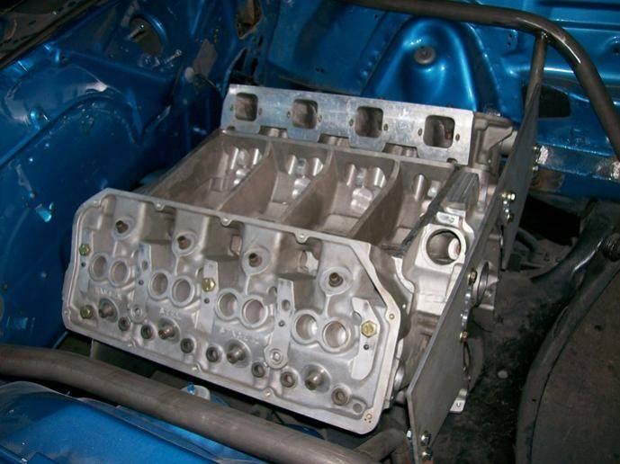

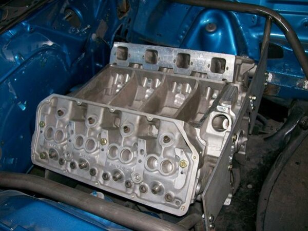

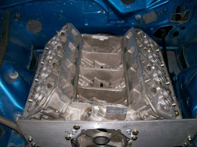

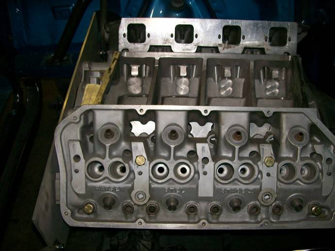

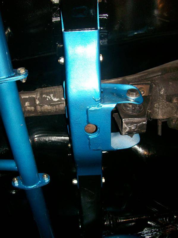

100_1682 [640x480-2].jpg100_1680 [640x480-2].jpg100_1681 [640x480-2].jpgIt was kind of nice out the other day so I went out in the garage & mocked up the Hemi & made, drilled & mounted my front & mid plates.

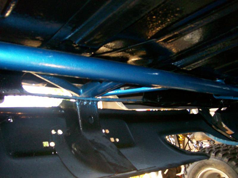

I have been out there a couple of hours here & there heating & scraping off the factory undercoating plus whatever some else has applied over the last 40+ years. This stuff is thick. So far I have scraped off 42 lbs worth & I am still not done yet. I weighed it the other night. I have 4 plastic shopping bags full with 10-12lbs each in them. Every pound here or there helps. Going to repaint the floor pans & detail everything underneath as I go.

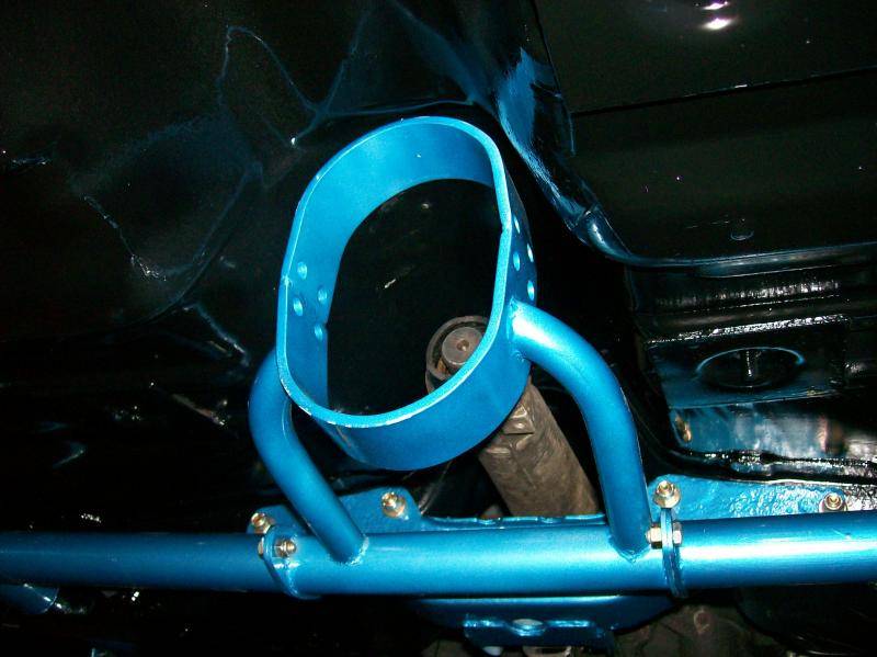

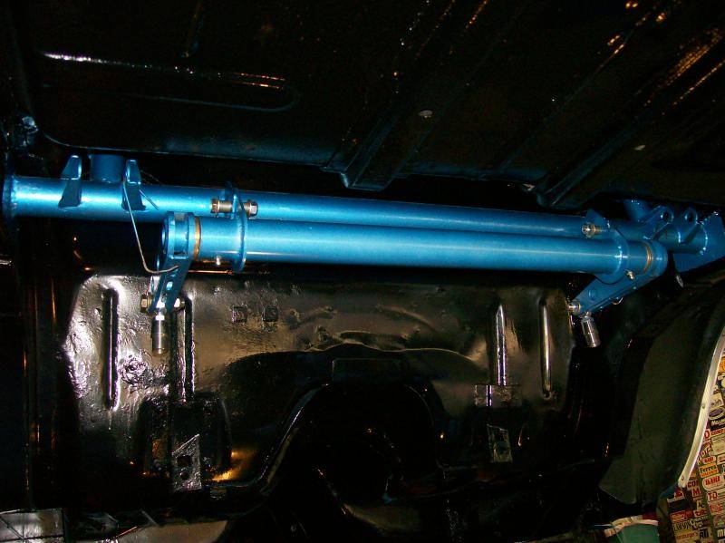

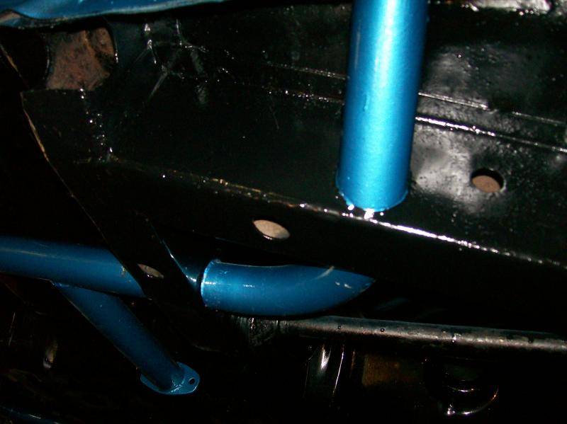

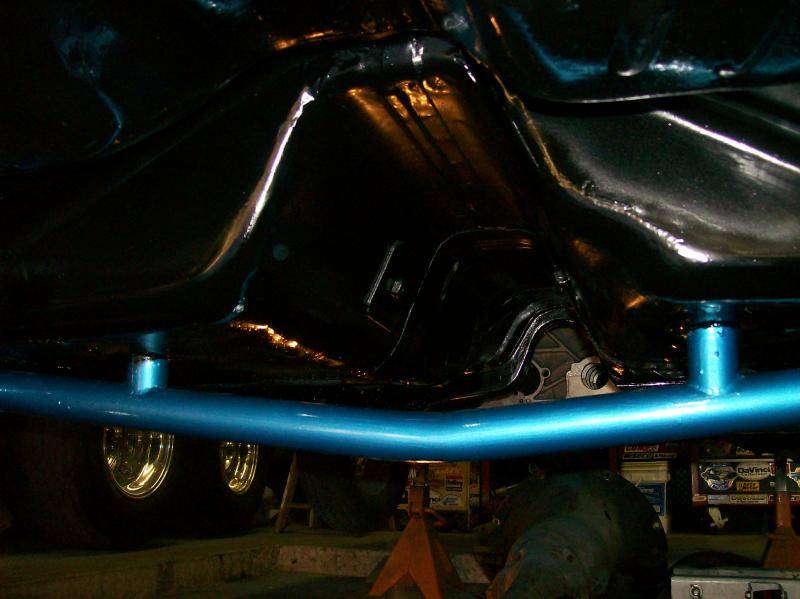

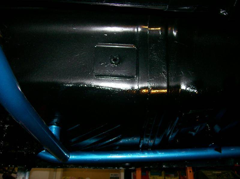

Latest update. Got the under side all painted from front to the back gloss black & painted the anti-roll bar, driveshaft loop, trans cross member & all of the under car bars in B5 blue to match the cage & body.

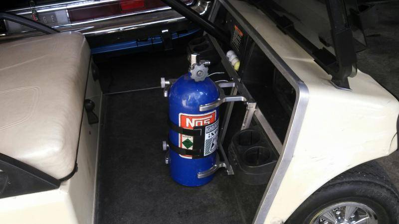

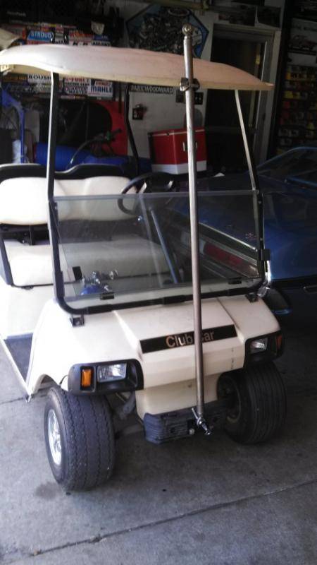

Been slacking on the Challenger build this summer mostly due to lack of funds. I did get out there & fab up a bottle mount/heater for the golf cart & a push bar mount for the front of the cart to hook into the parachute mount of the Challenger.

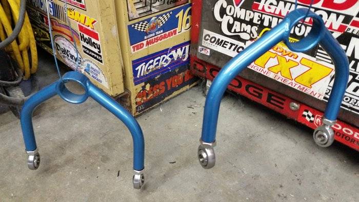

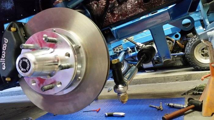

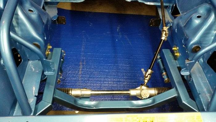

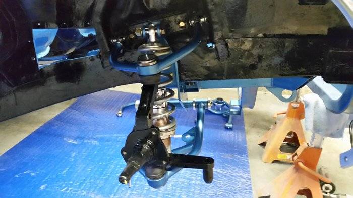

Latest updates. Tubular K-frame is painted & new tubular upper & lower control arms, rack & front suspension is all done.

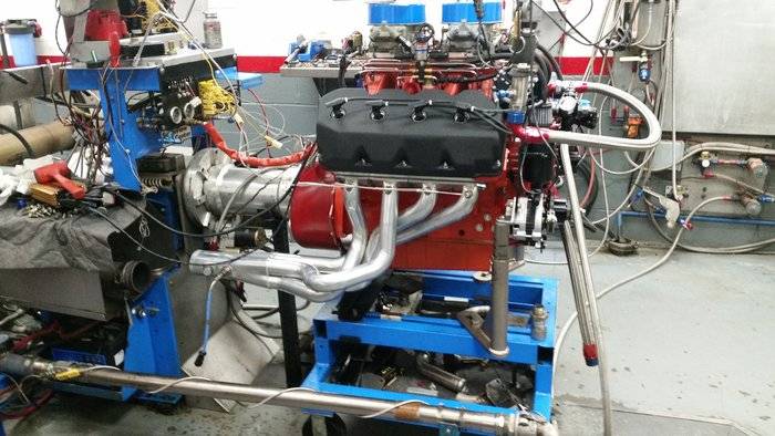

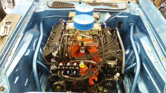

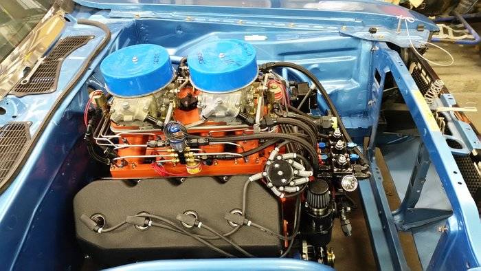

Hemi & trans is done & installed & dyno'd, Both Fogger kits are plumbed, Started to get somewhere now.

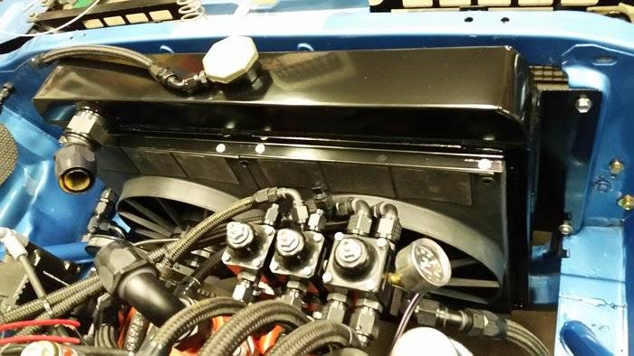

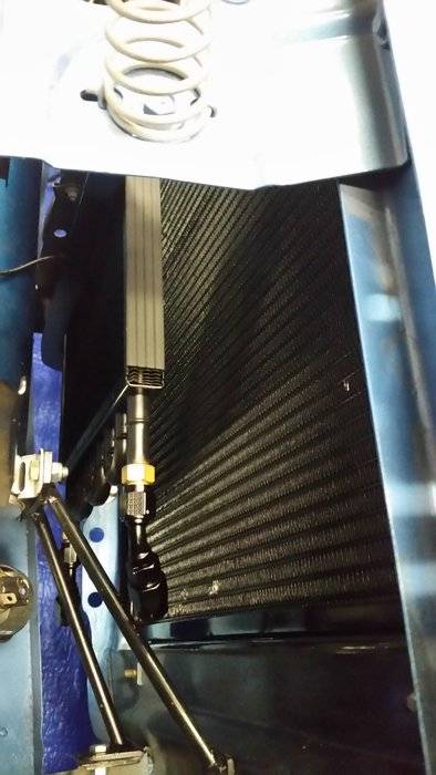

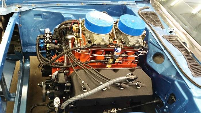

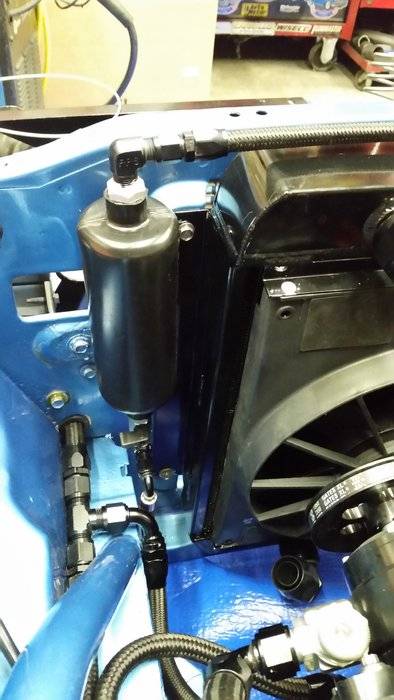

Custom alum radiator with shroud & dual electric fans is made & all of the hoses are done. Plumbed from the trunk all the way up to the engine, trans cooler & Accusump tor now.

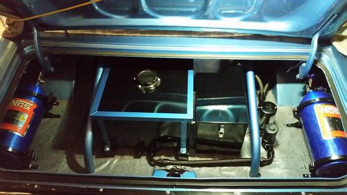

Trunk is done, fuel cell, battery box, bottles are all mounted & all plumbed to the front.

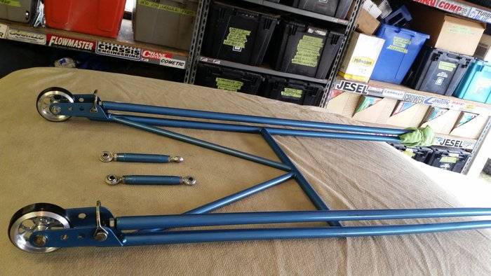

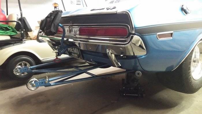

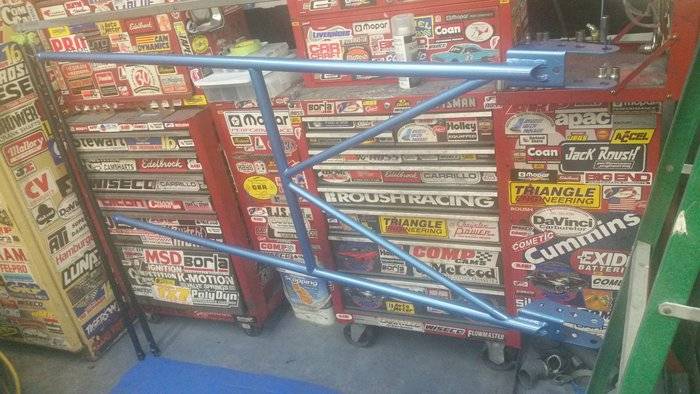

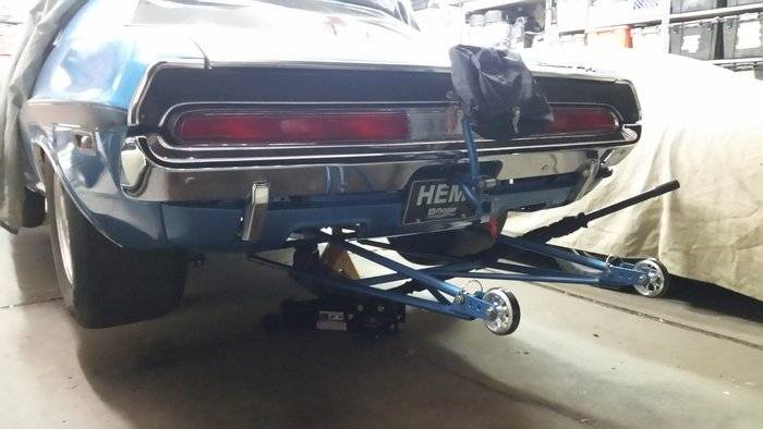

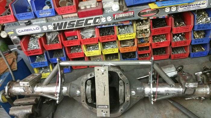

Rear axle is all braced, wheelie bar brackets are done, wheelie bars are painted and mounted. They bars & chute will come off for street use.

That engine bay is awesome and the plumbing work is fantastic! When are you hoping to lay down some serious rubber? Nice work!
Thanks guys. Down to the over head switch panel, MSD grid, digi-sets, nitrous timers and wiring the car from front to back. Hoping for next year.

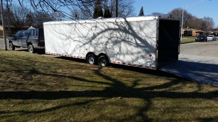

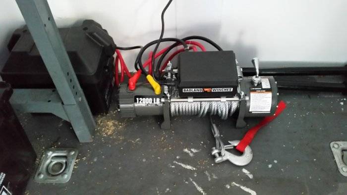

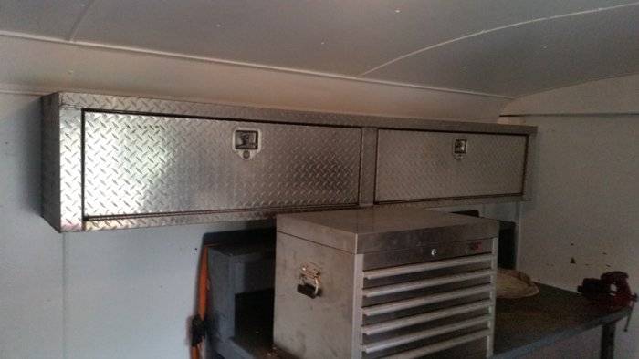

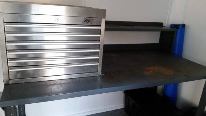

I was PM'd about further updates. Nothing new lately on the Challenger. I had to move my Parents over the summer which I lost storage for my Charger so I had to dip into the race car fund to buy a 28' enclosed trailer to store the Charger in for now. Which gave me a whole new project. Repainting the whole inside, installing, cabinets, work bench, electric tongue jack, 12,000 lb winch etc. At least the trailer is now ready to go racing also.

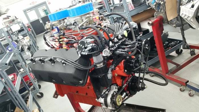

Let's see if this works. My buddy sent me a facebook post of my engine on dyno.
Wow! Cool series of pics and showing progress of car. I love it! Thanks for posting this car's progress.
I didn't see a dyno HP number anywhere though. ??? :)
It is going to be a No E.T./Grudge car on Drag Radials or a small tires. Lets see how she does first.... Then most everyone will figure out how much power it might be.
