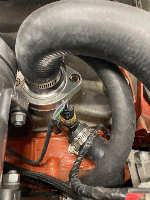

I placed mine on the bypass nipple by making nipple slightly longer and welding a bung on it.
