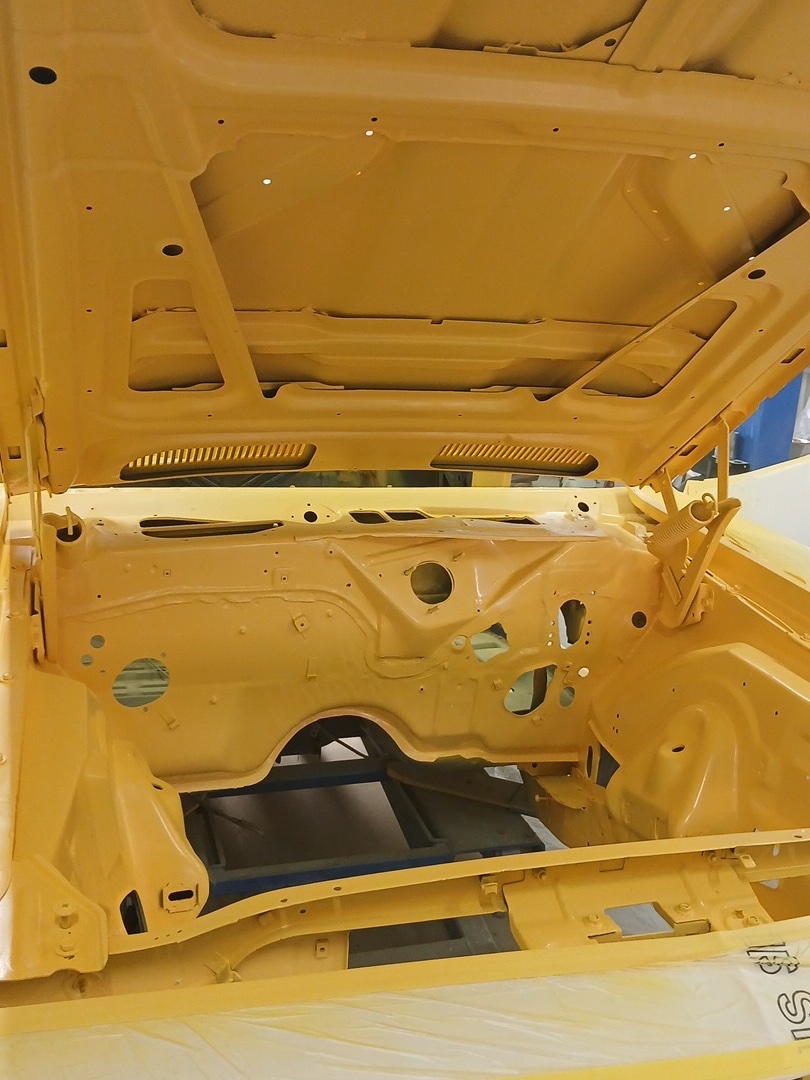

my future set up on my restoration is a moderately camed 69 383hp , auto . i converting my 74 cuda build from 318/auto . i need to purchase the correct cooling package . i have no fan , my buddy recommended running a solid steel fan . i need to know what diameter to order . i also need a appropriate radiator and shroud ? any recommendations appreciated. i have been source of parts from jegs and classic ind as available…

sounds good . i have to measure my opening on my radiator support next visit to body shop . hopefully tonight or tomorrow. if i can use a 26 is a two core ok ?
Since your car was a non A/C car the radiator opening will only fit a 22" radiator and if you did want to fit a 26" radiator, you will loose 2" of cooling per side. I would do like Chryco Psycho said and buy a good 22" radiator.
Since your car is painted and you may not want to modify the radiator passenger panel, a good two row aluminum radiator will be fine. Make sure you get a fan shroud, that's a big part of the cooling.
