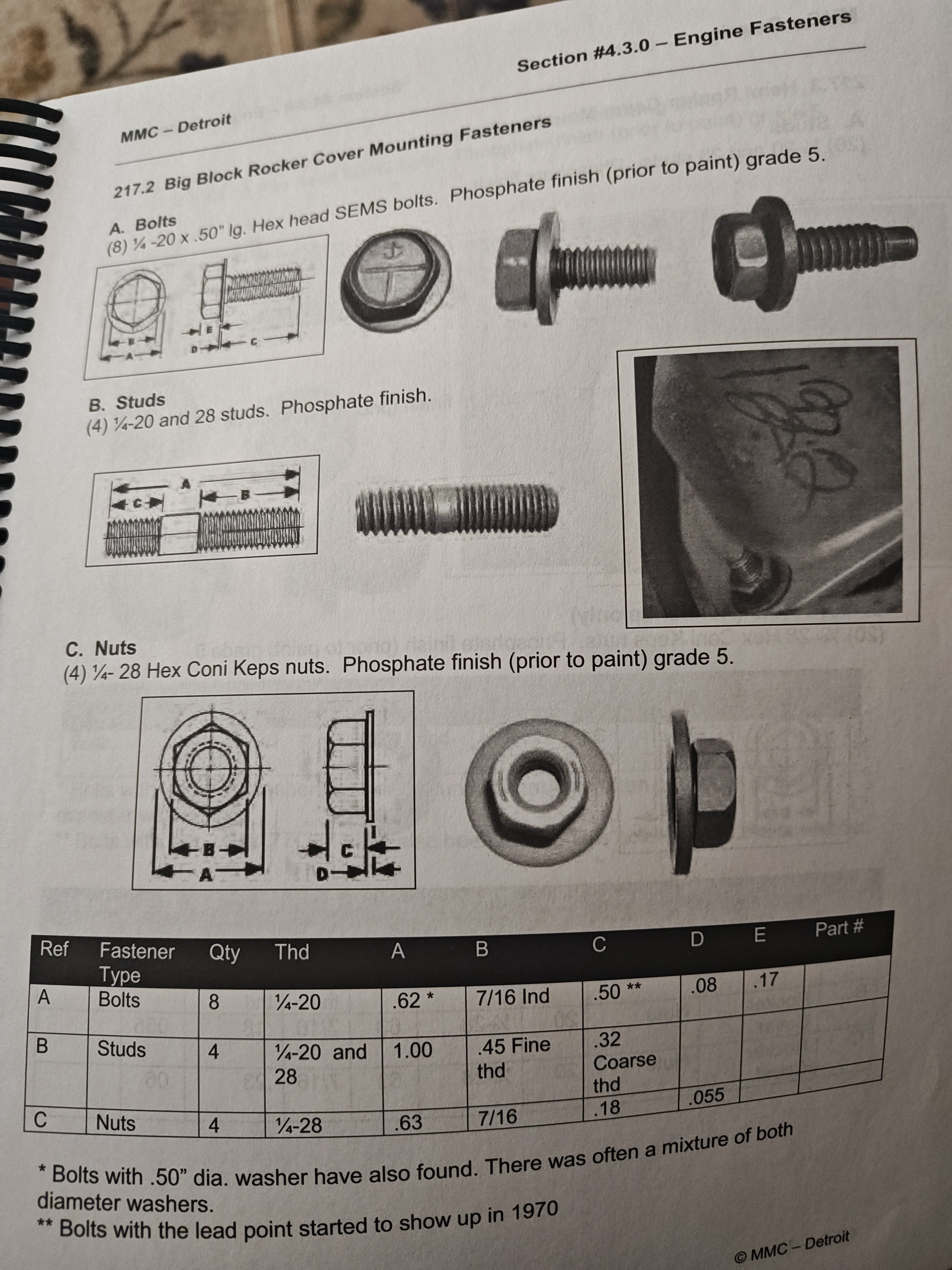

i have all anker bolrs on there now i have read it originally had studs in the corners . did it have the anker bolts at all are they correct if not what did they have
See below picture.
I'm not entirely sure what you have as an anker bolt. Maybe post an image, and we can help you figure where they go.
The fasteners shown in post #3 are the ones you want for the valve cover.
This has nothing to do with the original question but a bolt without a nut is a screw, the book is fundamentally wrong…:lol:
383/400/413/426w/440 from 64 to 78. 59-63 the big block heads had only 4 bolts and no studs.

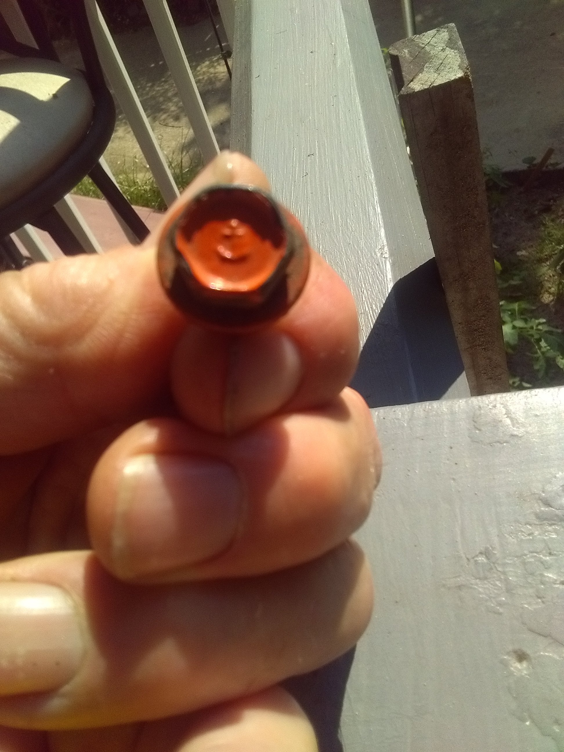

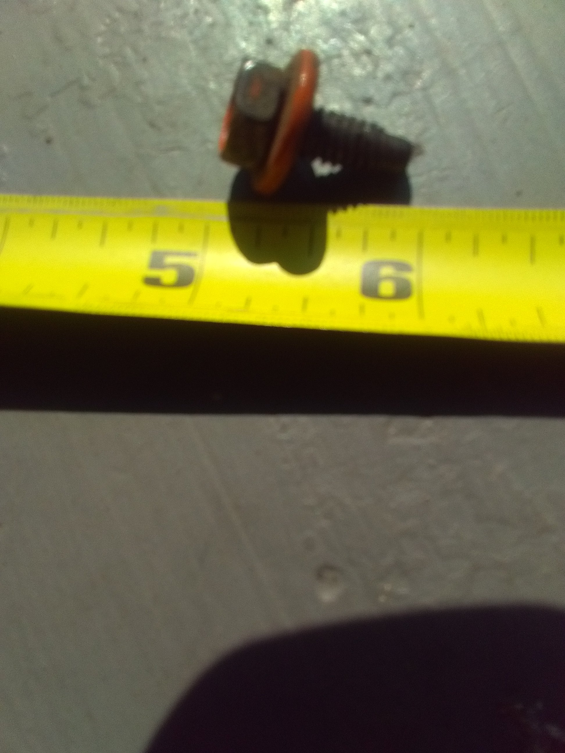

these are the bolts or screws i found in the valve cover of a cuda with a 383 . if they aren;t for the valve cover anyone know where they came from thanks
They look like the 8 valve cover bolts (screws) in the middle of the valve covers. Also the oil pan bolts are the same size and most have the same anchor symbol on them!
