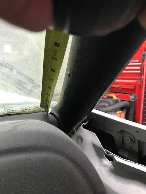

Here is a picture of my trim on my 71 Barracuda. I had the dash pad redone and there is minimal gap between the dash pad and the trim. The first hole is approx. 6 inches up from the dash pad and start of the trim.

Hello rklein71,
My dash fit has a little more gap, I think I may may try to lift the dash at the mounting points on each side to see if I can close the gap some. Guess I'm used to the quality of modern assembly line work. Your picture is really appreciated since my expectations may be a little too high.

I don't know if there is much adjustment for the dash mounting position. I installed my dash and much later installed the trim. I didn't have any issues, so I am not sure what is going on with yours.
have the same problem on my 71 challenger...did a bit of Dremel work. came down a bit. on A pillar post trim. after 52 years molds may be a bit off... Remember those cars back them were designed to last 3 years or so
