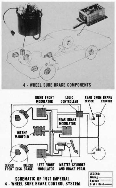

I my self have two and 1/2 sets of hens teeth. from a Chrysler imperial rear disc brake. I had them since the mid 70's,and have yet to put them on. Came to the conclusion not worth it. 1 from what I recall,had to use a roller bearing not a tapered bearing. 2 Braking 60-70% of braking is from the front brakes. 3 My conclusion as why the Imperial had 4 wheel disc breaks,is that it was a the weight. disc disperse the heat better then drum. and it had ABS.After decades of driving,in the land of ice and snow and where the hard winds blow.One develops a habit of pumping brakes for a controlled stop.Now one can not buy a car with out some type of ABS.I don't care for them.But in a complete panic stop it's worth it. but on the other side more to break.The best modification that should be done would be rear ABS. As far as rear drums as long as maintained self adjuster working,keep adjusted by using parking brake.The rear drums are more than adequate ! the people that designed all those systems were not brain dead engineers. They had the best tools of the time,pencil paper slide rule and a exercised brain. 1950 Chrysler Crown Imperial: Four Wheel Disc Brakes Standard – But Not Like Modern Discs May be the only way I would put rear disc on.is the rear brakes were missing or beyond repair or if it was rear ABS. This my own personal understanding and opinion.

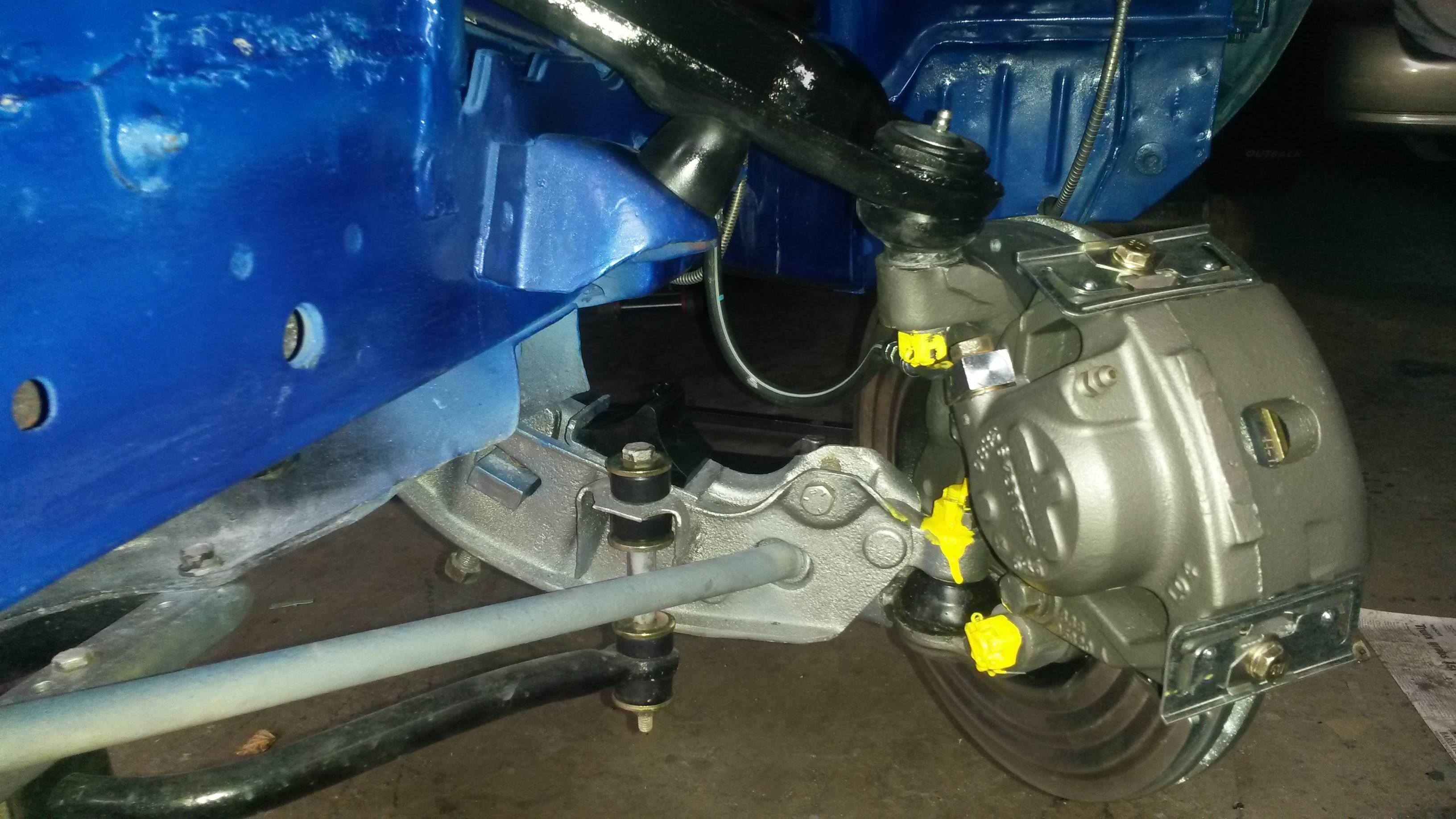

LOT to get the car stopped? No matter what you put on the the back the front does most of the work. Master cylinder not working? proportioning valve not working? Back wheel cylinders not working?Front brakes working?Or just need bleed?The Engineers already done the the work.do the maintenance.Or upgrade to a larger front rotor.
