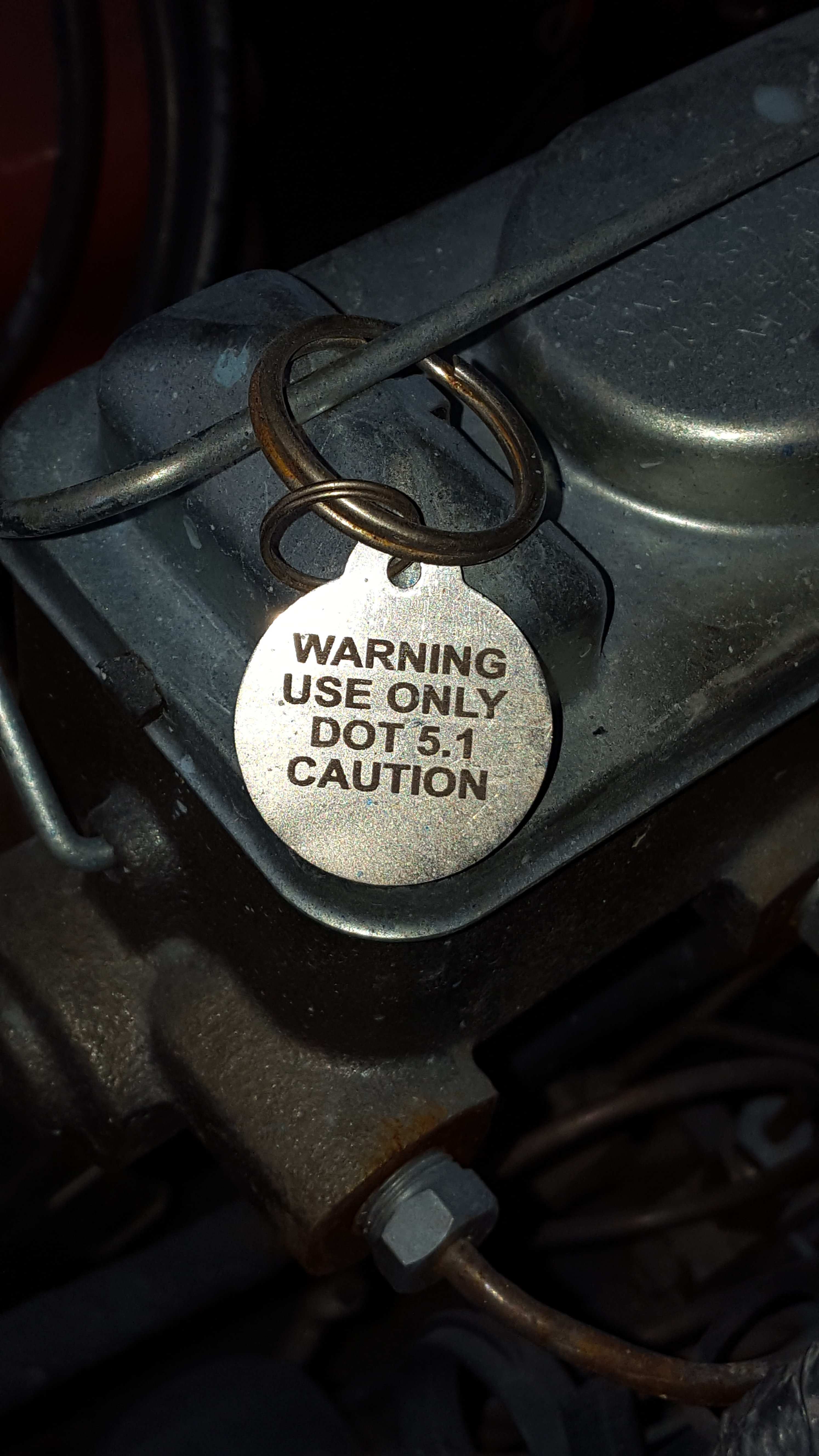

All the info above is good. Gone through all that BS of brake repairs many times. I have 3 or 4 new rolls of copper nickle laying around. For myself friends and family. I'll even fix an enemies brakes if need be. TRUST ME.;) I don't know if I have any enemies anymore. It's one thing for a limp it home repair it's an other when you have the time to fix it right. If not new take it all out and start over. When you have X amount in an classic, you put a little more care it to it. After redoing the brake system I came to the conclusion to use DOT 5.1 and mark it.
