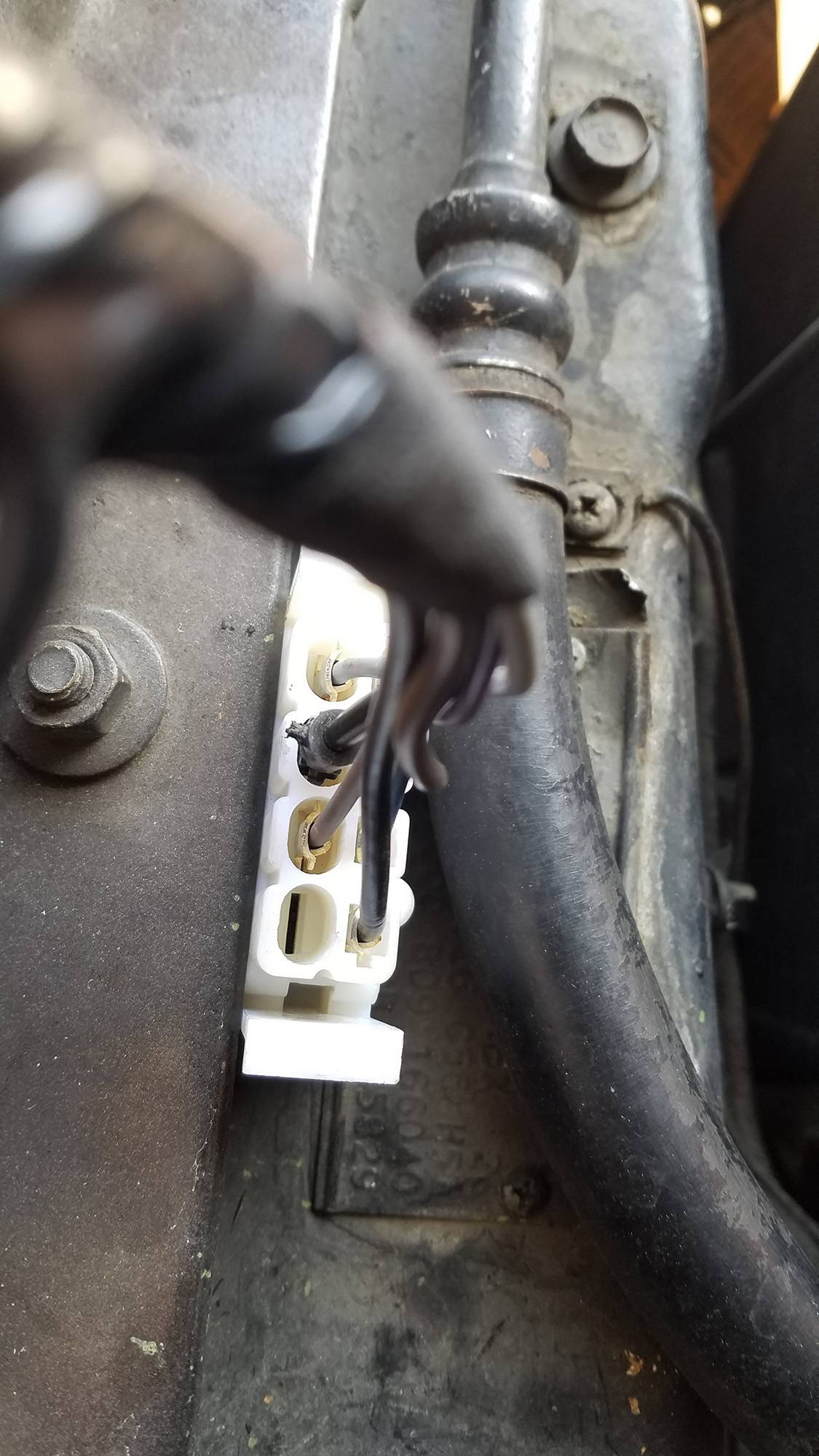

> on the Evans tab there is a blank on the bottom left of the tab (fig 1). On the OE there is a blue wire leading into the harness. (fig 2) Where/what is the blue wire I am missing?

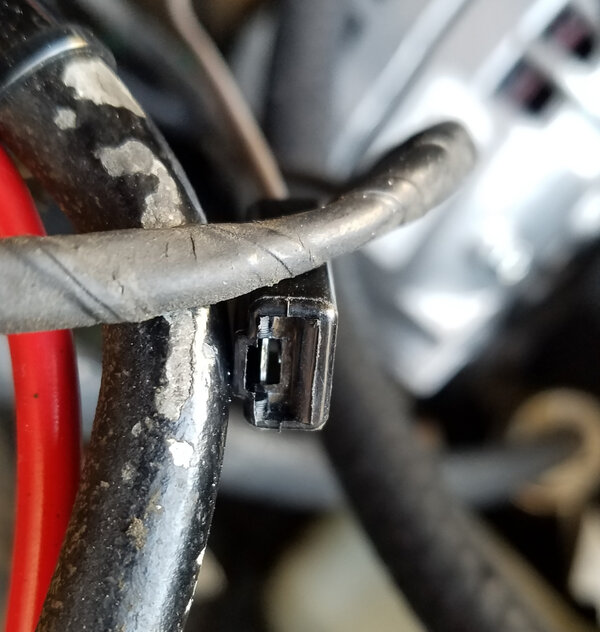

> On both harness there is a lead out immediately after the main plug (fig 3) this was not connected to anything on my car it was just hanging there. Where/what is this?

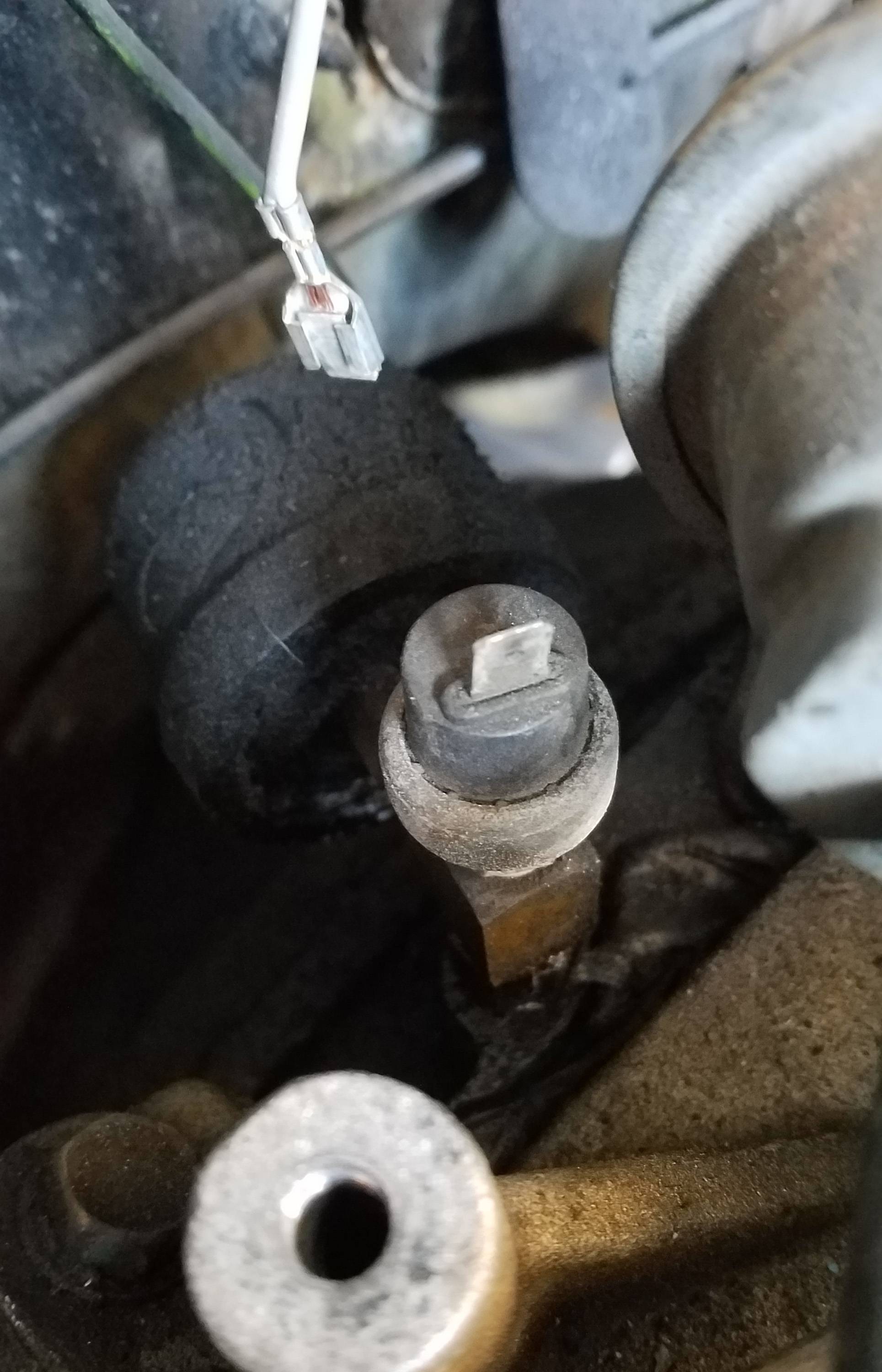

1. On the Evans harness there is a Gray wire that leads just below the 4 pin ballast resistor. (Fig gray1) There is a natural plug right next to it so I am pretty sure this one goes there. The Evans gray wire reaches but just barely, I will have to extend the wire about an inch to reach the connect. Also, what is this connection? It leads to a cylindrical piece that has a green wire attached, which is not connected from long ago.

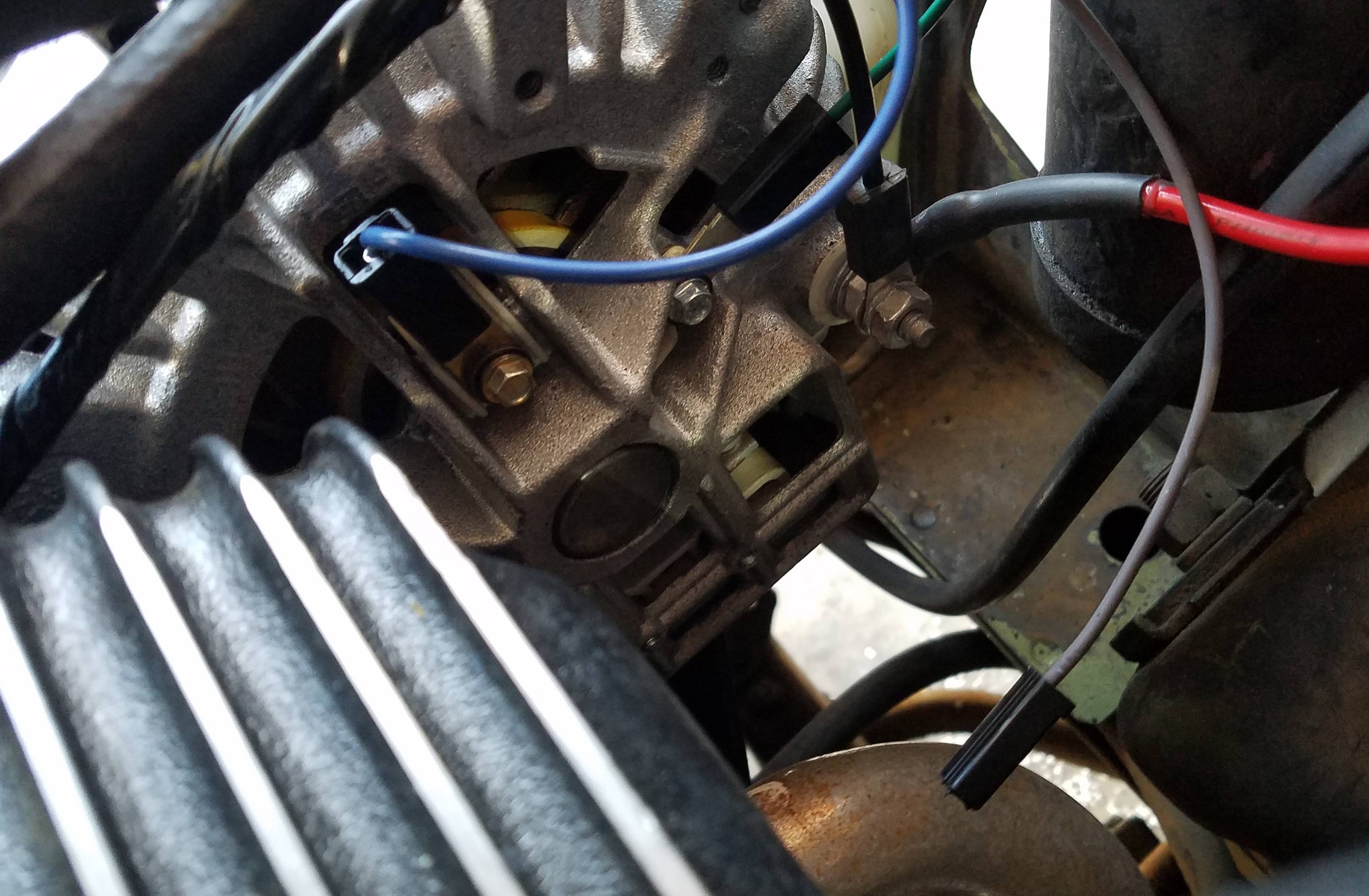

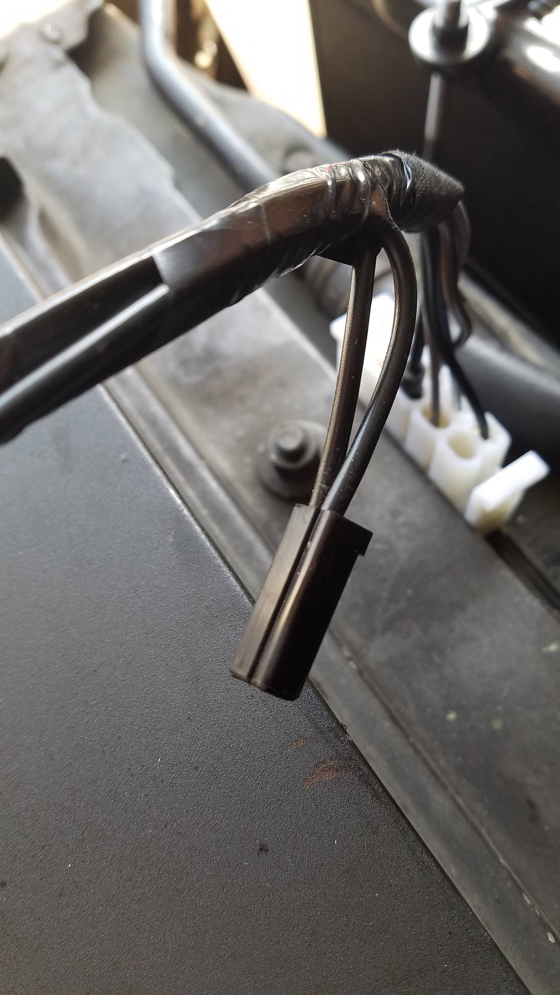

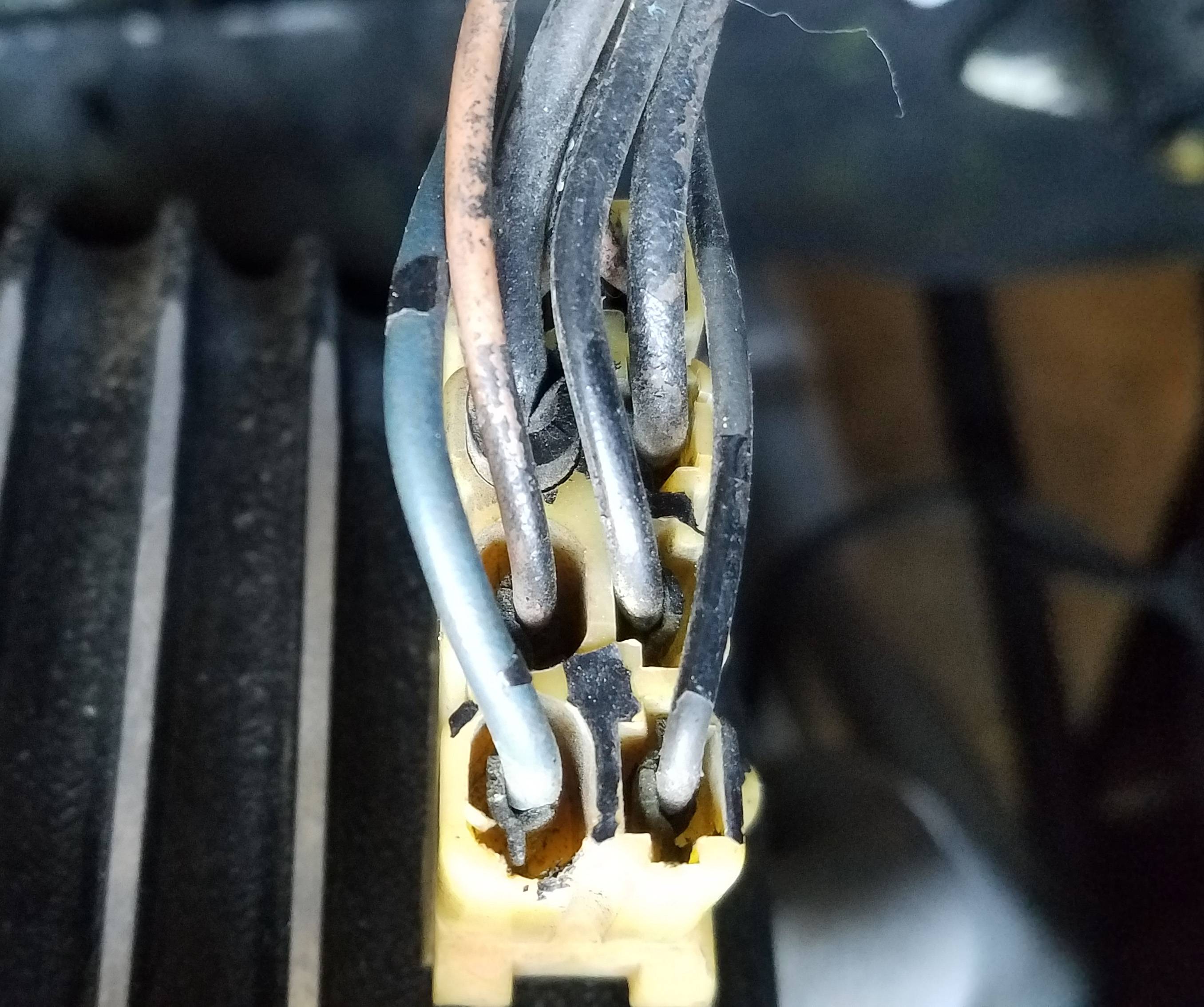

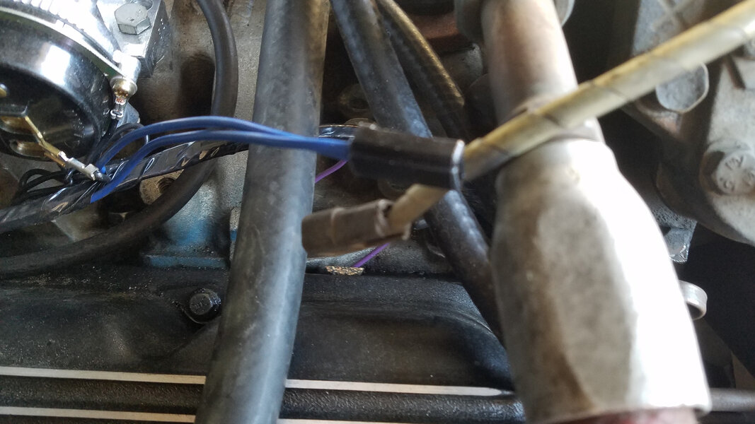

2. Next is the Brown wire that leads out with the alt wires. (fig brown-alt1) I have no natural connection for this. It also looks like a VERY small connector within the wire. (fig brown-alt2)
3. Lastly the blue wire that matches perfectly with the AC compressor connect (fig blue AC2). Likely plugs here but I am confused as the Blue wire in port 20 of the bulkhead connector is not there. It matches too well for it not be correct I would think. I will contact Evans on this if there is any doubt.

Grey wire with spade connector would be oil beside the dist on a small block or right at the rear on a big block
Brown wire should go across to the washer fluid bottle to run the pump .
not sure on the 3rd / blue wire
Thanks for the info! Hopefully the Brown wire is a key on hot. Going to use it for my elect choke. My washer bottle is manual.
I figured the Gray was oil. There is a Green that attaches on the back of that. Any idea what/where that goes? It was just hanging when I pulled the wiring.

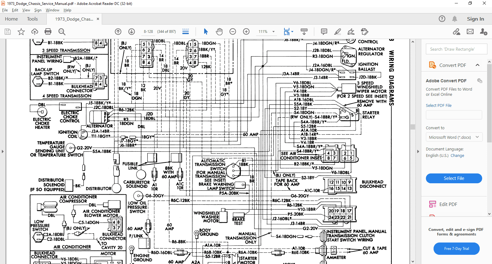

I don't see a green referenced on the '73 wiring diagram with the gray for the oil pressure switch.
Agree the brown is washer motor - it would be hot only when washer switch it pushed - if you don't have one its likely not connected to anything on the instrument side of the bulkhead. The wiring diagram shows choke heater through choke control from the dark blue ignition feed that goes to ballast, alt regulator and ignition module.
I think the Fig 3 in your first post might be the brake test connector - for testing brake warning light
