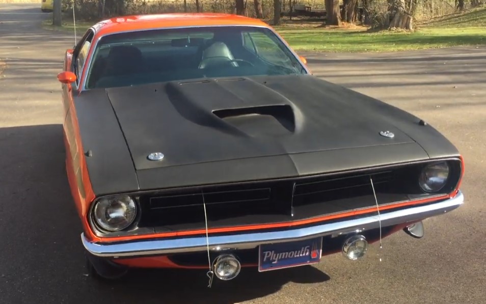

Did the AAR cuda have the fender turn signals ? I had bought one from the original owner back in the 80s and it didnt have them on the car. I see some cars do was it a option that im not aware of?

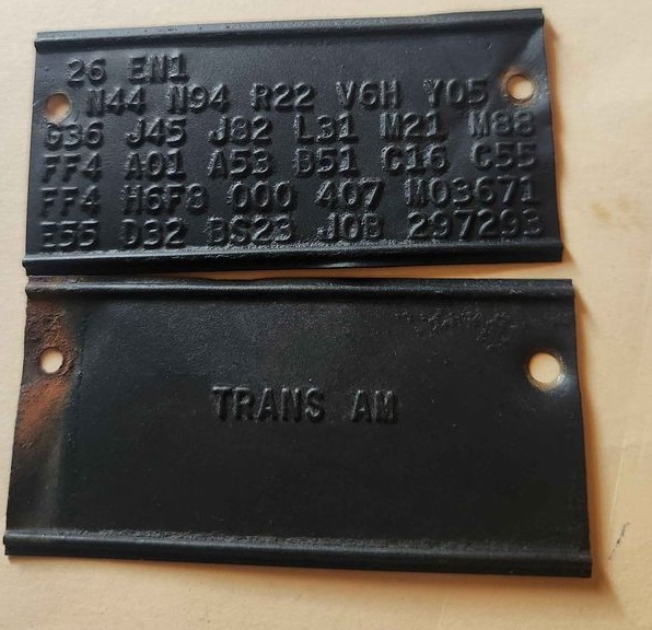

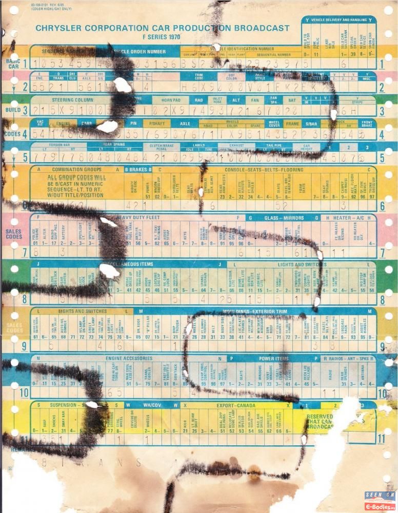

You can find the A01 code on Line 6 of the Broadcast Sheet and the L31 Fender-mounted turn signals on Line 8.

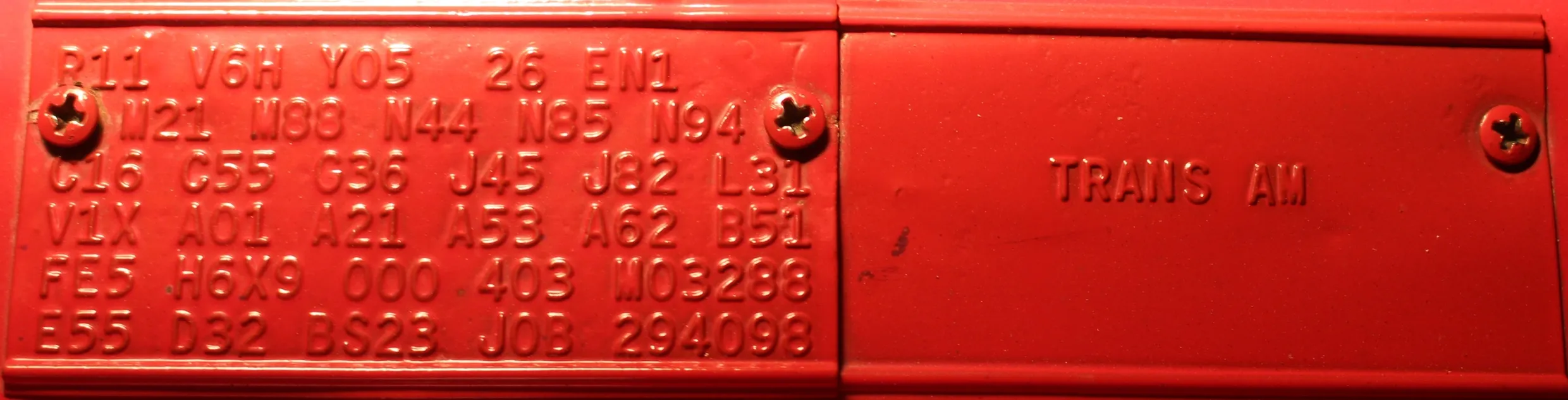

The AAR would receive the L31 Fender-mounted turn signals as part of the A01 - Light Package.

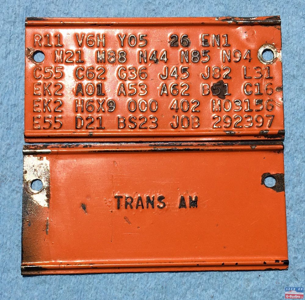

The AAR fender tag will include both A01 and L31.

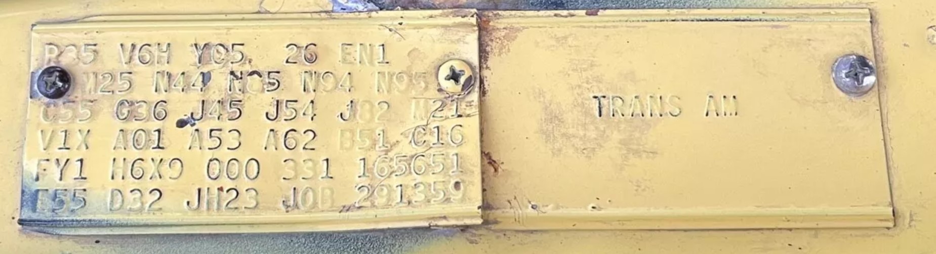

The T/A would NOT receive the L31 Fender-mounted turn signals even when optioned with A01 - Light Package.
The T/A fender tag will include A01 but will NOT have L31.
