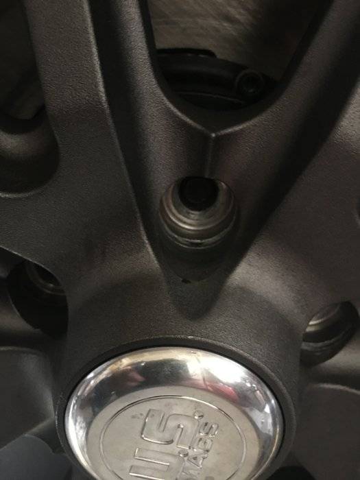

You will still need long shank lug nuts that almost reach the surface of the hub. With modern hardened studs, you torque the wheels to approximately 110 ft lbs. with a good quality torque wrench. After about 500 miles, re-torque the wheels. The aluminum will compress on initial install causing the lugs to come loose., You should be OK after initial re-torque.
