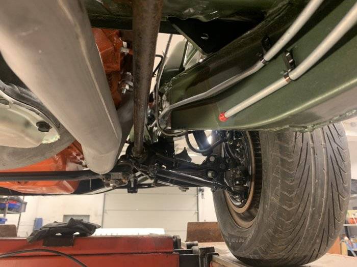

Need some advice.
I have new fuel and vapore lines. The fuel tube ends on the front frame rail, the vapor 27 inch longer.
Should the filter be placed on the framme rail originally?
Thanks!

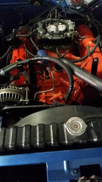

I didn't see what car you are referring to but I assume it's your shaker car. Here's my 71 Challenger shaker fuel filter setup. It's the original fuel lines. The filter isn't the original one but works.

Oh, and my steel fuel line to the fuel pump ends on the frame rail directly below the shock tower with about a 12 inch fuel hose from there to the fuel pump. This is a 340 engine.
Terry
