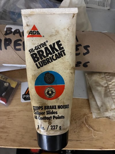

From my experience, install the sending unit while the tank is out. But if you don't, no big deal. Its not hard to install after the tank is in. Install the filler neck in the truck. Install the rubber filer neck grommet into the tank. Lubricate the filler neck grommet with a light sheen of brake grease. I used it because it does not deteriorate rubber. Then slide the tank into the filler neck, then the straps and J-bolts. Easy peasy, lemon squeeze.
