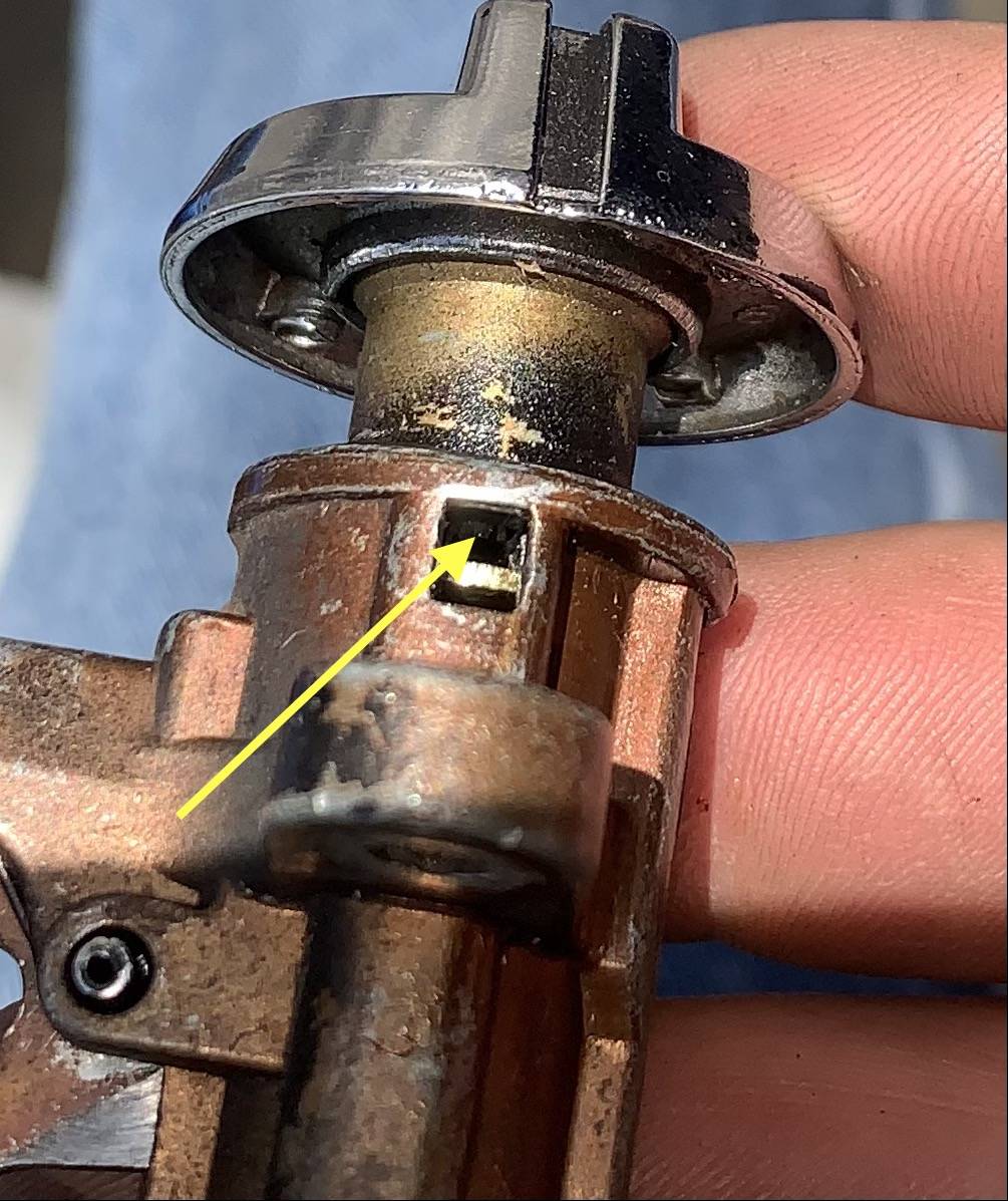

You might need to walk me through this if you don’t mind. Is this the tab I need to depress?
If so, nothing happens when I depress it. Is there something else I need to be doing to remove the cylinder?

it is hidden right behind the retaining collar you have to hook under the casting a little to access it

I think I found the tab, but when I depress it, nothing happens. Do I need to remove the spring at the end of the assembly?

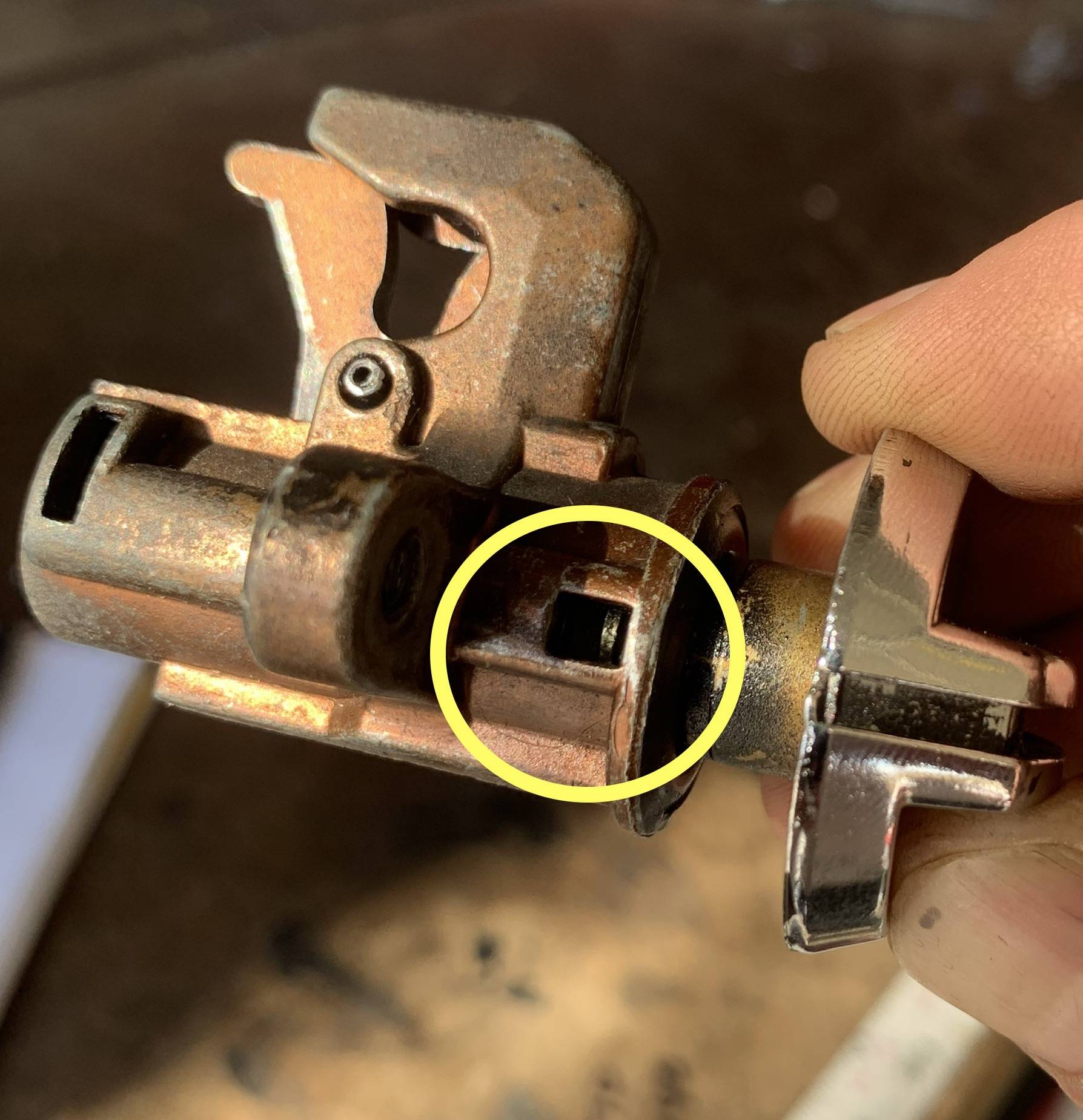

Okay. The tab I'm depressing is right here where the arrow is pointing.
The cylinder won't budge at all. That's why I was wondering if maybe there's something else in place keeping it from pulling out. I'll keep trying.

You can remove the spring pressure by holding the latch this could help .

I tried that. What if I removed the latch itself? I have a feeling there's something simple I'm not doing or not doing correctly....just need to figure out what it is. Thanks for your help so far.
