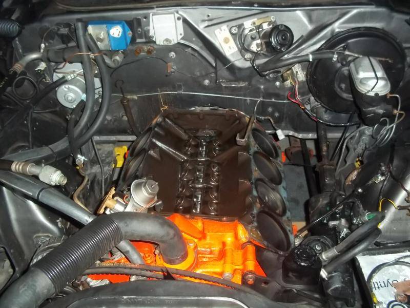

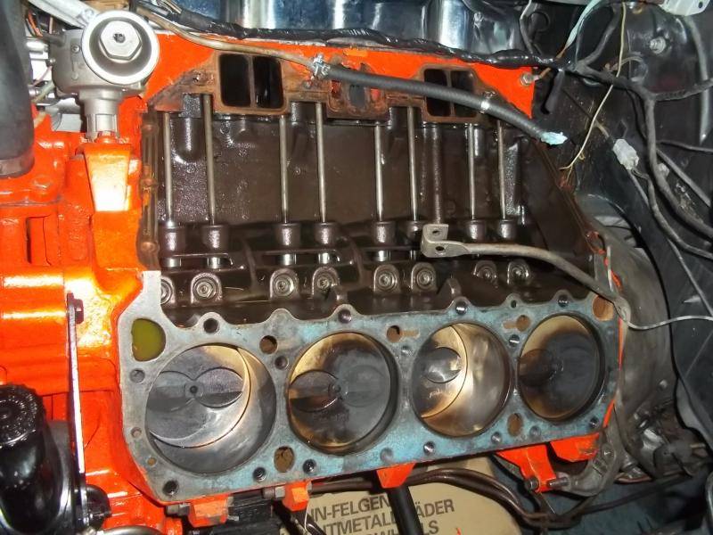

Heads are out! I did get some studs so I'll use as many as I can.
I've ordered a new intake manifold and carburetor too.
After taking the heads off I strongly considered new aluminum heads, these cast iron monstrosities are ridiculously heavy, but I don't really $1,500 right now...

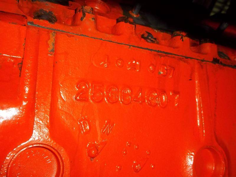

Turns out it is bored .03 over and appears to have forged pistons.
I did decide to go with time serts, thanks for the suggestion.
Pics below...

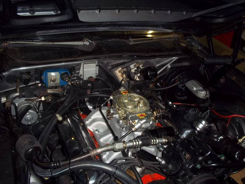

I got the RPM Performer intake and an AED HP 750.
The eddy was a little cheaper & the carburetor was recommended by the guy helping me with all this. He used them a bunch of times in the past and knows a couple of guys that work for them.
If I want to get rid of the AC I need to rework the belts, do I just reroute them or does an extra pulley need to be applied somewhere with new belts? I haven't decided if I want the AC yet; I won't use it, but it might be good to have someday.

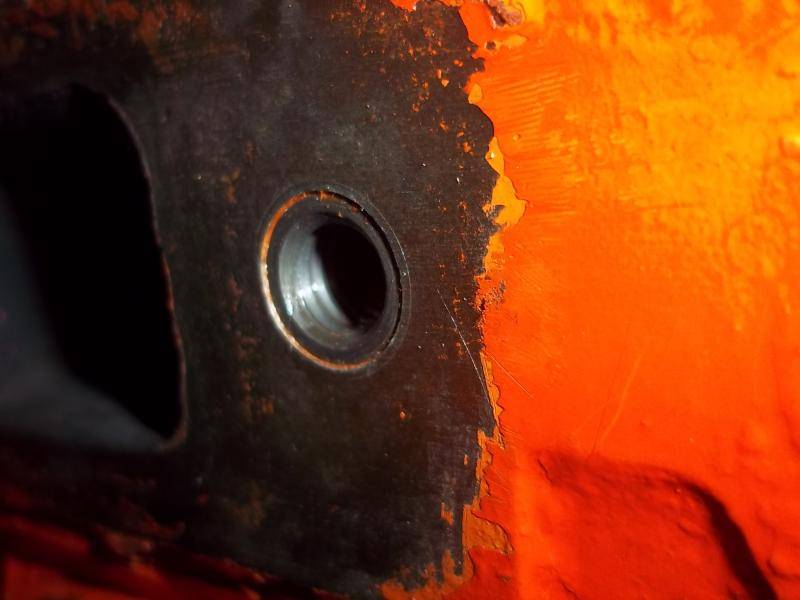

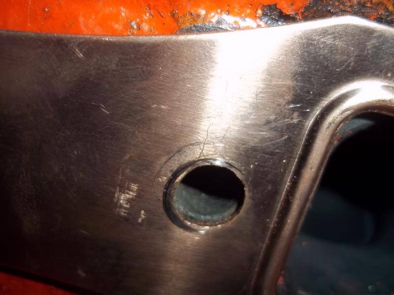

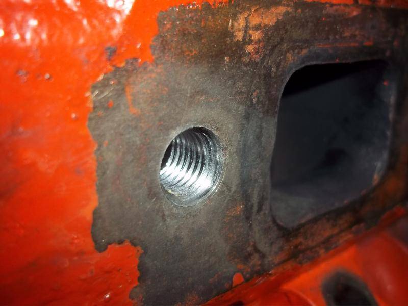

Time serts are in, everything is clean. Re-assembly starts Monday...Finally!
I put the time-serts in every hole, most of the threads were a little dull so, why not?
1st pic is before insert, after drill & tap.
2nd is with insert.

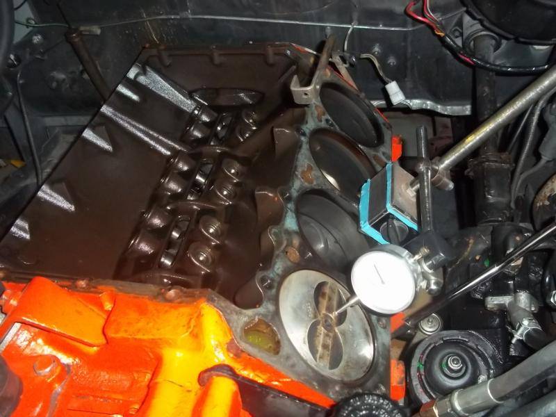

3rd finding TDC.
