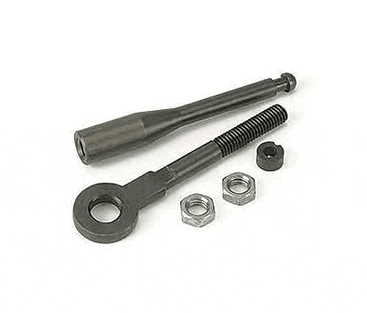

Bleed screws located at the top. Would there be a difference between the manual and power brake push rod.
I don't have an exact measurement as I have manual disc brakes, and my push rod is 7 1/4 so the power one will be longer. Mancini racing sells ajustable push rods!
the pusrod is attached to the booster wit power brakes & uses a unique mechanism between the pedal & booster .
