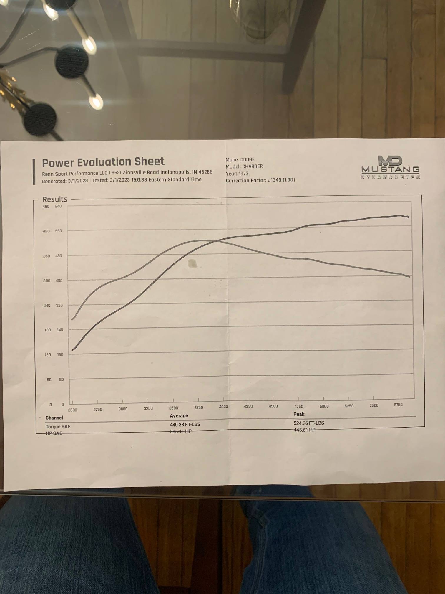

I posted my engine dyno sheet in our forum. It made 665hp at 5800 and 691tq at 4500. Put the car on the dyno with full trim and it only made 480hp at 5800. That's a massive lost guys! 400/512 stroker with trickflow 240 heads 10.5cr.

Before number 6 wasn't firing. I also installed new tti headers and exhaust. (2'-1/8" step headers and 3 exhaust). Got a better tune setup. I'll let you guys know how it goes.

Went to the dyno today! This shop had a Mustang Dyno. Not sure why it made more torque than horsepower. The AF ran around 12.5-14. I was running 38 degrees of timing. I added new tti step headers and 3" exhaust since the last dyno. I guys at the shop think that my converter is killing the horsepower. I have a 3800 stall. (524 ft-lbs/445hp at 5850rpm)

The way to know is to look at the MPH of the rollers and see if the MPH slows down but the RPM continues to rise.
A dud converter will show up like a slipping clutch would with a manual transmission.

Would it be safe to say that using the horsepower to torque calculator that my dyno reading of 525 ft -lbs at 5850 rpms equals 584.8 hp at the wheel?
