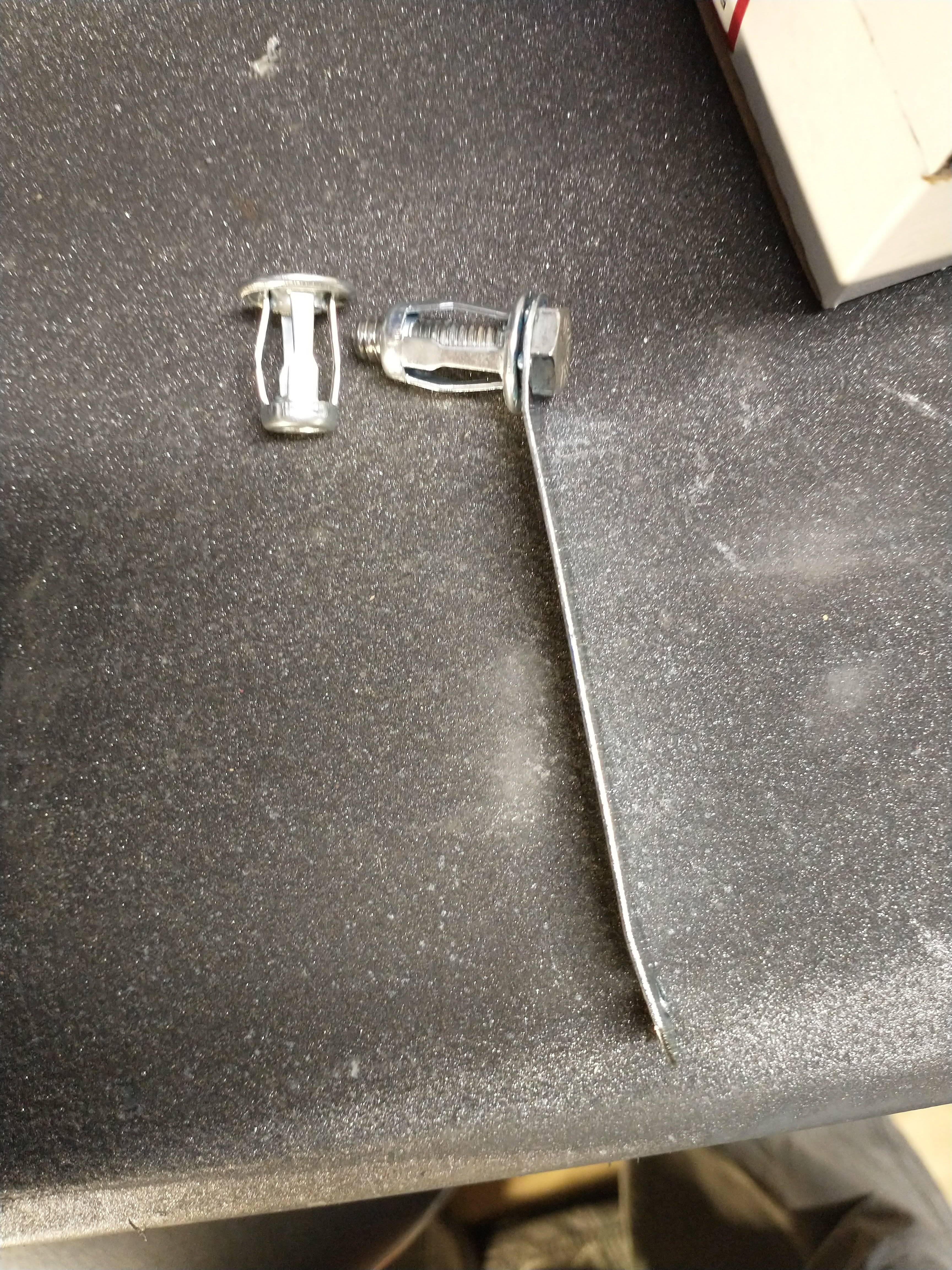

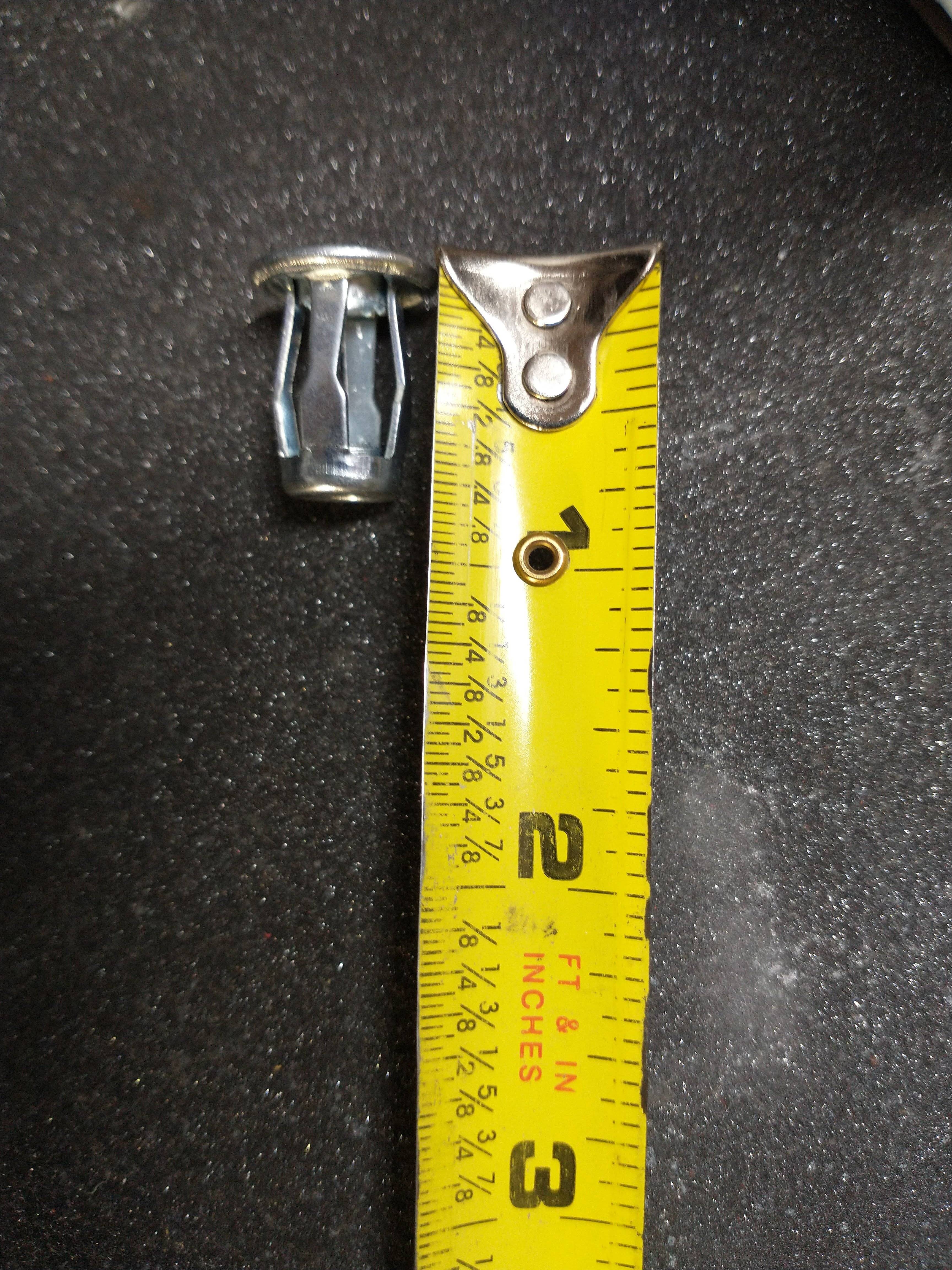

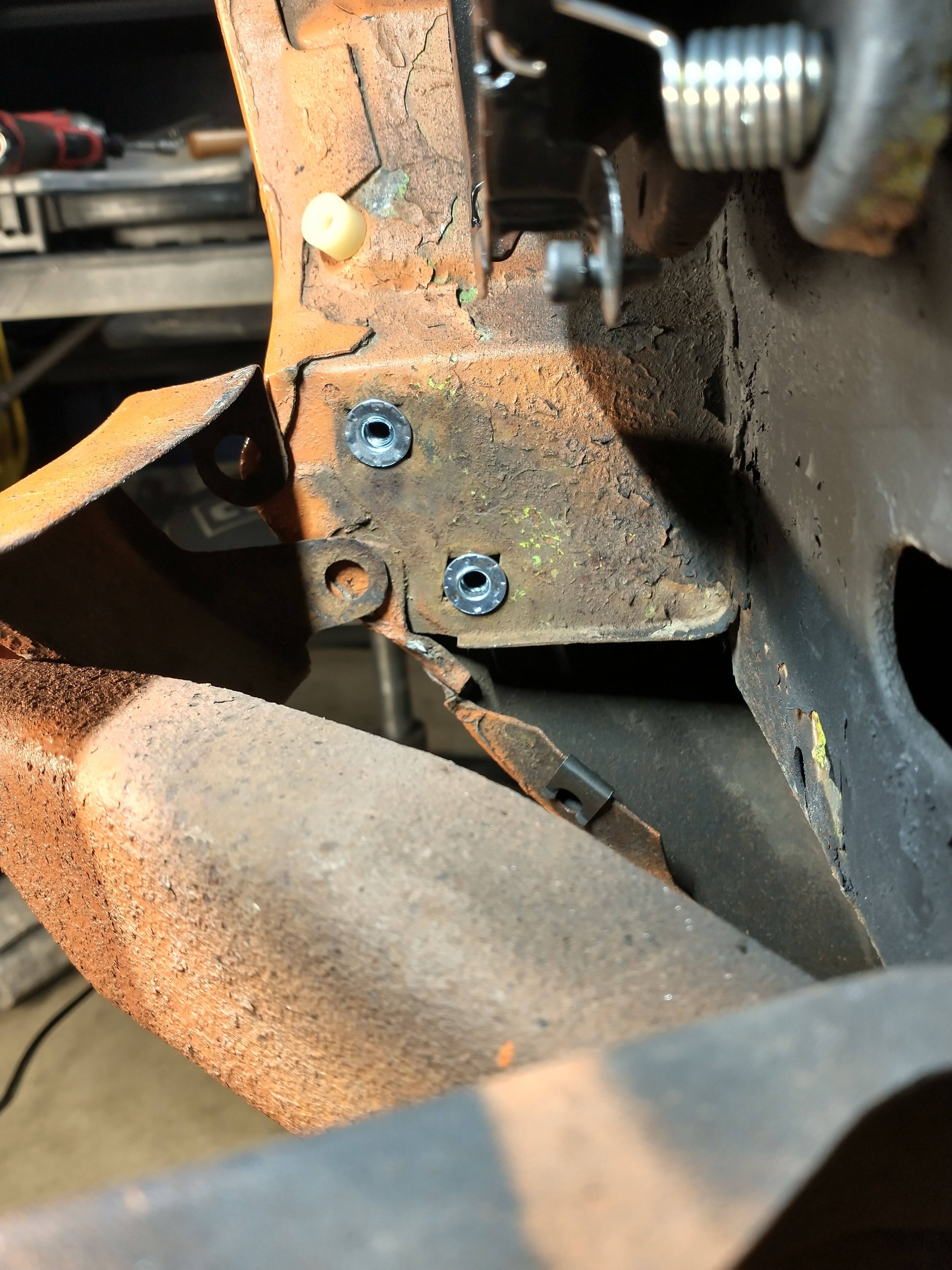

One way to fix the missing or stripped out nuts attaching the header panel to the fender. I used flange nuts. These happened to be 1/4"-20 flange nuts. I tried nutserts but the flange was too small and they slipped out of the square holes in the fender.
