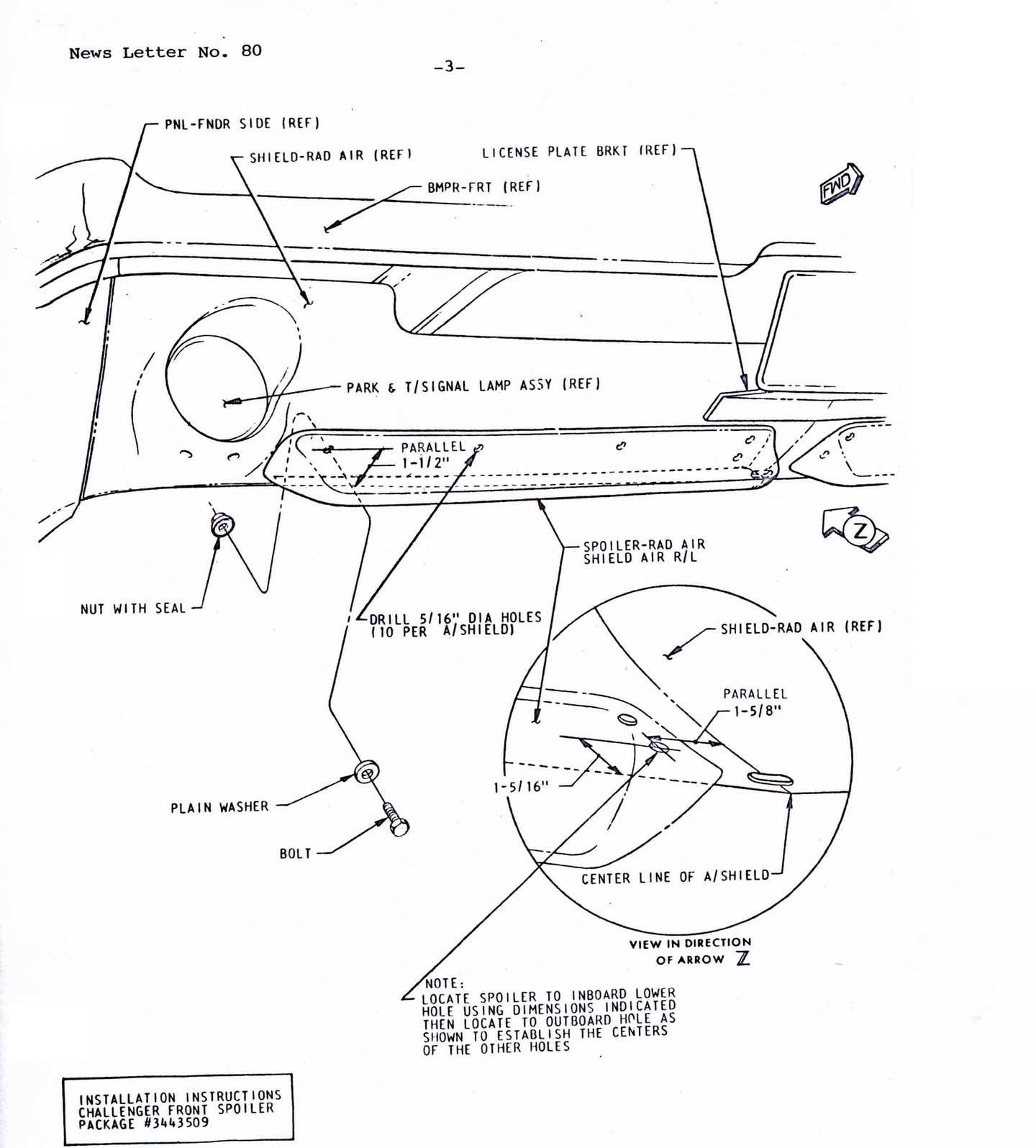

Here’s the install instructions Chrysler provided to dealers (from Barry Washington’s website):
https://www.hamtramck-historical.com/images/dealerships/DealershipLetters/1970 Dodge Newsletter No. 80 p3.jpg
NEWS LETTER #80 from April 7, 1970.
1970 Dodge Newsletter No. 80 p1 TA Front Spoiler & Exhaust Installation Memo.jpg
1970 Dodge Newsletter No. 80 p3 TA Front Spoiler Installation Instructions.jpg

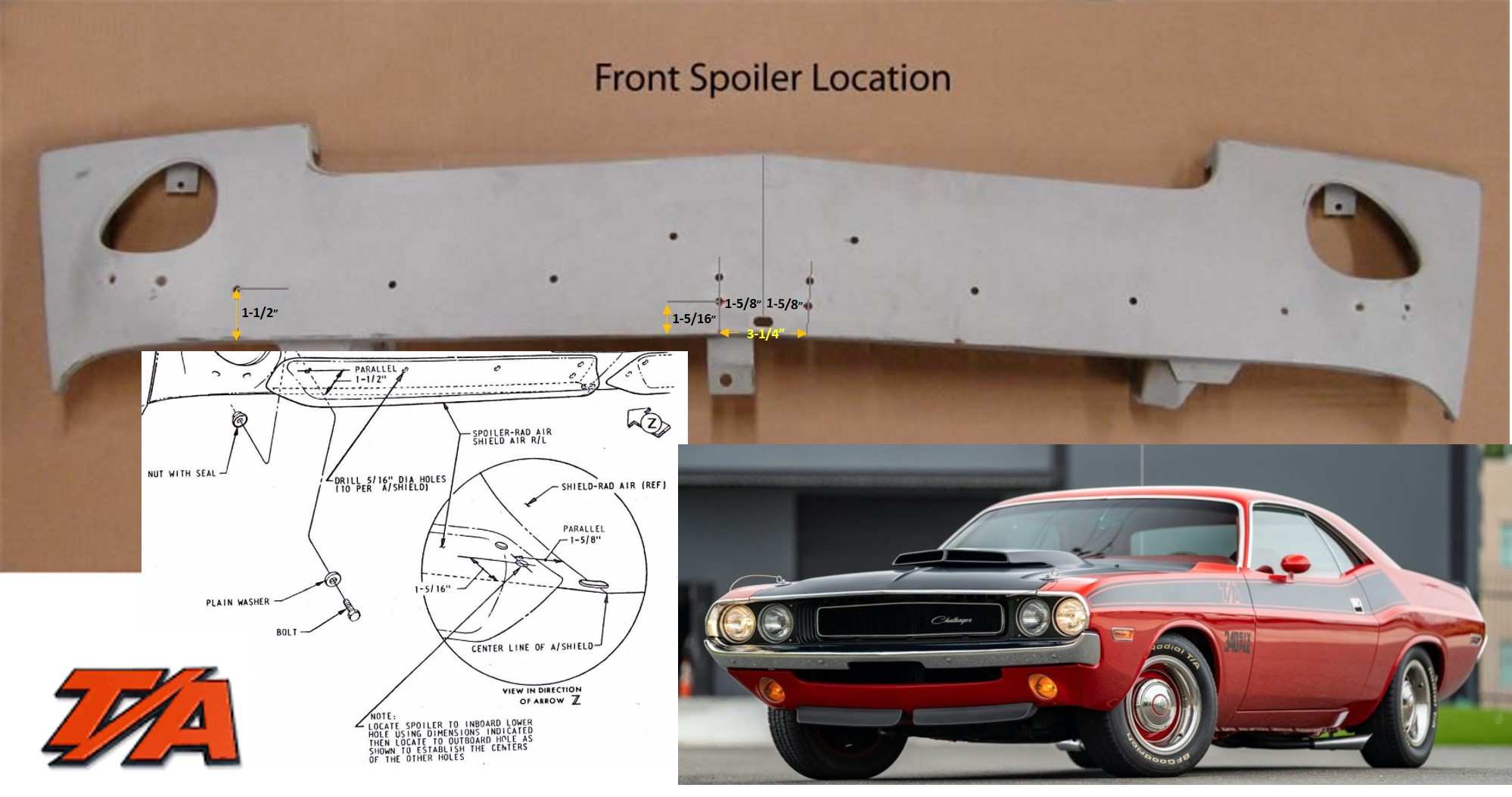

Updated the front valance picture with the correct measurements as per the engineering drawing.
