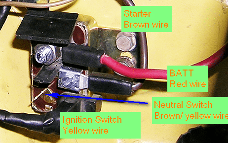

Anyone have pic of their relay ? My car doesn’t have one . I got all new wires and cables and relay but not seeing in pics how to hook it up and don’t want to assume it’s the same as my duster
