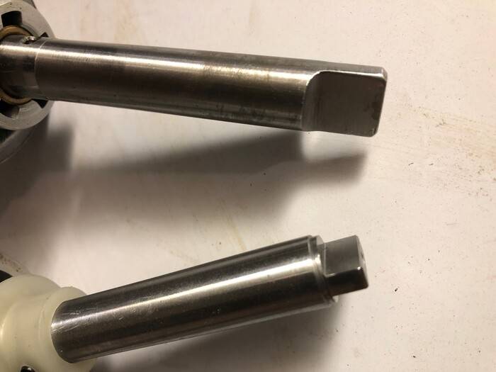

Hi All,
The new Mopar aftermarket distributor I ordered in from Mancini won't seat into the bushing/gear... The old one (also Mopar aftermarket, just about 12 years old) was tapered. I called them up and confirmed I ordered the one for an LA block. The shafts are the same lengths and the length under the housings is the same. The engagement length of the tapered tooth is approximately .510" vs only .230" on the tooth with the square shoulder.
What am I looking at here, exactly? Mislabeled box for some other Mopar application, or did they just cut the shaft wrong on this thing?

The new one "looks" wrong to me. Can you send it back?
The old one looks like both my distributors. I have OE electronic and MSD.

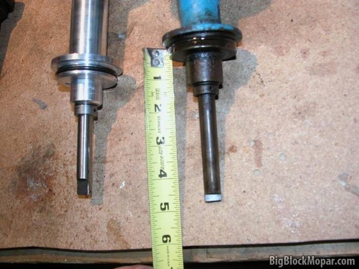

The picture looks like 2 different shaft lengths. RB distributor shaft is longer.
Thanks for measuring those out!
These are actually the same length from the hole where you pin the collar to the base of the tooth that meets the gear. It is admittedly kind of hard to tell from the pic but I did take a mic to them both. I'm thinking it was just misboxed and am going to check back in with Mancini tomorrow. I talked to some buddies of mine who also have LA engines and theirs are like the one I pulled out too.
