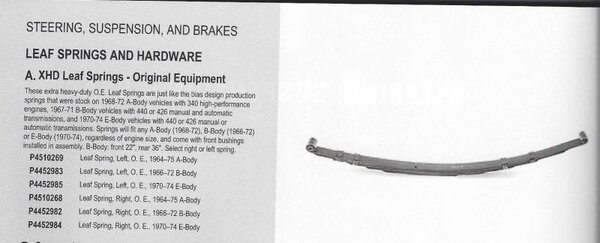

Gentlemen, and ladies if there are any on this forum - my question is concerning the orientation of the leaf springs on the car.
I have a '70 Challenger R/T SE that I've been driving and wrenching on for quite some time now. Prior to my ownership someone installed a set of MP XHD leaf springs on the rear, I happened to notice the P/N's one time when I was under the car working on something entirely different than the rear suspension. Of course, being me I had to check my reference books just to verify what they had done. Well, this is where the problem comes in. My interpretation of the P/N's is that the '985 spring should be on the driver's side and the '984 belongs on the passenger side. Of course this is totally opposite of the way the previous owner installed the springs.
Now, as far as street driving is concerned, I do NOT notice any problems nor does the car appear to sit improperly. Perhaps if I raced the car I might notice the car squatting more than it should on one side or the other, but I don't race it and probably never will. The problem is that I "think" the springs are reversed side to side, and that is what bothers me about it.
So, with Mopar's XHD leaf springs, P/N P4452984 (Right) and P/N P4452985 (Left) which one is Driver's side and which one is Passenger side?

They call right and left as if you were sitting in the drivers seat facing the front of the car. Right = Passenger side and Left = Drivers side. You are correct in your interpretation.

That's exactly what I thought. So, this means they ARE installed on the wrong sides. Is there a benefit to be gained by switching them back to the correct positions? And is that benefit worth the trouble and effort to move them?
After looking them over more closely, they both appear to be 5 1/2 leaves each. The difference is the 1/2 leaf is to the forward segment on one spring and to the rear segment on the other spring.

My original 71 Chally R/T had an extra 1/2 leaf on the driver's side, facing forward.

The extra half leaf controls the car from following the engine torque to one side under hard acceleration. I wouldn't say it hurts your car the way it is. It just doesn't take advantage of the suspension you have. If it were my car, I would switch the springs to where they should be.
