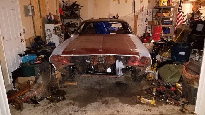

You and I have the same housekeeper! Garagekeeper? LOL
tonysrt
Mar 12, 2017
632
203
The reason mine looks like that is after a job I'm too tired to put everything away. The other day on my wife's car I changed the oil, rotors and brake pads and rotated the tires. After completion I had to take a nap.I just don't bounce back like when I was 50, now that I'm 71.
quapman
878
227
My problem is that I'm busy trying to get the next job going before cleaning up from the last one.

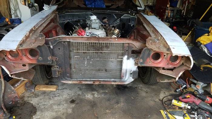

Apparently a radiator from a 5.7 hemi truck fits pretty well, and it has the correct output location. Ive got to saw some plastic brackets off of it to make it fit better but the core and the end tanks clear everything. I got the starter installed and wow is there a diference in size and weight. I think i might be able to start it this week drinking out of a gas can but i still need to weld some stuff and install a seat, brakes, and a driveshaft to drive it around the neighborhood. Hopefully the sheriff who lives down the street is a mopar guy because ive got open headers and no lights.
bullet18
Jan 4, 2017
311
97
I got the radiator mocked up and its nearly a perfect fit. Im gonna have to modify the core support a little to take full advantage of the core size but i would have had to do that if i got a stock 26 inch rad because my car has the 22 inch rad core support.

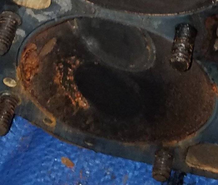

Does anyone think this could be a cracked cylinder head? Im honestly hoping it is because that would mean it probably doesn't have a cracked block and i can probably fix it with jb weld until i get enough money for 906s.
tonysrt
Mar 12, 2017
632
203
If you plan on using this block have it sonic checked. Also have the heads checked. It is a lot of work to reinstall motor & trans and find out you have a problem. I know your on a budget but this will be money well spent and also give you peace of mind when you get it all back together.
bullet18
Jan 4, 2017
311
97
Unfortunately were past being able to sonic check the block and heads with the engine in the car and assembled. I will definetely do that in the future.
Adam
Dec 25, 2012
1,694
759
Washington
Just turn the engine over by hand and take a close look at the cylinder walls.
Don’t put JB weld on... waste of time & effort. Go to a junkyard and pull the heads off an old motor home.
bullet18
Jan 4, 2017
311
97
I looked when i had the engine apart and didnt see anything but its still making me nervous.
