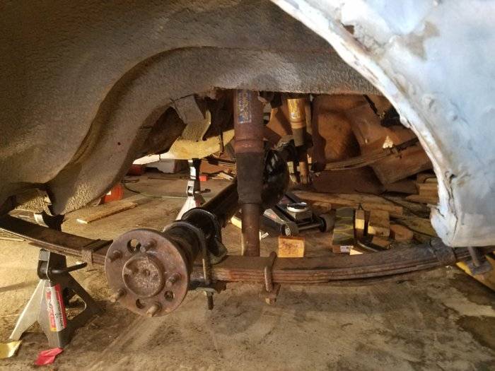

I took awhile to do by myself but the rear end is in now.

Good job on getting the rear axle and springs back in. I notice that you have some old air shocks, are you going to keep them? Check the top mounting area as air shocks can cause some pretty significant damage (cracking) at the top bolt hole areas.

Im keeping them just for driving around my neighborhood. Ill change them before i exceed 30 mph, theyre pretty wasted. There arent any cracks in the shock crossmember as far as i can see but ill look out for them when i change the shocks over.

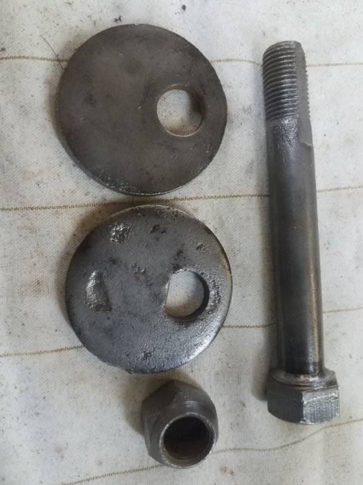

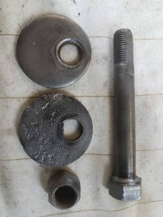

The car came with the original black interior parts haphazardly thrown in the car so im gonna use those. I also have a rather faded burnt orange hood but i can clean it up. Right now im just worried about getting it running and after that ive got to get it street legal. The car has no title so im pretty sure i need to have it inspected which means it needs headlights, taillights, a horn and indicators so interior isnt a very high priority quite yet. I do need a new camber adjuster bolt and elliptical washers if you have some and are willing to sell them. Thanks.

Not to step on anyone's toes here, but the top washer with the round hole should be fuse welded to the cam bolt head. It has spun so now there is no way that the back washer will rotate for adjustment. I guess you could put a couple of small spot welds on the bolt head to washer.

Yes I can't believe I missed that the others I have are ok.

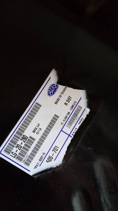

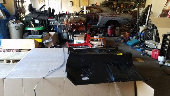

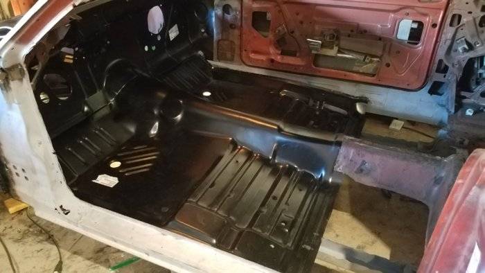

Well it took 5 weeks but the floor finally got here. I bought it from classic 2 current fabrication out of detroit and suprise suprise its made by CHL. Hopefully i can get it welded in this weekend. It seems to fit ok after some minor hammering but thats to be expected from a taiwanese part. The subframe connectors are gonna need some extensive grinding to get it to fit properly but i was expecting that. Ill post more updates as i make progress.

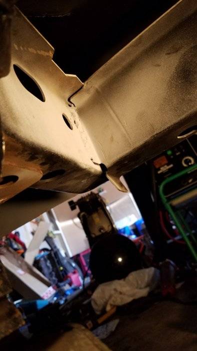

Heres another example of laughably poor Taiwanese stamping errors. The frame rail tab is bent more than 90 degrees off. I would have thought it happened during shipping but they shipped it laying flat and the bend is perfectly uniform.

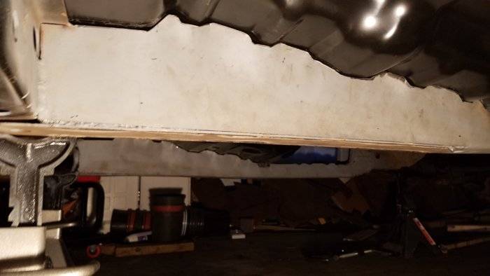

It took all weekend but i finally got the floor tacked in. Im pretty sure the subframe connectors were cut with the left pattern on the right connector and vis versa but it wasnt that big of a problem. The flanges that attach to the inner rocker panels are way off but i can fix that with a few hours of hammering and after i put carpet in you wont be able to tell.
