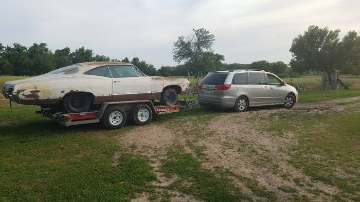

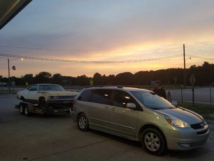

Its looking more and more like im gonna need a new engine but im gonna wait until i get another starter monday to make any decisions. On an unrelated note to the challenger, my friend and i drove to nebraska to get his dream car, a 67 impala. We rented a Uhaul trailer hooked it up to my dads 2004 toyota sienna and headed west. At the time we thought that it has rated to tow 7700lbs which didn't seem as exceptionally high at the time as we had tunnel vision and no experience with towing. It turns out it's 7700lbs including the weight if the mini van. We found that out on i-96 in michigan on the way back after about 1500 miles. Luckily we went over the flatest states in the country and didnt grenade the transmission. We reached a top speed of 50 miles an hour on the freeway on the way back. We definetely will not do this again knowing the actual towing rating of the van and how lucky we had to be not to break anything on the way back but it makes one hell of a story.

You are lucky not to wreck , I have seen too many bad towing results with everything upside down in the ditch

I’m quite sure you took a few thousand miles off the life of that Toyota but that will be a trip to remember. I’m definitely responsible for shortening the useful life of several of my dads vehicles back in the day....:cool:

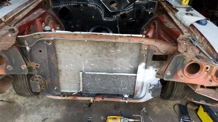

I finally got the brakes on! I also got the radiator and trans cooler mounted. Im getting all of the little stuff knocked out this week before i get the engine so after i put it in it wont be that long before i actually drive it. I still need a lot of little stuff(and some big stuff like installing a seat and a steering column) But im making a lot of progress.

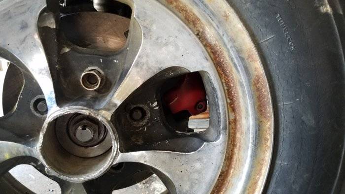

I like that wheel, do you have a full set? maybe just clean the rust off with some steel wool and put a coat of clear on them to stop the rust or see if some chrome dress rings will clip on and cover the rust.

It looks like a Keystone Classic.

Yeah theyre keystones. Unfortunately theyre 14x6s and im looking for 235s up front and 275s in the rear. Ive got 2 keystones and 2 cragar s/s rims all 14x6s. Ive already got some us wheel crawlers that are basically a cragar soft 8 knock off. Ive got no idea how theyll look but they're wide enough and cheap so theyll work. Dont worry ive got the correct backspacing. Im planning on running cooper cobra radial g/ts 275/60r15s in the back and 235/70r15s in the front.
