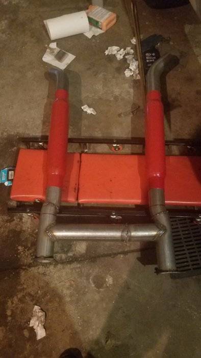

I am, ive got the h pipe fabbed up and half welded. Hope fully 2 24 inch glass packs and an h pipe will quiet it down enough. Im gonna have the pipes exit right in front of the rear tire so i dont have to bend it over the rear axle.

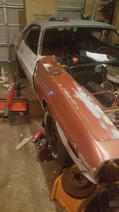

We've been working on the exhaust and its turned out pretty well so far. Fabing the h pipe involved a lot of trig to get all the pipes to line up but i got it. I put the glasspacks in the right way so hopefully the car isn't deafening anymore. Also im gradually stripping the primer off of the body panels, the paint underneathisnt great, but its better than "hi mom". We're having some issues with the radiator right now but we're making progress.

It's still pretty freaking loud even with the glasspacks but its at least close to manageable. I'm gonna try to fab up an exhaust tip that reduces the pressures of the exhaust pulses as they leave the pipes. I still need to run some pipes to the final exit in front of the rear tires so maybe that will quiet it down some in addition to getting the collector flanges to seal correctly. I dont think i can fit even a 12 inch glass pack between the elbow and the exit so im gonna have to get creative.

I generally use a pair of turbo mufflers in the pockets under the back seat. You can always toss on a pair of turndowns if you're not going over the axle. Summit or Autozone have them pretty cheap. $30ish each?

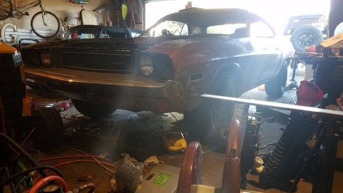

Over spring break i got the gaa tank and dash in along with getting the front end together and doing a bunch of wiring. 2 weeks from now i should be able to get the windshield in and the new mufflers on to drive it around. We're getting pretty close to road legality.
