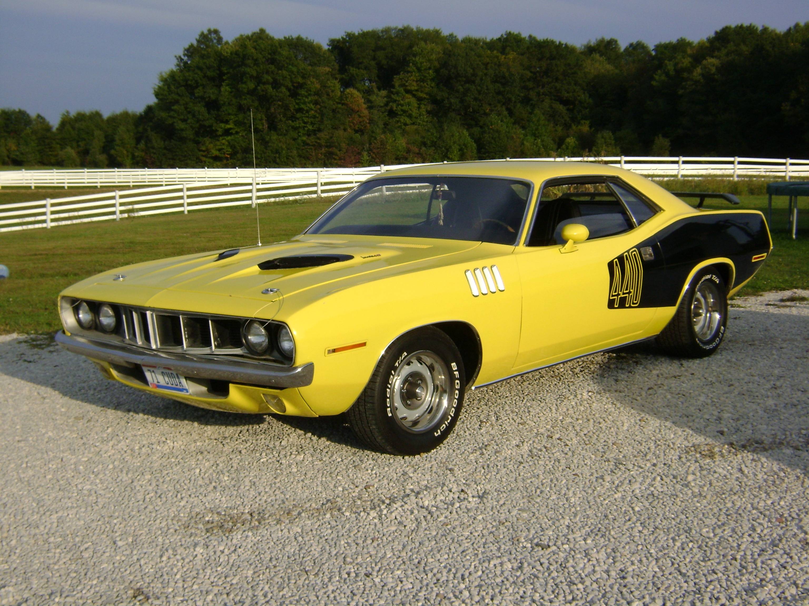

Hello everyone,
Have had a 71 Cuda for about 30 years now, finally going to restore it. It's not a high dollar car but I love it. It was an original 340 car, but had a 318 when I got it. I put a 440 in it and have driven it ever since.
Any advice on Do's and Dont's of restoration?

Welcome to the site from the Motor City! Is that what you want it to look like when it’s finished?
Mopar426
You have a really great looking 71 Cuda.
Good people here with plenty of experiential knowledge on our cars.
Good luck with the changes you are contemplating!
Welcome from Arkansas! Lots of good information from the guys. I to agree with the above. Nice ride!
