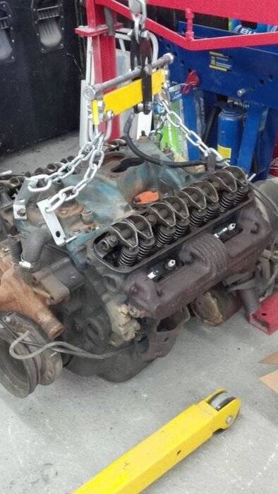

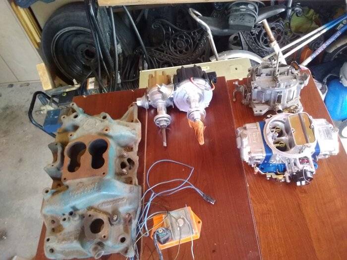

I have a 1971 Plymouth Satellite with the factory 318. I have received a Holley 650 ultra double pumper part number 76650 BL which if I can make it work reliably I would like to use on my setup. I also have a four barrel intake from what I believe is a police interceptor 360 part number 4100340.
I need to figure out if I can make this combination work. The carb is a square bore and the intake is a spread bore I've heard that you can get an adapter. I also have a skip White HEI distributor with included coil part number JM 6513 BK. I was trying to install it with my factory air filter, but there is contact and I would need to cut the air cleaner assembly, with MagnaFlow mufflers. I was thinking of getting a mild cam again not sure what I should look at. I also have a Rochester quadrajet that came with the intake. It had been used on a 318 out of a 68 satellite, however the engine and intake were not factory. One other thing tl mention is I do have a Mopar Orange box and electronic distributor that came with that engine as well. almost forgot I also have a

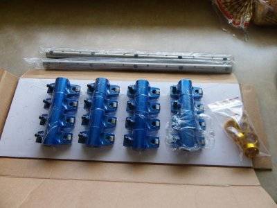

Proform Extruded Aluminum Roller Rocker Arm - 1.5 Ratio. The car sat for a long time but runs good except for smoke on start up which I expect is from the intake valve seats. I am wondering if the newer heads would have hardened seats. The engine that came off of is a 1976 to 1984 318. The Exhaust manifoldsImanifolds are marked 77. I have included pictures of the parts. I have not checked the camshaft information on that engine either, not sure if it would be an upgrade or not. It's still in the engine.
I look forward to your suggestions thank you for your time.

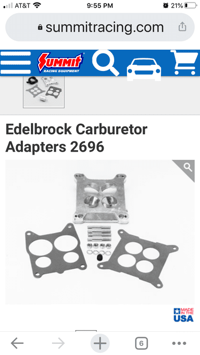

How much power you looking for? Budget? Here’s an inexpensive adapter for the carb. Just depends on what you want the end results to be. A mild voodoo cam would be nice. But, transmission, rear gears etc. need to be thought about.

I agree with the other recommendations regarding the cam and intake. You can do a lot better than that cast iron spreadbore.

If you still decide to use the stock heads ( after a valve job and guide replacement) check the intake port size alignment between the 360 intake and cylinder head using a new intake manifold gasket and a scribe to mark the port outline.
No reason in the world to install the rockers. Absolutely no advantage, just looks at this point.
Double pumper carb is not really a street carb. Too much fuel very time you push down on the accelerator. Designed really for bigger cams/ breathing hot engine set up, to cover up secondary bogging on standing starts. Stay as close to stock as you can. Remember that the more you modify, the more you Have to modify.
Save the eye candy (roller rockers etc...) for a better build.
Sell the carb, HEI style distributor, rockers . This will help pay for the heads and proper carb set-up. Get an Edelbrock AFB or AVS clone carb. Much closer to what the factory out on and no mickey mouse linkages . All bolt on parts. If you decide to take a chance and run the Orange box, make sure to have a back-up in the trunk.
