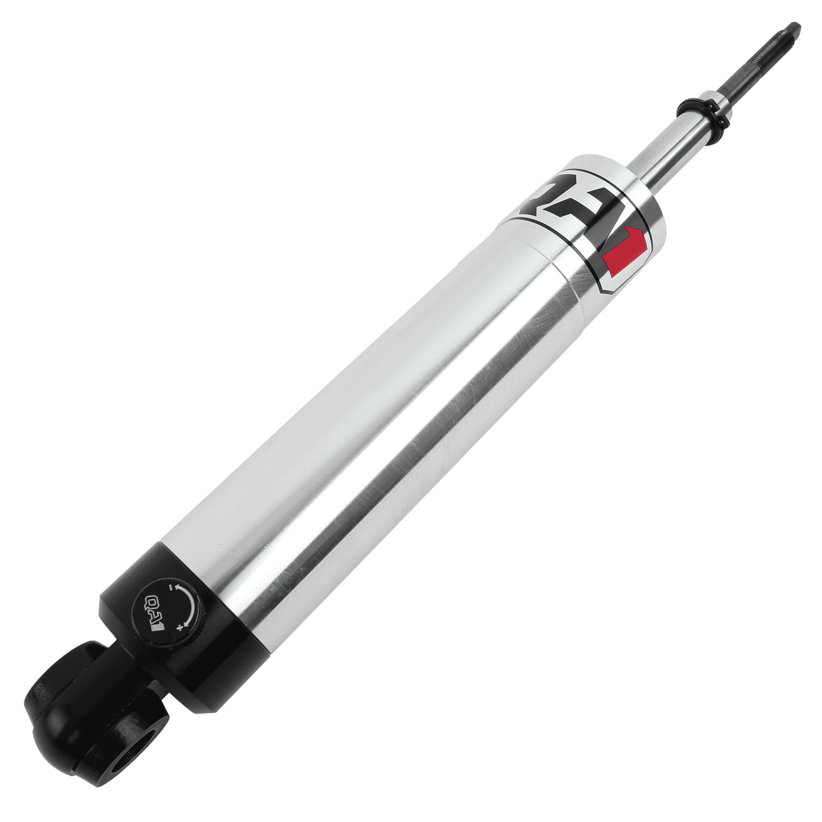

Finally I'm going to put some Decent Front Shock on my 70 R/T
Thanks Chryco Psycho.
QA1 TS501 Shock Absorber
