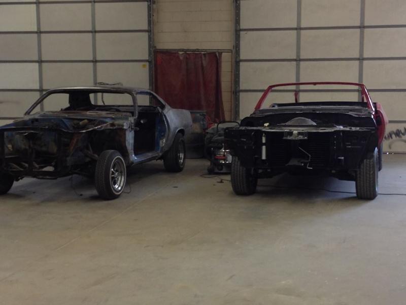

i will soon. ive been sand blasting and stripping engine bay but we have a substitute in class today so no shop time. spray some primer on that bare metal next week then ordering new trunk drop off pans

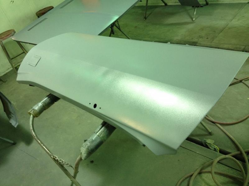

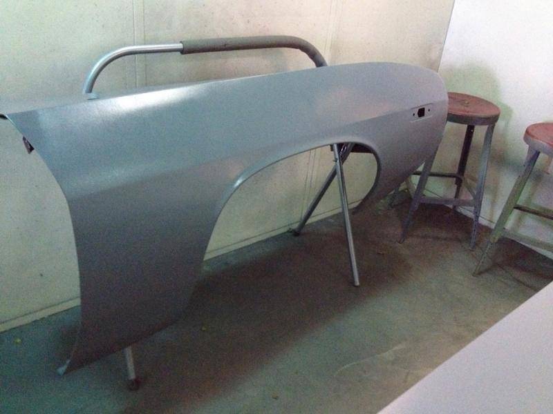

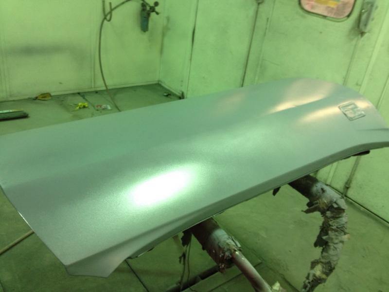

are you using etch primer or apoxy, dupont recamends veraprime etch primer for bare metal so you can do the body work over the top of it and will stick just fine and protect the metal from hand prints and moister p.s. having your cuda in shop class makes going to school fun i will bet

It makes it extremely gun exspecialy since im also getting a 100 grade average and workin on it. I have some poxy primer at hand at the shop for it. Just to spray on the bare metal to keep handprints off but i will be cutting and grinding afterward when i het my panels

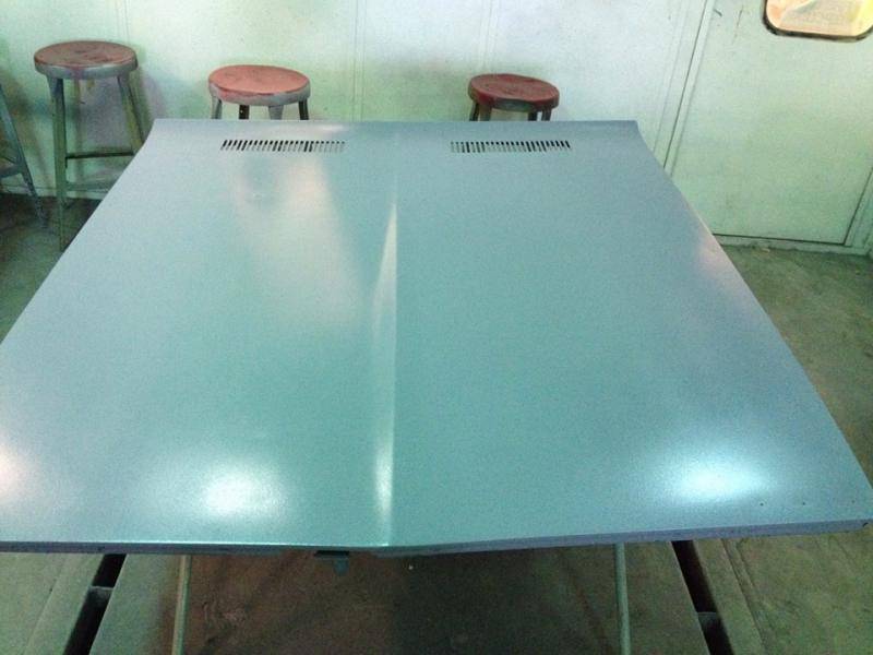

You can do your body work over apoxy primer as well. but it dose not seem to harden up completely, I found it to gum up the sandpaper plus dupont dose not offer an apoxe primer to use that way that i am aware of P.S. Are you staying with the original hood or the twin scoop hood. mopar had some of the sharpest hood's

No pictures right this moment but ive been sand blasting and hve ordered my trunk extensions. Puttin some epoxy on all the bare metal tommarow. Havnt had a lot of shop time we had a substiute and had to sit in class. Got the license plate holder and hinges painted. Stripping the rest of the engine bay and dash board this week then me and dad ganna get a little fabrication going. Building a rotisserie out of two 1000lb engine stands

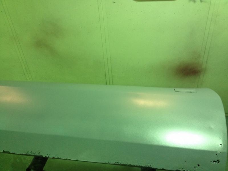

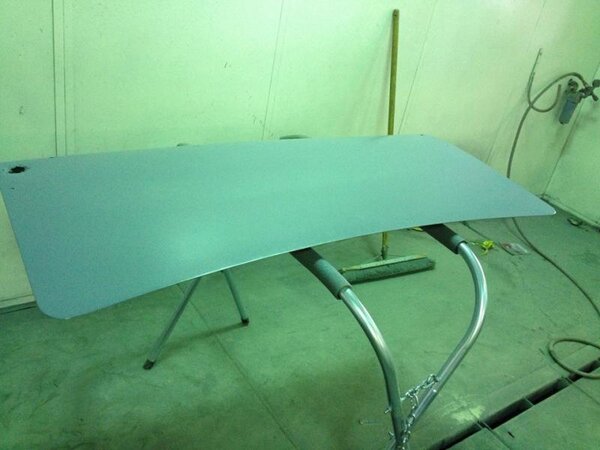

first coat of epoxy to cover up the bare metal

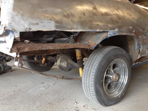

what is the game plan for the left door, new skin or cut out the rust and make patches and repair the skin
both doors have a lot of rust on the bottoms. I have a lot of scrap sheet metal and the rust stops just above the body line so I will be cutting the bottom out and using the sheet metal machine to bend it the way I want and weld it up

also there is hole in the trunk deck lid I will be cutting out a metal plug to weld in its spot then bondo it up and smooth it down
