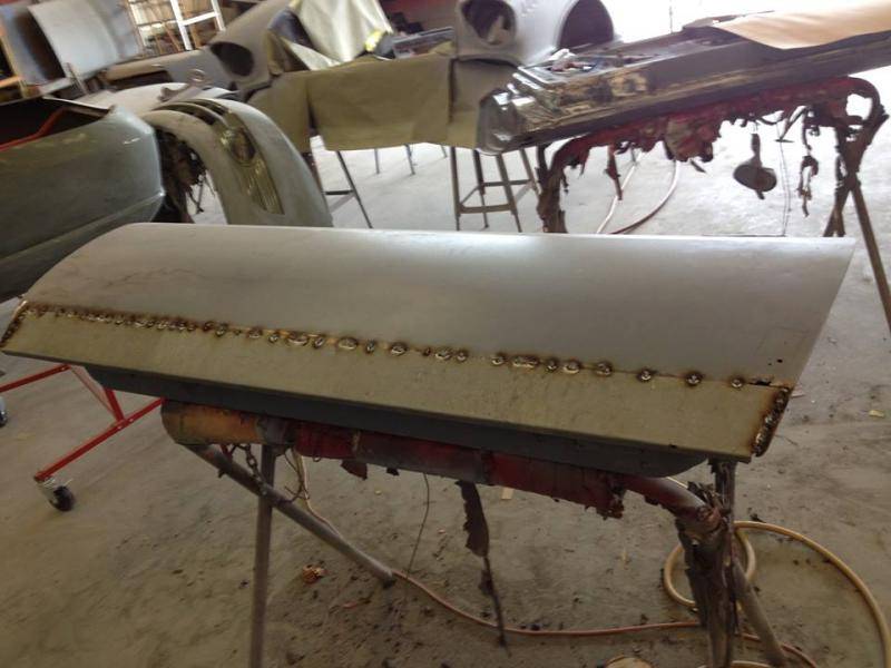

i know you have a lot of work ahead of you. i found taken your time welding small areas let it cool down weld back and forth until it's all welded in. and remember you can warp metal just as well grinding as welding. crimping makes it easyer also when the time comes to do your filler work

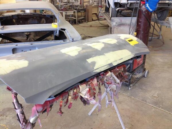

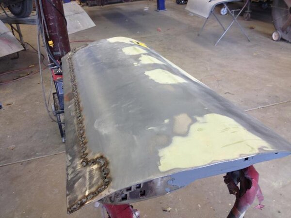

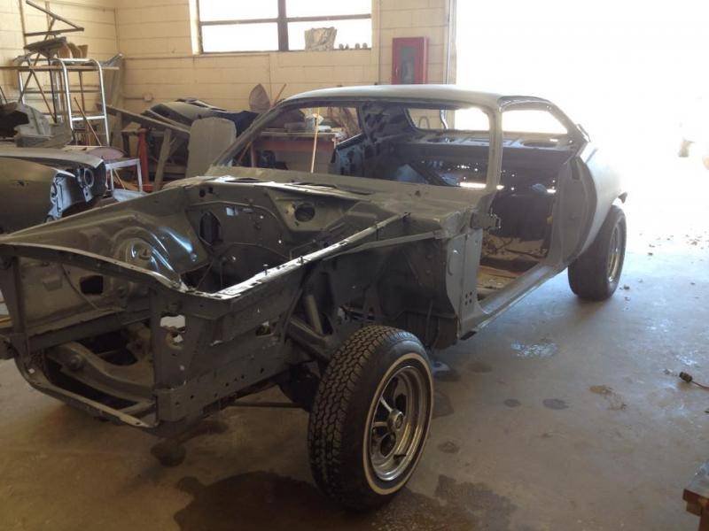

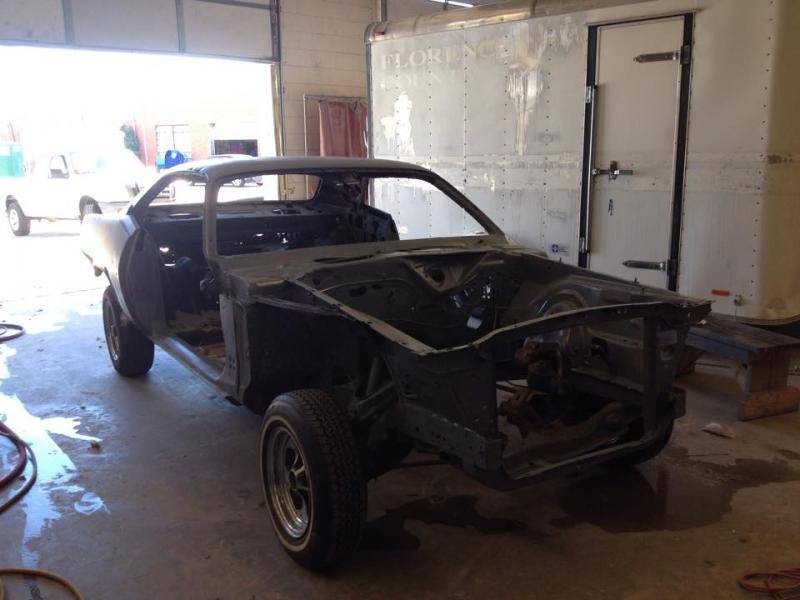

Getting the doors worked out.

ata boy looks good its nice to see real body work being done! not just repo parts being thrown at her. plus you are learning a skill i found if you seal it up good from the back side it will last for a good long time

Thanks guys really appreciate all the replies. This is my first time ever doing major body work like this. Ive actually never welded before this. i just started learning a few weeks ago. I got a really good teacher and a couple of great freinds helpin me. Im gettin a lot better at welding now. Its pretty fun.

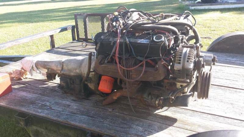

We dont exactly know yet. It came orginally with a 318 small block with an auto tranny. Dad wants the car to look and drive the sane as when he drove it. So were ganna keep the auto tranny and 318. But my grandpa has an orgianal 72 440 with 4 speed transmission and k member that ive ben begin my dad to use it but h wants the 318. Dont know about gears but they will be gone through and if it dnt have posi it will

I agree the 318 can easily make 300hp and 500 is possible. The small block is a better engine choice if you plan to drive the car a lot. If the 318 is in rough condition you will be better to move up in cudes, 340 or 360, for a complete rebuild. You will get more hp per dollar with the larger motors.
