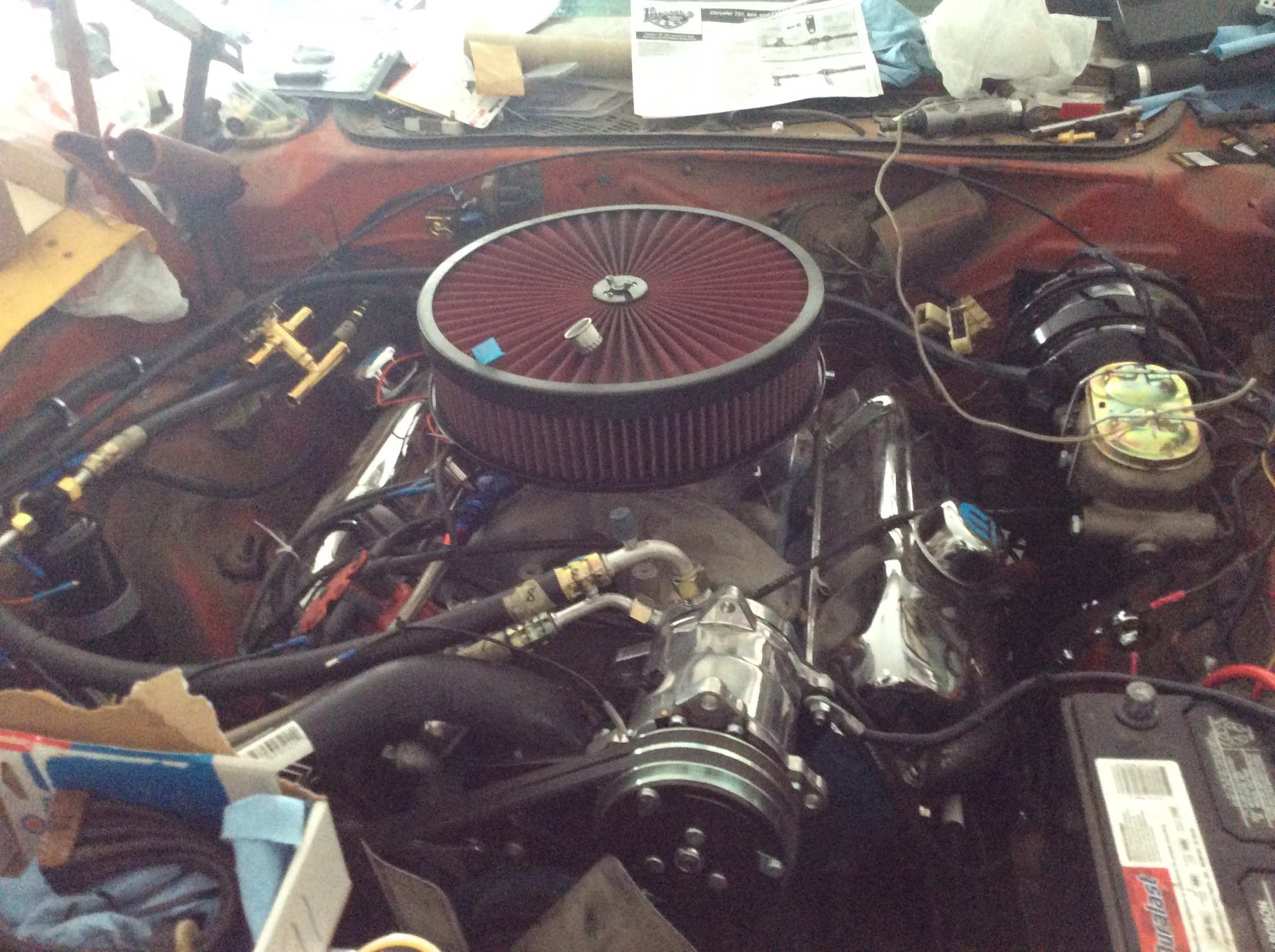

Hello everyone i’ve been a mopar fan forever. I’ve owned e and b body cars since I was 15 years old. I currently have a b body 1972 Plymouth Satellite have had this car for 13 years. Recently decided to install sniper efi having a heck of a time getting this car to perform the way it did with my 850 holley carb anyway if some one could help I would appreciate it very much

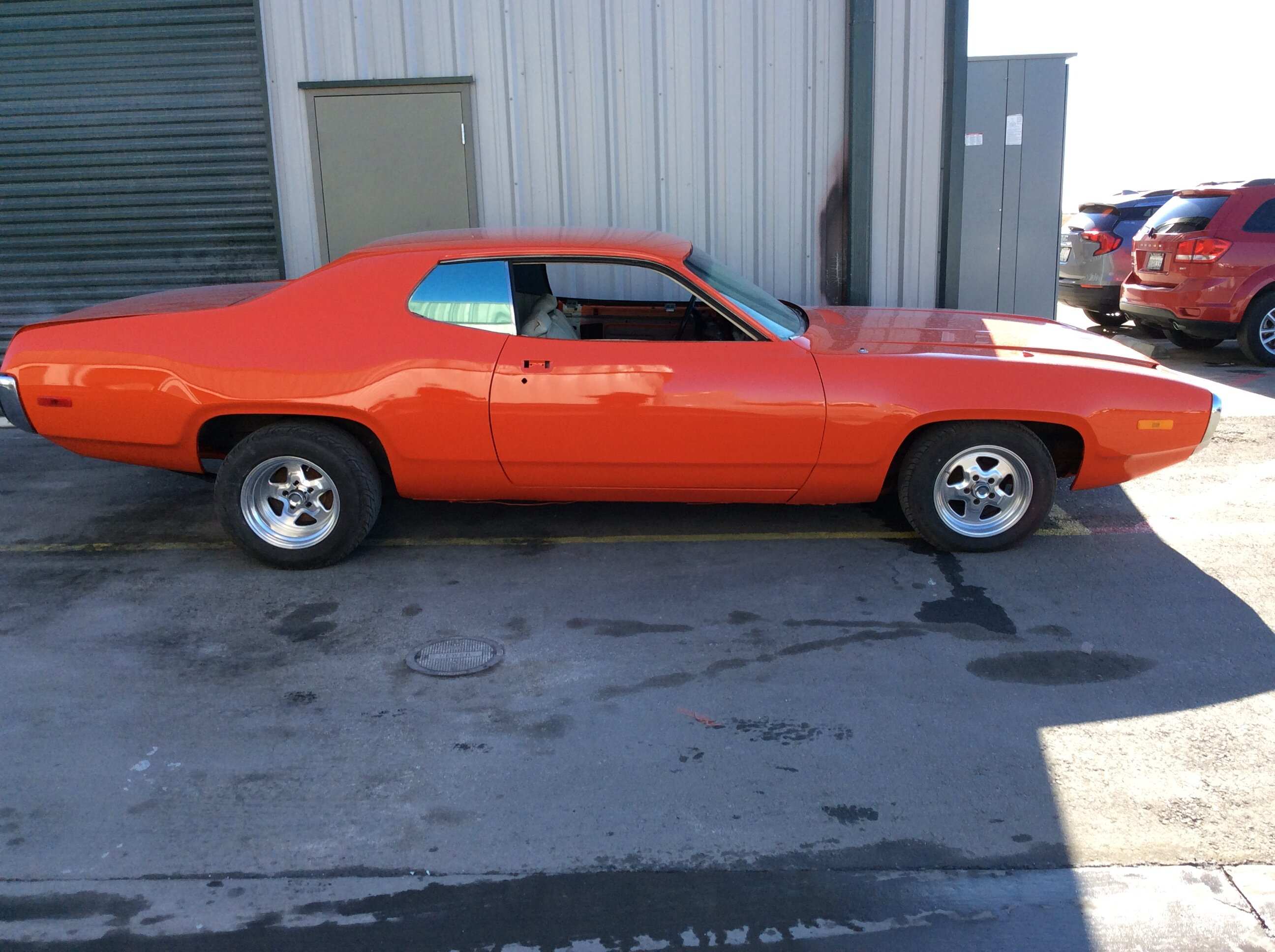

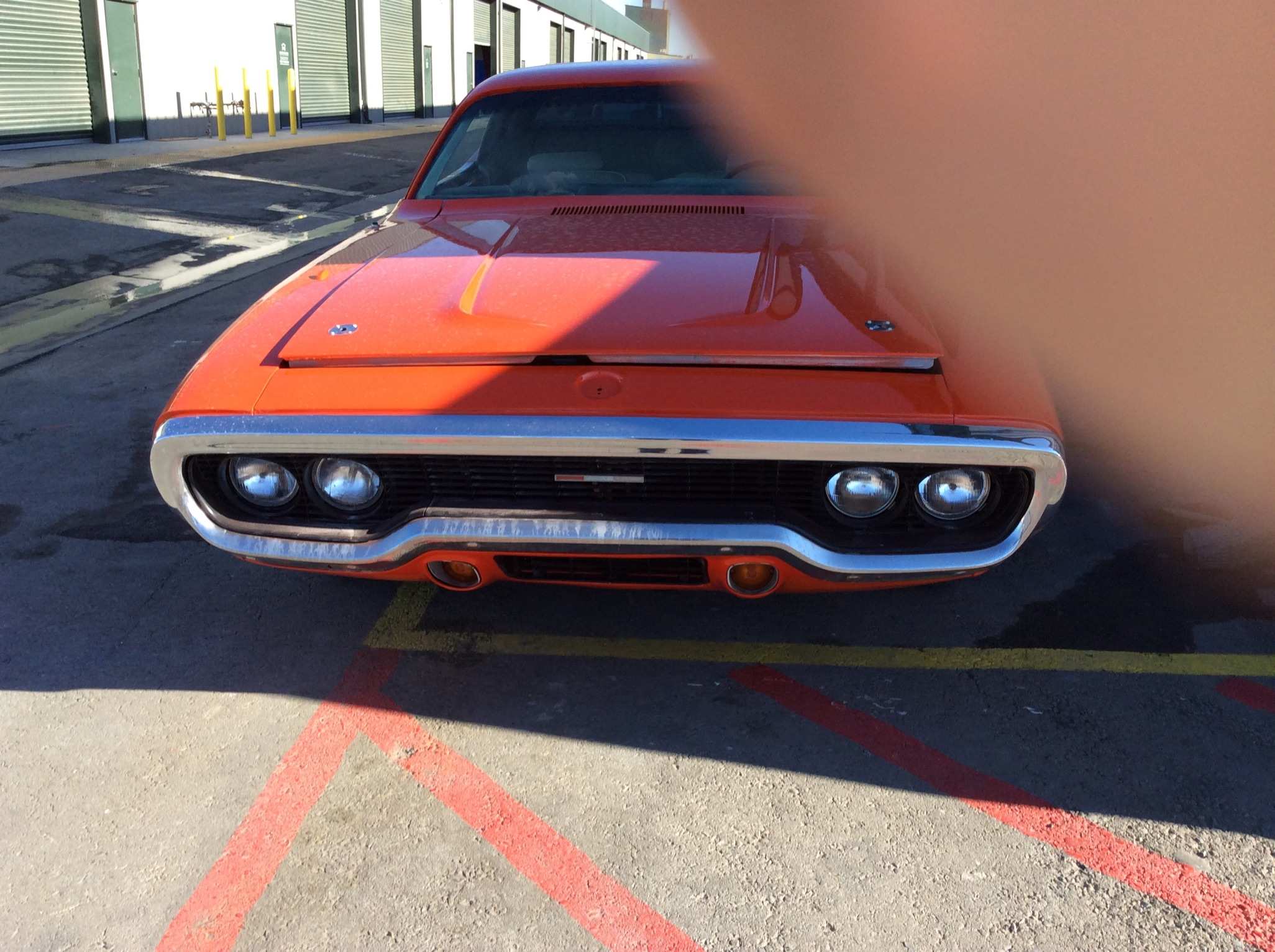

Welcome to FEBO from the desert! Got any pictures of your Satellite? There are several folks here that have Sniper EFI on their cars. Also, you might consider joining For B-Bodies Only.

Sure

Idle cr runs pretty good but dies when I drop into gear.here are my engine specs 440 bb bored .030 11:1 comp .544 comp hydraulic roller cam 452 heads that are built for this cam hooker long tube headers 727 auto 2000 stall when going into gear shifts hard did not do this with carb idle set at 950???
Steve340
Sep 19, 2016
908
339
New Zealand
I think the standard stall speed was 2300 for a high performance engine. The torque converter measured 10 3/4 inches diameter and the standard stall was 11 3/4.
That may be a part of the problem.
That could be you idle problem or to tight on the camshaft lobe separation angle.
Most EFI camshafts has at least 112 - 114 degrees.
Most Comp grinds are done at 110 which will work fine with a carburettor but you can get idle problems with the EFI.
