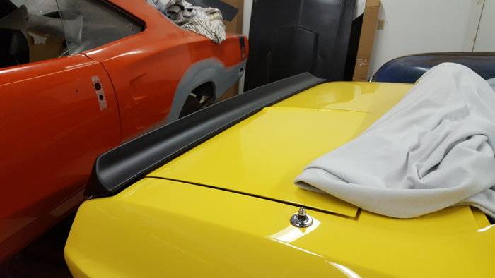

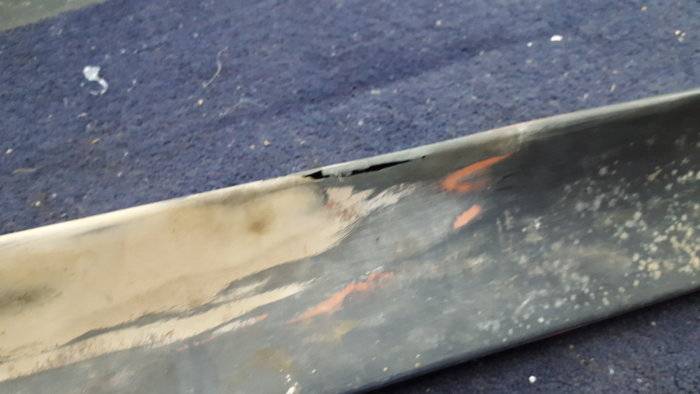

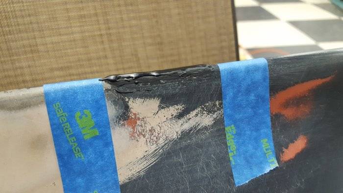

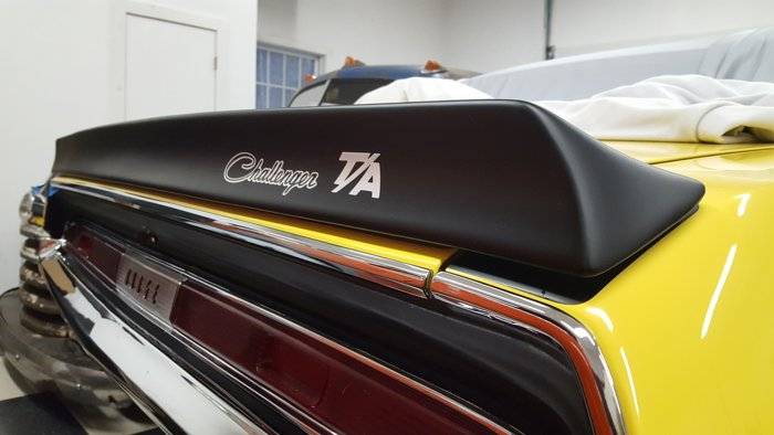

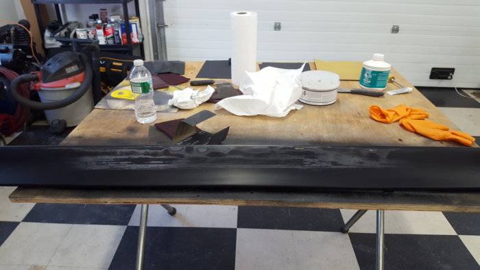

Saved another original piece. Rear spoiler - Original came with cracks, a long hole in the top and an attempted repair job.

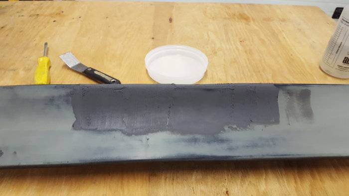

Found a product that created plastic with a 2-part process so I tried filling the hole with it...
After sanding it, I realized that whomever attempted the first repair with body filler got the contour of the spoiler and the top lip all out of proportion. Went to the auto body supply store and got this product. Then I started playing body man...
Trying to regain the proper contour...
As you see, the trunk lid is missing the correct black paint under the spoiler. That is in the process...

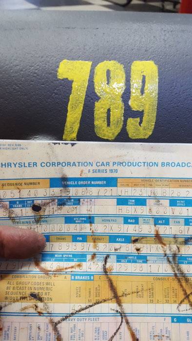

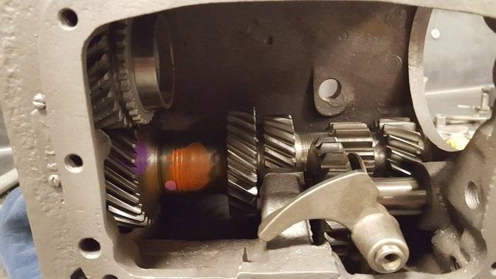

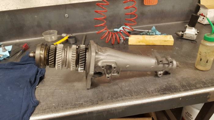

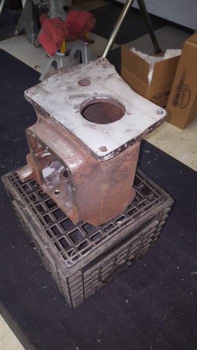

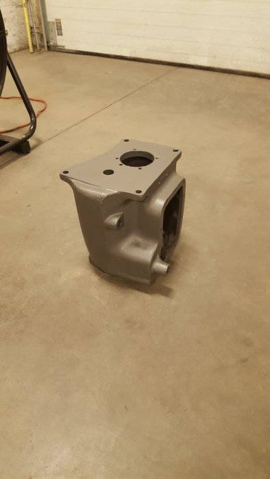

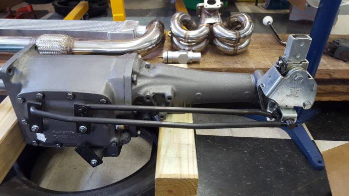

A-833 4-speed - I purchased the car as a numbers-matching vehicle and paid accordingly for it. It was bad enough when I realized that ALL of the internals to the transmission could not be found anywhere (T/A's have special gearing so not just run-of-the-mill parts here.) Then you can imagine my extreme disappointment when I found out from Jamie Passon that the main case (ya, the part with the VIN on it) was rotted on the face and couldn't be used. When he called me, he actually asked me, "How deep was the pond that my case was sitting in?!" Check out those deep pits - ugly!
WHAT. THE. F**K.. I just paid up for a #s car and now I don't have a #s trans. Sooo.... I have Jaime find me a date-code correct case and he builds me a box with all NOS T/A gears, shafts, synchros, etc that he had in stock. Mind you, I have not given up on the original trans case and after 2 years of asking, searching, etc, I find this product: Devcon Titanium putty - an amazing product that can be machined. Devcon Titanium Putty | Devcon

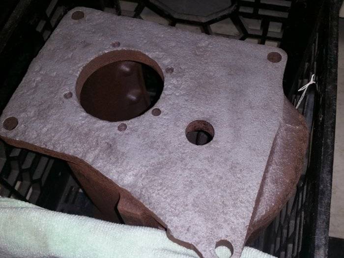

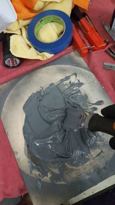

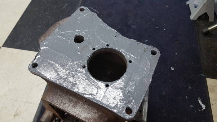

Here we go - I mixed it, filled it in heavy protecting the threaded holes, etc. I have a friend Pete up the road who is a retired machinist and hot-rodder. He has a full machine shop in his garage for personal use. After getting the exact case measurement spec from Jaime, I was able to have Pete machine it after my repair. Brought it back down to Passon where Jaime swapped the guts from the one he built into my original case. Whew.... back to a #s matching car again!
THIS, FOLKS, IS ACTUAL RESTORATION. Going the extra mile to rebuild things and search out NOS parts rather than throw **** away and buy aftermarket. I realize that sometimes aftermarket parts have to happen and as I've said before, to each their own, but my first choice regardless of time or money spent is true OEM whenever possible. This was a major achievement for me as I thought that I had just watched the value of my car go away without the #s transmission. The anger I had was very high at that point but my elation was much greater after truly restoring the original A-833 with all original NOS Mopar internals and repairing the original case...

Nice work on the auto body repair work. I have also used that titanium putty a couple times and it does do the job, not at all the same is the ol'e JB Weld Stuff. Sure glad you were able to save your original A833 case.

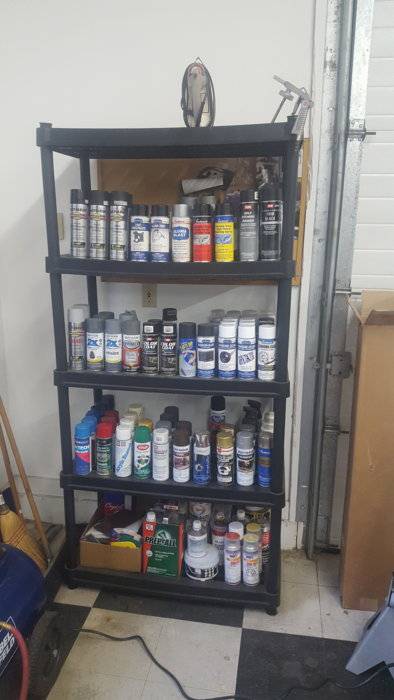

That tail light assembly turned out fantastic. I love those details (even those little but important clips). Isn't it amazing how many of those empty spray cans you end up with doing a project like this?
Thank you. I really thought it was game over until I discovered that Devcon. Sometimes you get lucky...
Thanks man. Like I stated before, I love the details and many of them I would not have known about without the proper reference materials. Spray paint?! Oh ya, we got spray paint! You are correct - amazing how much gets used...

I am so happy you took the extra mile to find a solution for the main case. Thanks for posting that link.
Funny thing is on my X I ran into an issue with the main case. It was at Brewers and I get a call saying one thrust area is worn out and the case is not usable/rebuild-able. My heart sank because it was the matching numbers case and I had the same option as you, get another, lol.....I couldn't do that and hence I spoke to Jamie at Passion and he said we should be able to build that area up and fly cut it. After several months they were able to fix that and save my case.....
In the end I wish I just sent it all to Jaime at Passion....Don't get me wrong Brewers did an awesome rebuild but leaving me no option when options are out there didn't sit well for me.....
