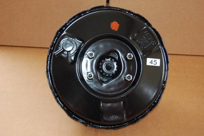

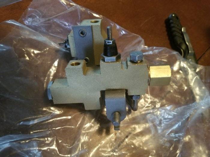

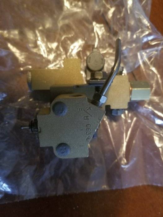

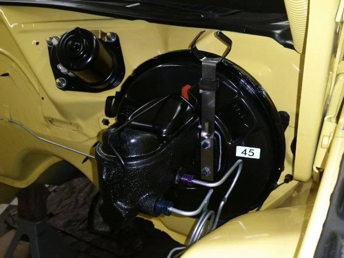

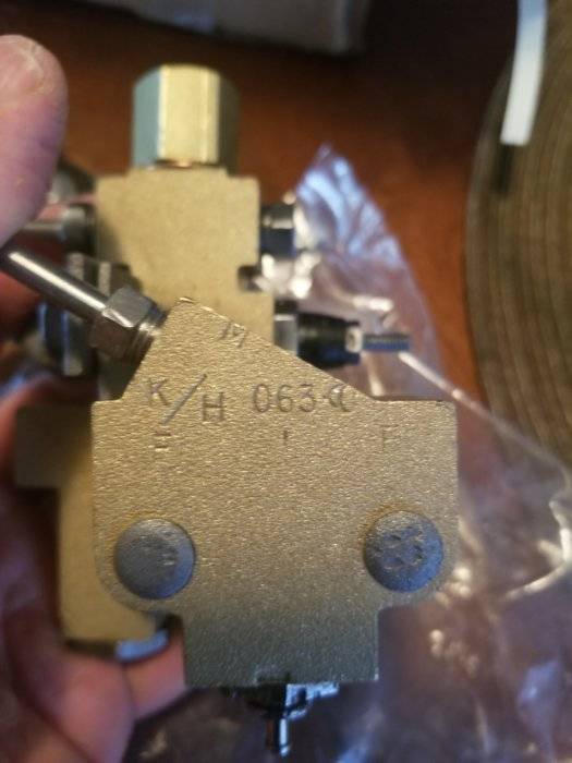

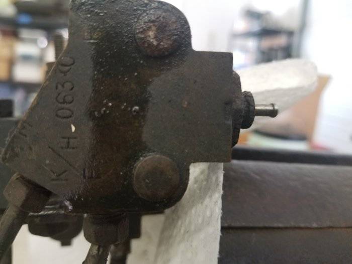

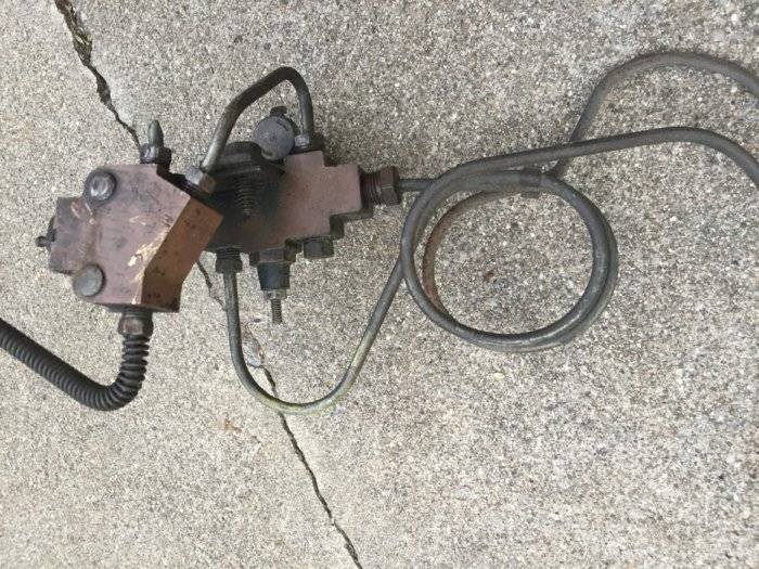

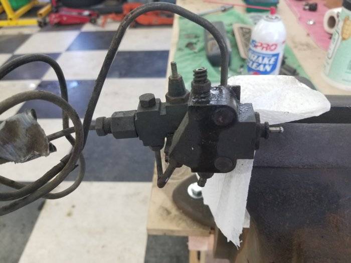

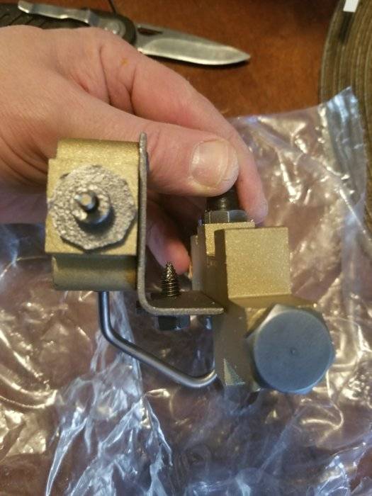

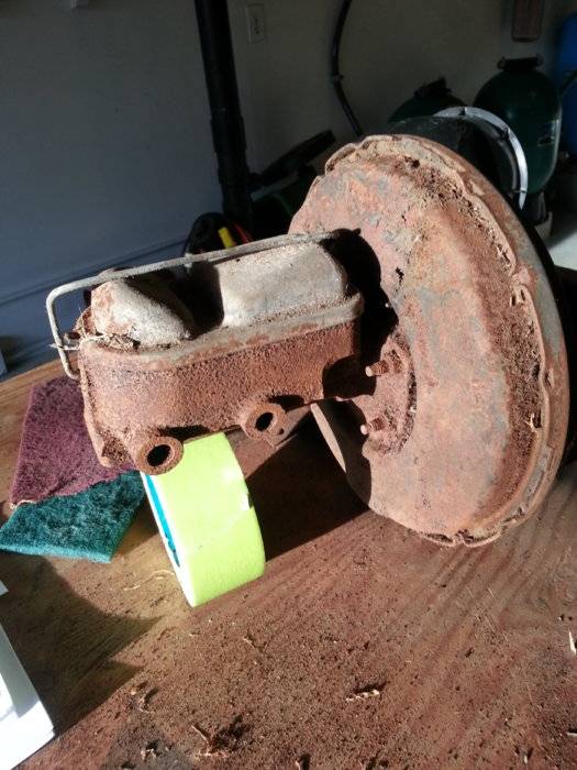

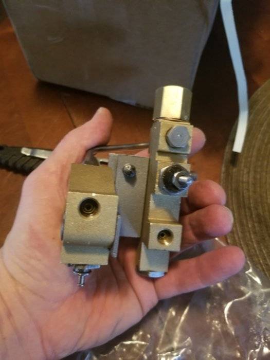

Not a whole lot to report as I still have not been able to free up enough time to get a whole day's stretch in at the garage. I had a few minutes this morning so I figured I would post my latest save. As we all know, original brake system components are usually difficult and sometimes not safe to restore. I went out of my way to restore the booster and master cylinder and I was able to save the original Kelsey-Hayes front calipers which I mentioned in earlier posts but one piece of the puzzle I was certain I would not be able to hang on to was the original proportioning valve/metering block combo. I installed a new reproduction part but saved the original, date-coded block "just in case." Well thanks to a friend and definite Mopar mentor over on FBBO (he is here on FEBO too, spying on my resto!), I was made aware of a company called Brake & Equipment Warehouse in Minnesota. They had the tools and ability to re-sleeve the 2 valves which is no easy task as the metering block has an unusual 8 sided nut that needs to be removed. And we all know how stubborn anything that hasn't moved in nearly 50 years can be. They turned it around in under 2 weeks for a very reasonable price and now, the proportioning valve and metering block that came with the car the day it left the assembly line is safely back in service. So the repop part is for spare (or sale!)

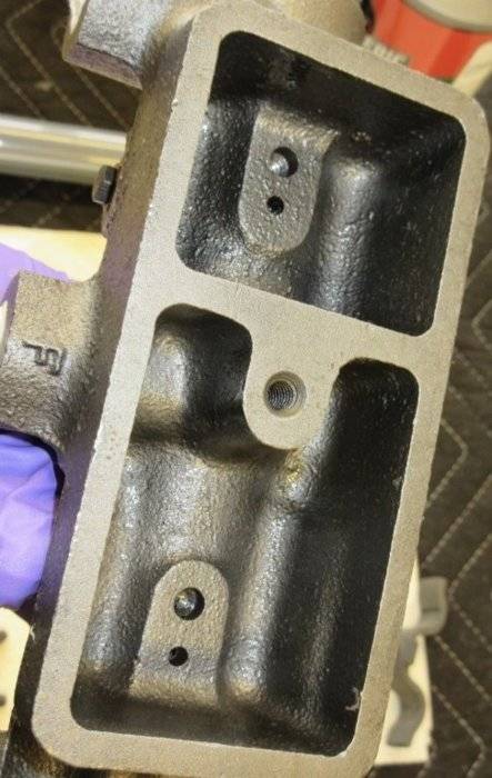

Here are the booster and master cylinder I mentioned earlier. Yes, that is the same booster as the before photo! Lots of time spent after media blasting with body filler to get it to look like that.

I'm going to contact the MN company. I've been through 2 repop brake blocks and still they still leak!! Hope they can get my originals operational.

Thank you all for your replies. Brake & Equipment Warehouse also do wheel cylinders and master cylinders along with a whole bunch of other cool stuff. Home | Brake & Equipment Warehouse It's always best when you can keep the original parts so long as they're functioning at 100% and in a safe manner. Can't mess with brakes! I will always gladly pass along any references I have either discovered myself or have been told of by others. Sharing information is the right thing to do to help perpetuate this hobby.

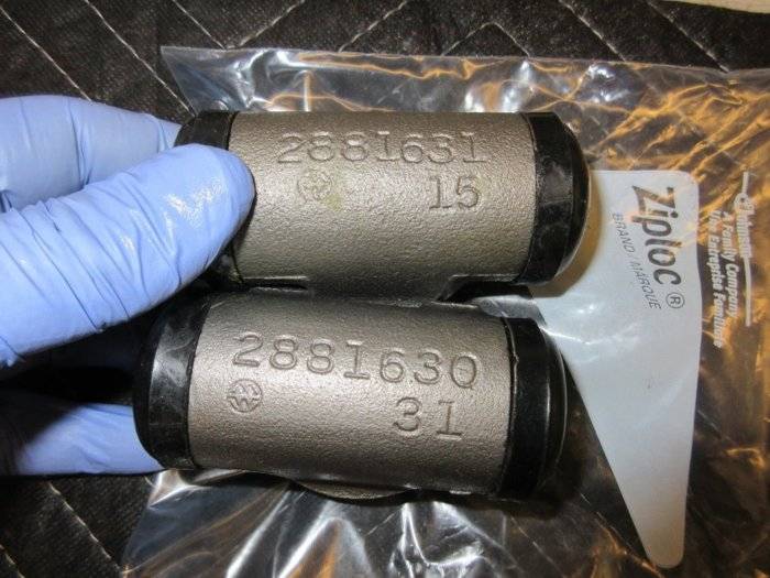

Thank you for the kind words and shout out in your wonderful thread......I knew the guys a BE warehouse would refinish a stellar part!. I had them do the MC, WC's, and prop valve.....The MC and WC's they sleeved with stainless steel. The cleaning process is amazing....Especially, on the cast iron.....They also will reline your original brake shoes.....If you find non pitted viable frames with logos, they can put new pads on them....I had a spare set done by them....
I have to say I cannot believe the is the same booster...WOW!....You have a lot of time and elbow grease vested in that part.....It looks flipping brand new....Well, done!......

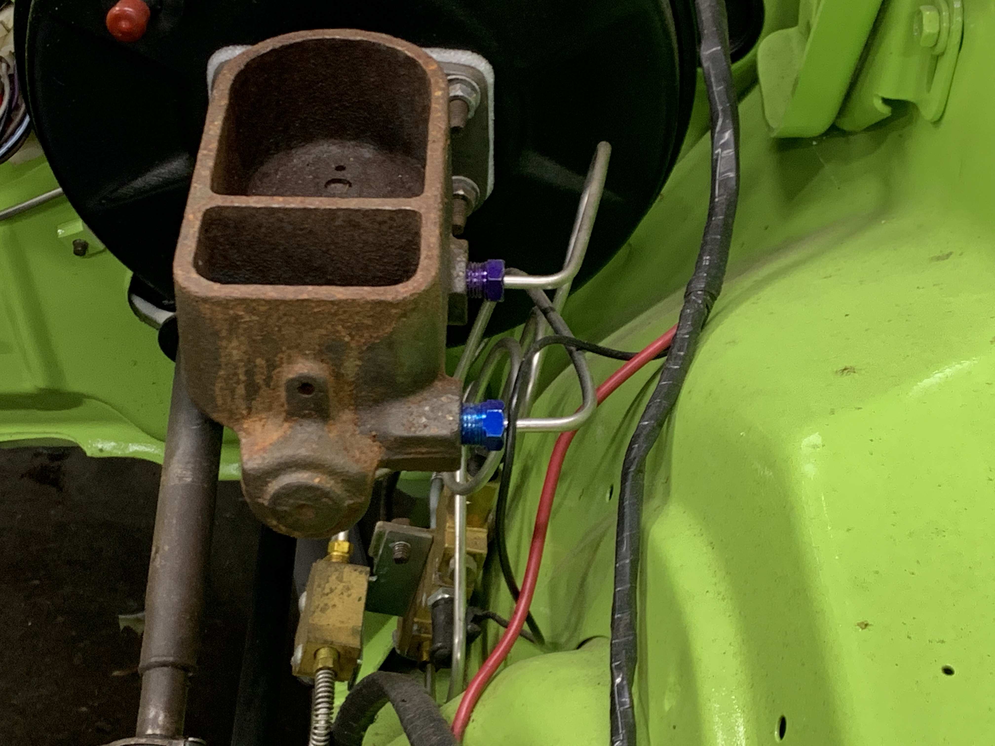

Can someone show me a photo/diagram of how the lines are supposed to be run from the master cyl. to the proportioning valve and metering block? I am having troubles with my brakes not working unless I pump the pedal every time.
340 Slapstick
Oct 1, 2021
67
27
St Louis Missouri
Yes, this helps. Affirm the fact that I did connect everything correctly but I’m still having issues with my brakes being weak and have to pump them at least once to get good pedal. I’m using brakes from ram man and they seem good enough but not getting the results I want. Also, what is that little “button “ with the black grommet around it, on the bottom of the Metering block for?
